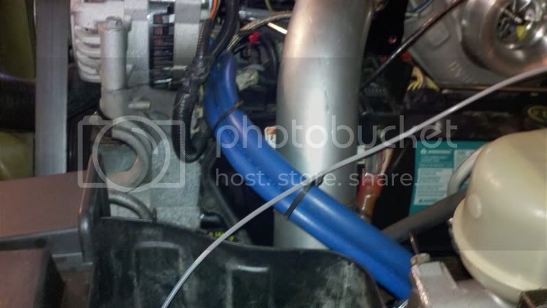

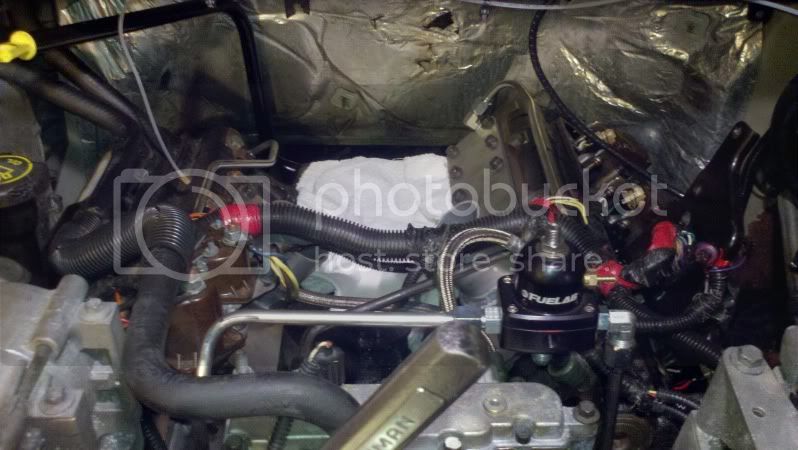

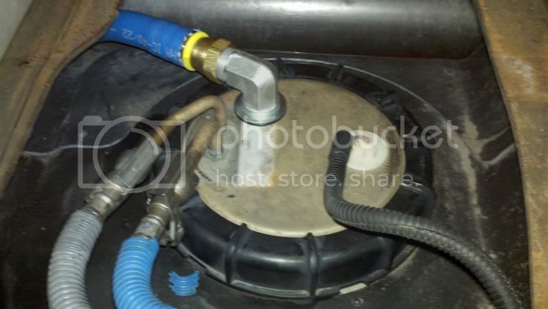

Here are some pics of his system on my sd.

SOMEONE PLEASE MOUNT THAT REGULATOR...
Hummm lets hang a regulator from two hard pipes and see how long it takes for it to shake the fittings loose or crack the fuel lines...
4.0l sahara
Dec 10, 2011
1,600
shelton,ct
I have plans to mount it but it really is pretty sturdy.
CSIPSD
5,284
Bend, OR
Its solid because its being held by the fuel line. All the weight and shaking will cause the fuel lines to crack over time.
Just not a real smart design on that part.
700
Austin, Tx
I agree with Joe. Looking at the pics, I would definitely hard mount the regulator to an HPOP rez bolt or something... Not a good idea for the regulator to be just hanging out there with all the weight and vibration stress being put on the lines.
