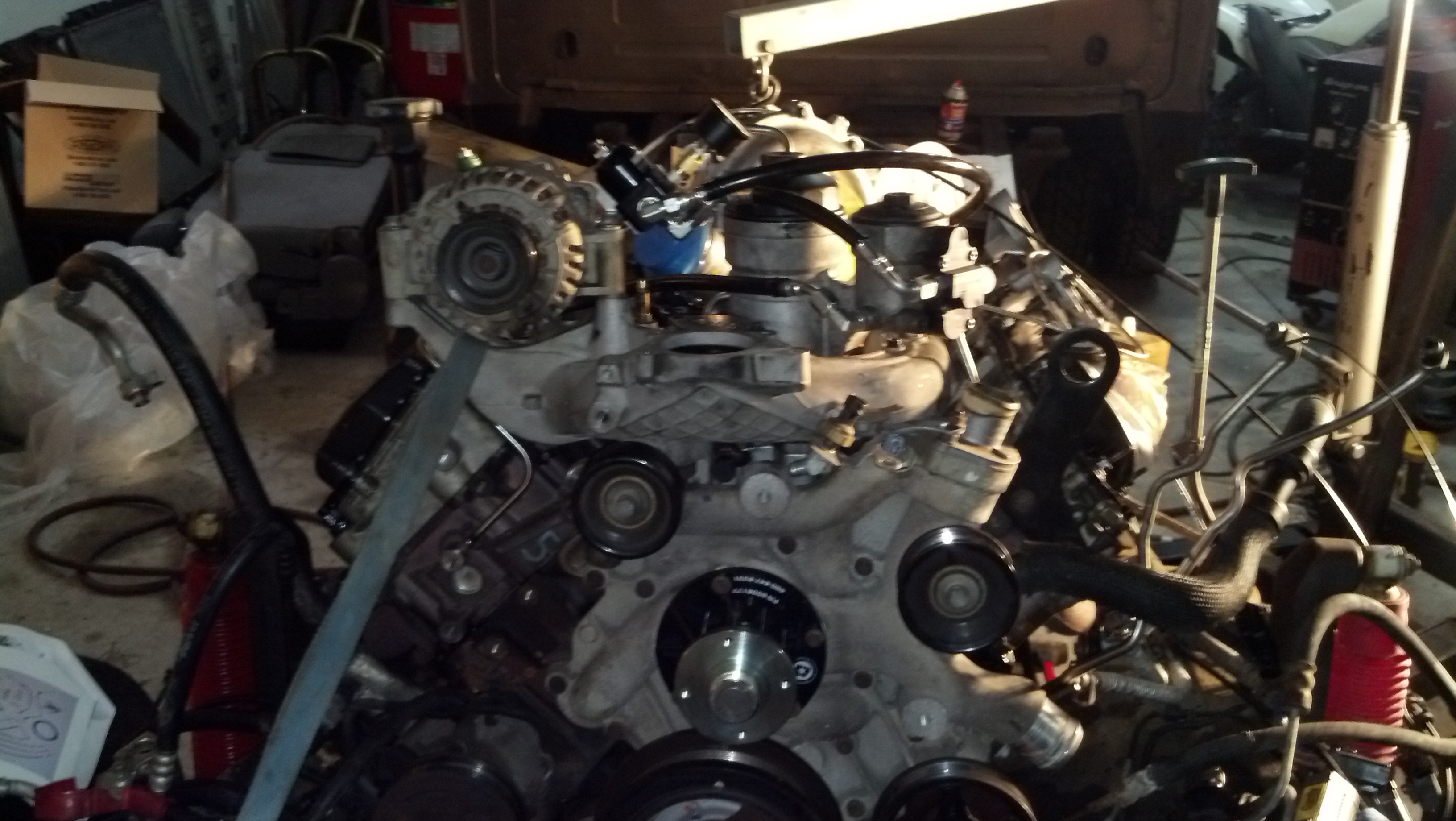

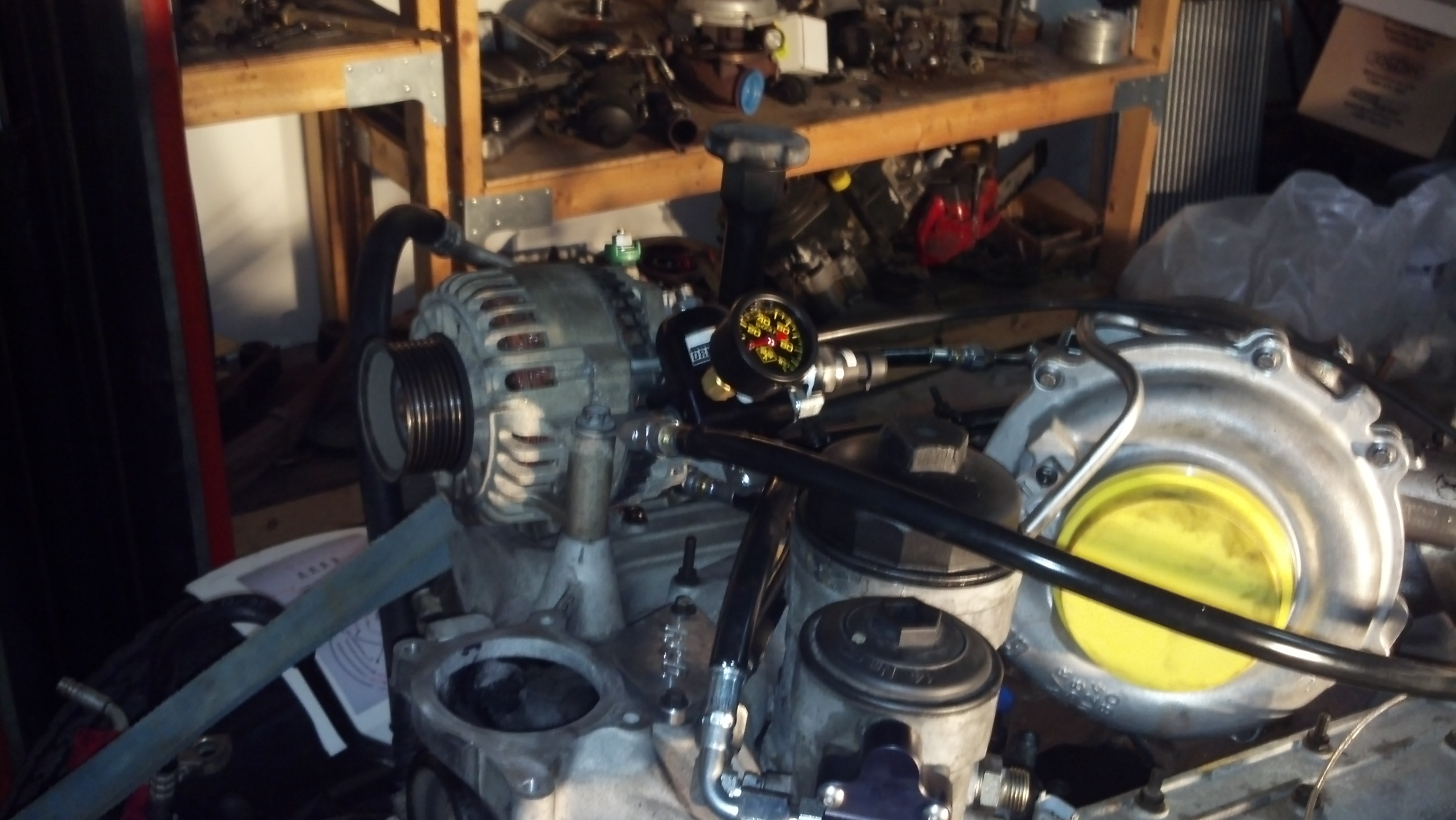

Just installed a Driven diesel kit on mine last night...quality is good as is fitment....banjos o the back would have been a bitch if I didnt have my cab off..
