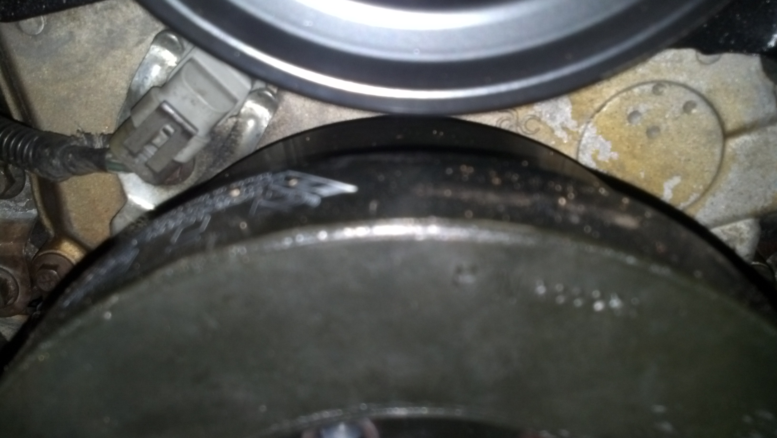

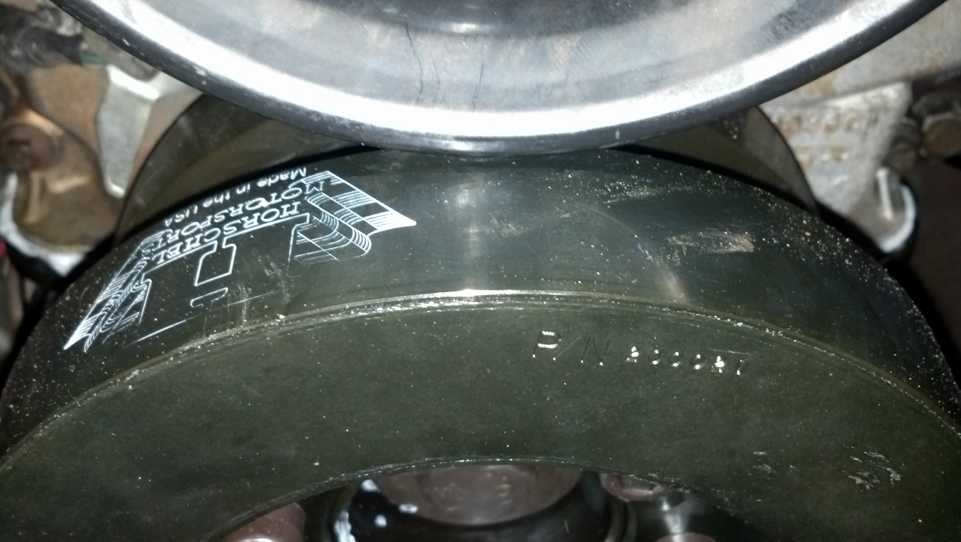

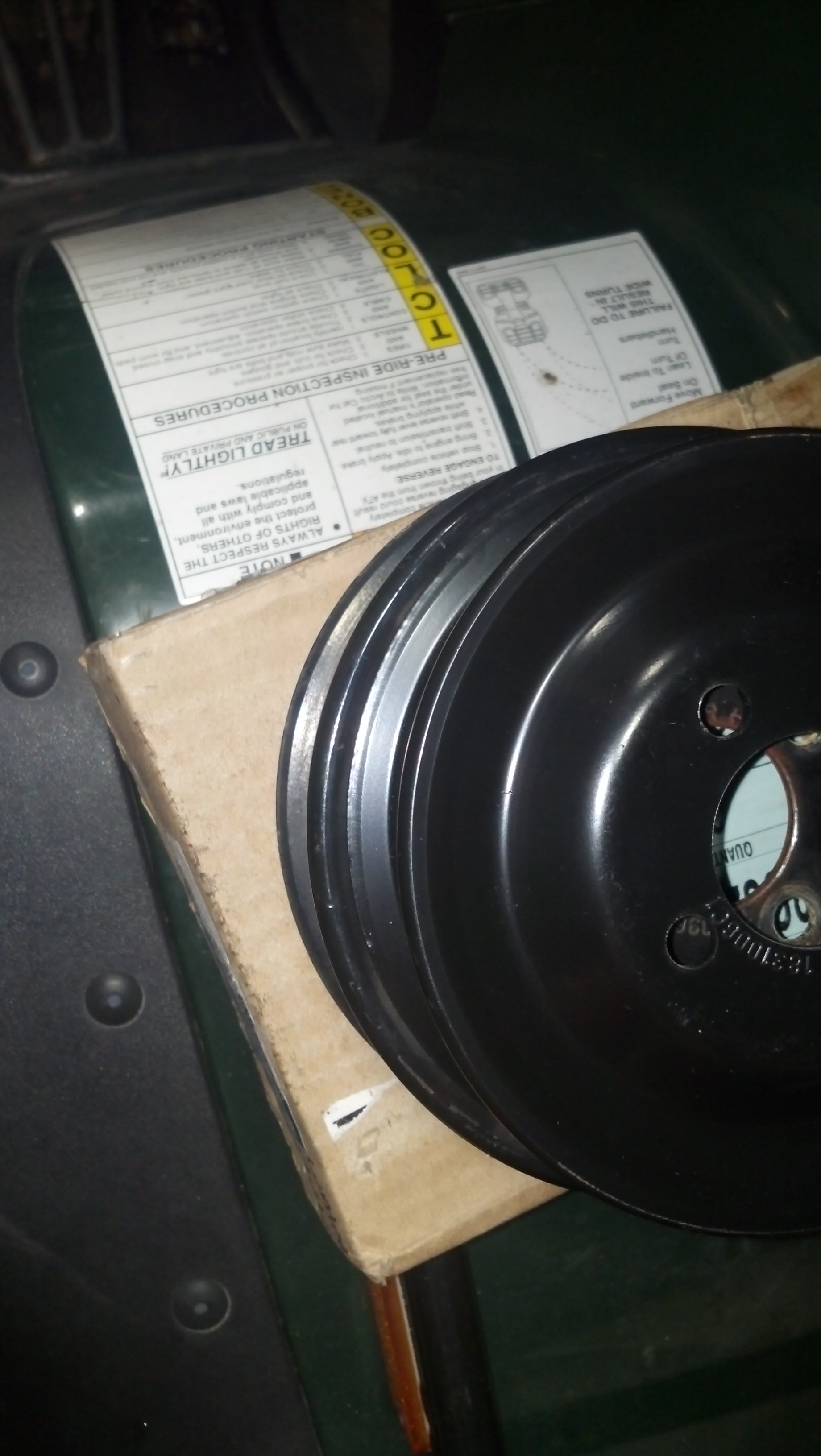

For any of the OBS guys wanting to install a Fluidampr, I highly recommend getting the SD water pump pulley. If you don't, get the belt on is a PITA. The OBS pulley is slightly larger than the SD one.
Billy T.
[email protected]
And if you run it with a 6.0 fan blade, you won't need the spacer that is included in the OBS Fluidampr kit. You can just locate a SD 7.3 Fluidampr and install the 6.0 fan blade and SD water pump pulley, update all three at once.
Rusty
Yes....exactly what I did except I had to buy my Fluidampr new.
