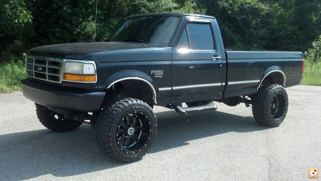

Why? I know someone that welded on new spring perches on a cab and chassis axle after he could find a pick up axle for his 250. That axle then went under cat rebels old idi, after that I think he swapped it out? Not 100% sure with all the axle swaps we did
Now that you say that, they did swap an axle at the shop.. honestly I like the 20x12 idea better now that I've thought about it.
These are 33's.. I want 35's
You can add new spring perches really easily.
3/8" wall square tubing, hole saw the same diameter as the axle tube and a welder is all you need. Leave the old perches intact and use them to align the new ones.

Yeah zac, welding spring perches on is not a big deal and done quite often. As said before, tubing and a hole saw and some one that can weld lol I would weld the axle tubes to the housing while you're there. Not like you are making enough power to twist them :p but why not

Hmm. I never gave that a second thought to weld new ones on... thanks!
Gotcha. Hmm I have a decision to make. Trying to buy a set of tires to replace the ones on the duals so I can get it back again outta ct craigslist... but then again I really want the wide stance look lol

Oh, so welding on new perches is a good idea now?
I honestly didn't believe you. I never really heard much of doing that. And with some of your comments on PSA, couldnt tell if it was sarcasm or not lol
I'm still thinking it over. Like i said. I really want the wide look as a srw and nice wheels but the dually looks good too..
