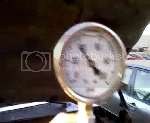

Aight so some of you may have seen my thread about fuel pressure and fuel leaks, but essentially I am just sick of fuel leaks, and I think that my stock fuel pump is on its way out. I have replaced all of the orings and fuel lines at the fuel bowl, and built a fuel pressure gauge and tested my pump. I will post up a video of my fuel pressure when I get my phone to hook up to my computer. But anyway I would love to do a full E-fuel conversion, but unfortunately I don't have the funds right now.

Here is the video of my fuel pressure idling:
[/URL]
Anybody know if this should work, or think of anything I may have missed?
