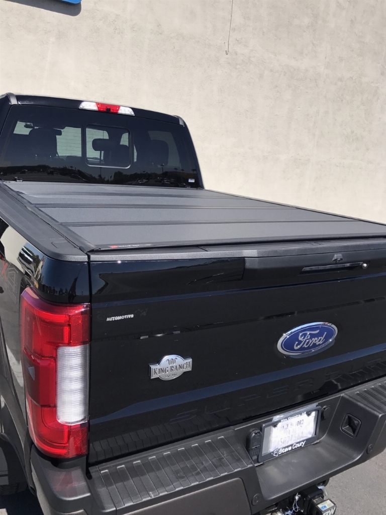

Tonneau cover installed.

I had the G2 bakflip and this Mx4 is way better. I love them simply for the fact I don't loose bed space.

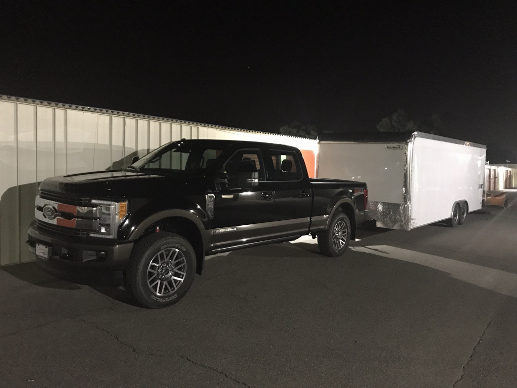

I'm sure I'm missing some stuff. Here's Thursday night after I picked it up. Truck had 70miles And was towing 10k already lol.

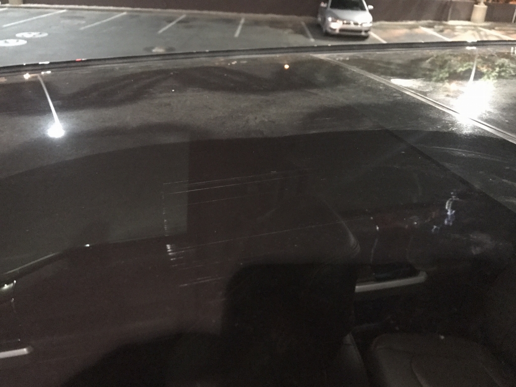

And my first scuff... luckily it'll buff out.. these trucks are SO high stock!! I barley touched the max height sign at the airport parking garage... I drove like a retard with the sunroof open popping my head out while finding a parking spot..
Getting it lowered it top priority.
More to come!
Wet sand 1500-3000 to 5000 if you please.
G3 cut compound
3M Perfect-It wax.
Guaranteed to come out if you can't really feel it with your nail. If it's very deep in the paint to primer or worse Aluminum. then it's a lost cause and will need paint

Well I didn't know I'm a licensed body man that's why I gave my input

Well.. that would work if it was on paint. These are on the glass panels. I have special compound/pads designed for glass. They'll come right out.
