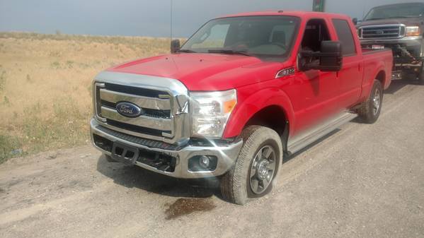

I've got a '15 lariat, and I just wrecked the front end over the weekend. I'm looking for recommendations on aftermarket parts/ upgrades. Anything I can't find that's better will just be new OE parts, but now's the time to upgrade what I can that's broken.
Stuff I gotta replace:
COMPLETE grille & mounting brackets- wanting PTM, plus get rid of the giant center bars
Complete bumper with all brackets & fog lights- thinking PTM Road armor stealth pre-runner with round light holes, but open to suggestions
All the coolers behind the grille except the primary radiator (already have a new OE unit)
The rest of it is pretty set in stone on the repair, but if any of you have a good deal on take-off parts, I'd like to know about it.

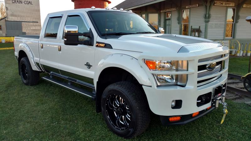

Going way up in the air you probably don't need grill protection, so maybe this one would be to your liking. Personally I think they look better w/ the valance, but this customer is not running one.
I can make you a really good deal on one.

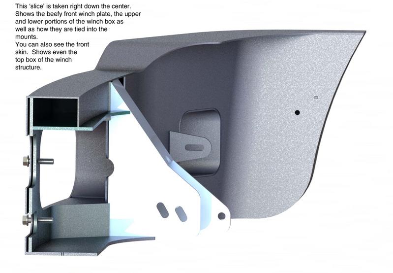

Our bumpers are extremely strong. All the skins are 11ga steel and the entire substructure (the winch box) is 1/4". The main front skin in front of the which structure is backed up by the 1/4" so you've got 3/8" thick steel.
The 'Stealth' model is about 155lbs according to my idiot child the computer.
Here's some slices that I rendered for you which ought to tell the story better than I can in words.
Complete backside
Front of it rendered

It's a pity these didn't sell like crazy. I wish I needed a bumper like that. Only one I'd ever buy.

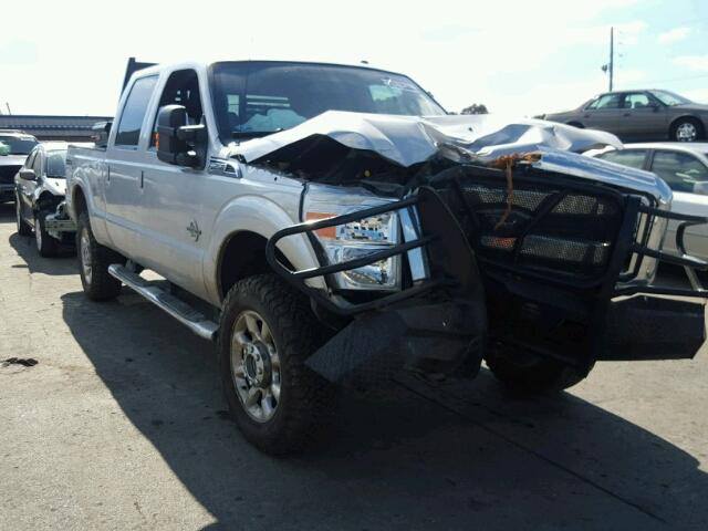

If you live anywhere there's deer you 'need' this bumper.
Always amazes me though, people freak out on the price, but drop $5k in tires/wheels and $8k in a turbo & pipes to fry the tires.
I guess it's because Ranch Hands are so cheap.

That must have been a huge deer........
