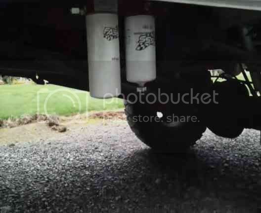

Right I hear you on saving your injectors. Dont blame you one little bit. I just bought a FASS and I love it so far. Great fuel mileage and the air seperation. However the FASS pump is so loud! I mean loud! If I were you I would look into jakes system at Irate diesel have buddy that has his system and I really like it. Wish I would of known about it before I bought the FASS. But then again his system does not seperate air. If you are set on the FASS or an AirDog II then I would recomend the AirDog II simply becasue they are alot quieter. If I can figure out how to up load videos on here I will record my FASS system and how loud it is sooner then later. Hope this helps you out.:thumbup:

I got 3mpg better from having the FASS on!!!! Not sure about the AIRDOG II tho.
Stay tuned I have a buddy posting a video of the FASS runing on my truck. He said he will post it under this thread I believe.

Sep 9, 2011
880
Oregon
here ya go
