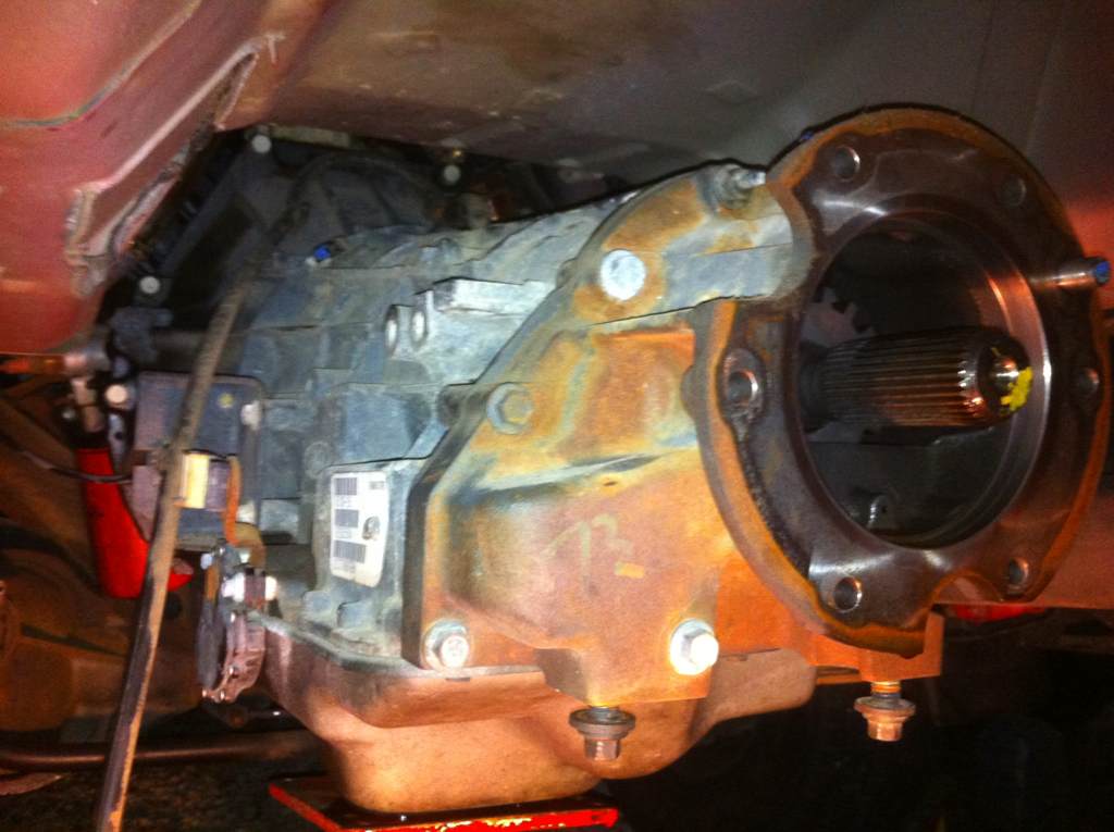

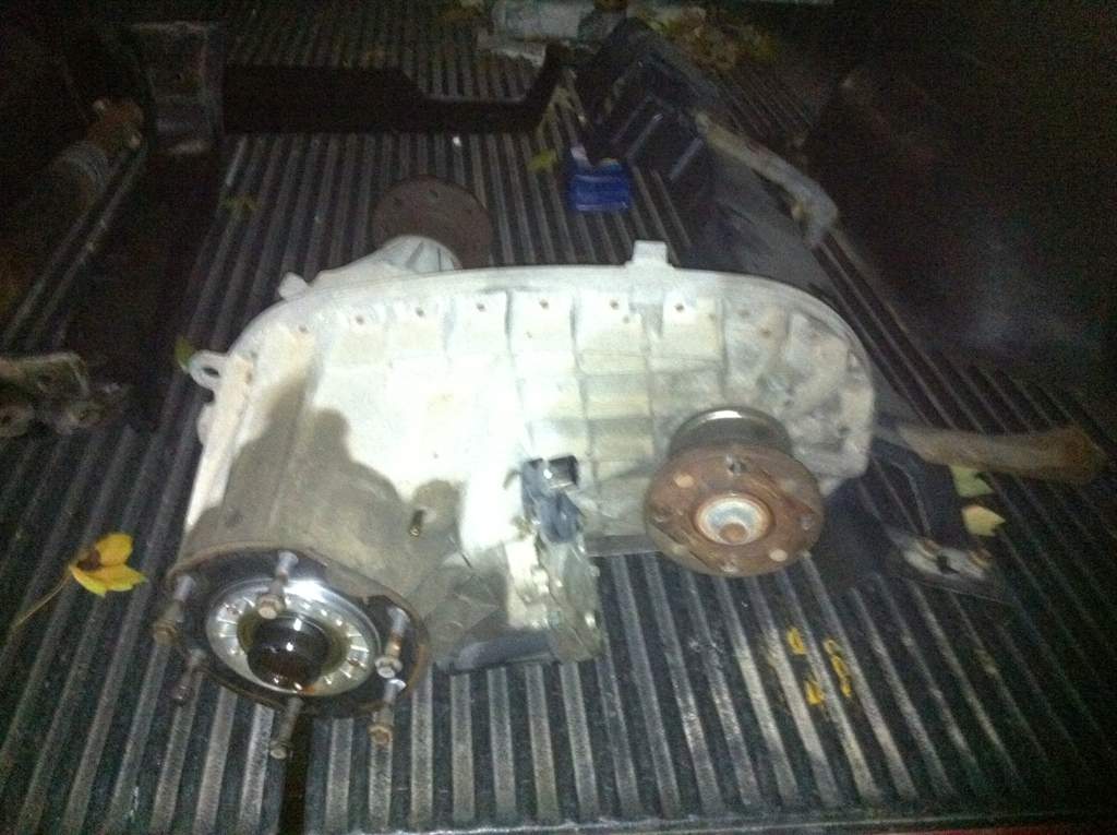

Pull drive shafts out of way, unhook electrical, unbolt cross member and use jack to lift t case/tranny/engine to aid in removal of cross member. Yank out t case.
Was roomy under the truck after you started tossing parts in bed

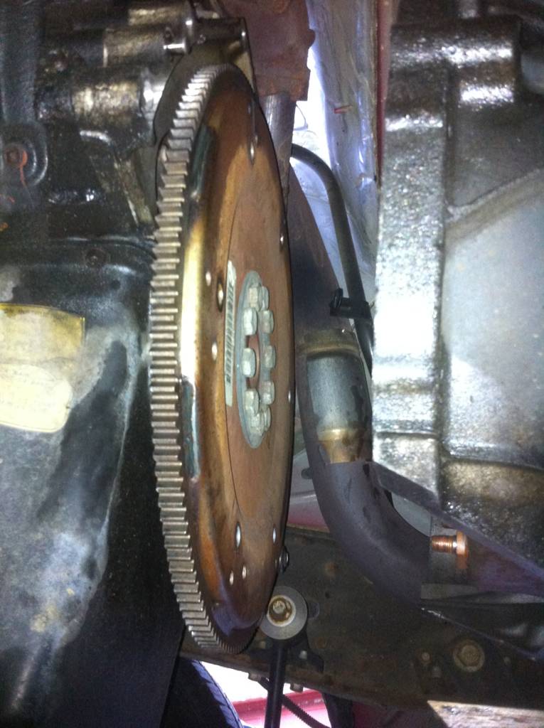

I worked flywheel in gear teeth to unbolt the TC. Unhooked fluid cooler lines and electrical. Made notes and scores of how shift cable attached. Unbolted from engine and slid back.

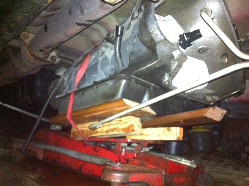

Here is a big NO. Do not rig it on the jack like I did. DUMB! Once the wood got drenched in fluid they would shoot out like soap if you looked at it wrong. The pan really sucks and the jack was a bare flat plate. It ended up doing a rollover trick off the jack but in slow motion and luckily didn't hurt anything. What more can I saw I f*cked up. Anyway notice towels plastic and tape. Keep exposed internals covered and clean! Tape off lines, vents, dipstick tube also

do not forget to check the engine side of the converter for cracks! it is common if overheated at low speeds due to converter slippage to crack the coverter.
