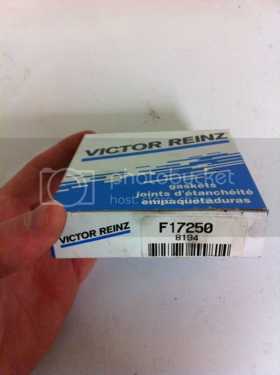

The ones Riffraff sells are Fel-Pro 8194. They are not Ford OEM. They were actually for older Chevy 350's and the like.
These are the better ones. They are a graphite like material that will crush a lot easier.

get the Victor Reinz ones like Justin posted.....
just a couple things....pick up ALL new bolts - nuts...and a can of never seize.....
never sieze the bolts, nuts, flanges, AND the doughnuts completely, even inside the donuts and flanges...Everywhere.....
thatway, when you go to pull them up tight, you can get them tight, because not only will you be able to crank on those new bolts, thing swill Slip together better.....
after you think you get them tight, take a 2 lb hammer and beat the crap outta everything, and tighten them again, Twice....
then take it for a ride, get it hot, and do it all over again....
then they will stay about as good as it's gonna get....
