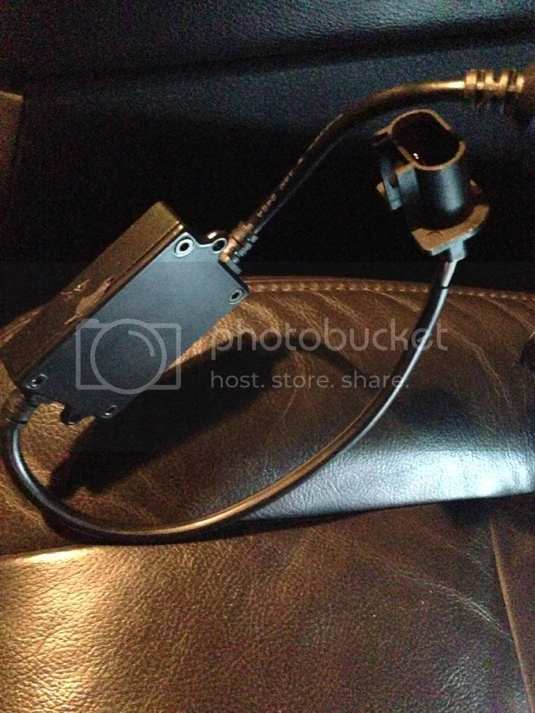

connect the driver box to the actual bulb which is super easy and only fits one way, then plug the driver box into existing wiring harness and twist bulb into factory housing and apply double sided tape to location of your choice to mount the drive box, and install the 4 bolts to re attach headlight housings and one side is done, repeat for the other side and enjoy your new lights.

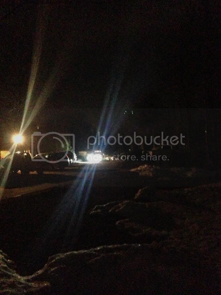

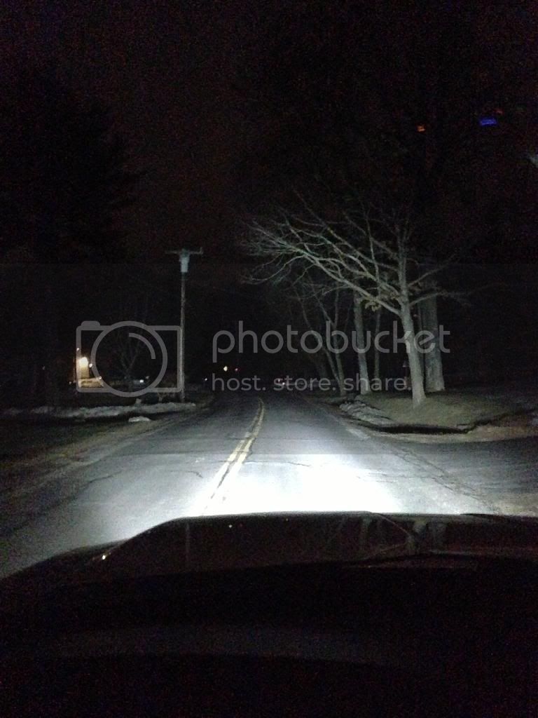

stock head lights.
Led head lights only.
that's a little over 100' away with both the rigid dually led fog lights on and the led head lights on...
head lights
both
overall they are bright, and match the fog lights very well, much better then the stock head lights.

Hows the reliability of the module that comes with it? That was always the biggest issue with my HIDs was the start up of the ballast when its cold.
1,759
South Florida
Well HID require a lot of voltage to start and get the ballast going. LED as we know draws next to nothing so I think these "ballast" are just regulating voltage. Should be much less of an issue.
they work down to -40 the box that comes with them is an led driver. they use almost no power. 28w each maybe? the only thing i noticed that was different was when you turn the high beams on its not much brighter, but the low beams are already 2200 lumen, and when i turn my fog lights on it extremely bright so there is no need for a high beam really.
