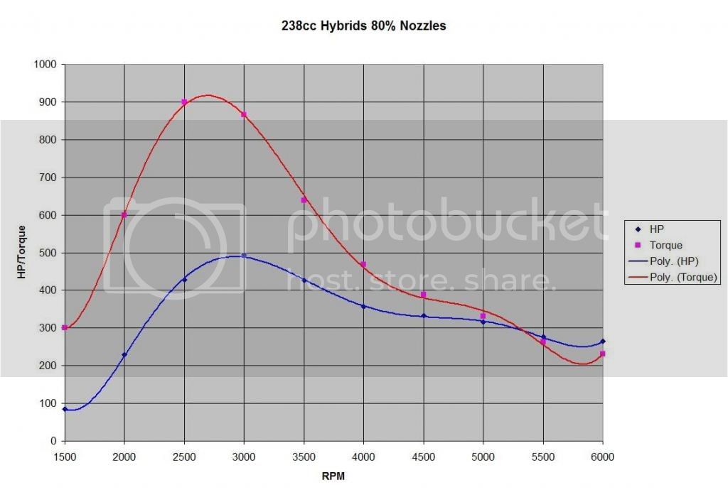

First lets take a look at some 238cc Hybrid injectors with 80% tips. Here is a 3d graph that I generated from flow data collected on a typical set of these injectors:
You can tell that the fuel quantity maxes out as ICP and PW maximize. Nothing particularly spectacular about that. But I then took this data and overlapped that with the FDCS capabilities of the 7.3L PSD. Then I removed some of the high fueling down low on a WOT run and used that information on fuel quantities to generate HP and Torque curve capabilities. This doesn’t take into account any other limitations other than fuel, and can be shifted around by tweaking parameters. Not here to argue the numbers, just show the concepts that the graphs represent.
Looks pretty much exactly like a “typical” hybrid dyno graph except it goes to 6K RPMs right? I ran it out to 6K RPMs to help illustrate our current fueling capabilities and further my point. Notice that the graph peaks at about 2800 RPMs? Pretty familiar huh? By the time you pull enough torque out down low to make your motor live, you will never empty an off the shelf 238cc injector. You can add more power capabilities in down low by adding in more PW below this, but this also ups the torque curve which one of the reasons we all need all these fancy billet rods and junk…..
Compare those HP and TQ curves with many dyno graphs of a PSD with hybrids and you should find them pretty close in concept and shape. Probably similar peak numbers in some instances, a little low for others a little high for the rest.

Now – Take this information and run it through the same process I ran the hybrid data through….
HP and TQ curve:
NOW I’m not here claiming any HP numbers, but this is what the data says. I limited the torque to 1200ft-lbs to show something that might be possible to make live. Note that even doing these limitations the peak of the HP line happens roughly 1000 RPMs higher. The limitations to peak HP are occurring because we passed the point where the max quantity of fuel can be injected. Faster injectors have helped move the curves farther up the RPM band, but they are not fast enough to move the peak any farther up. As the technology continues we will be able to move that peak even farther up the RPM band.
