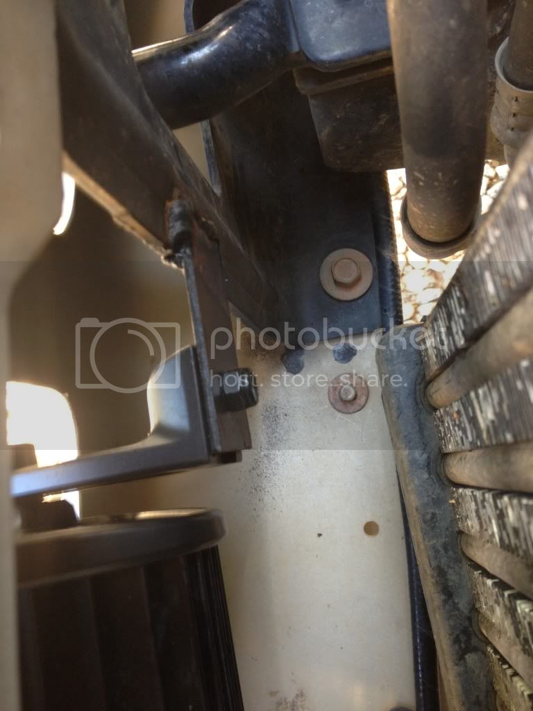

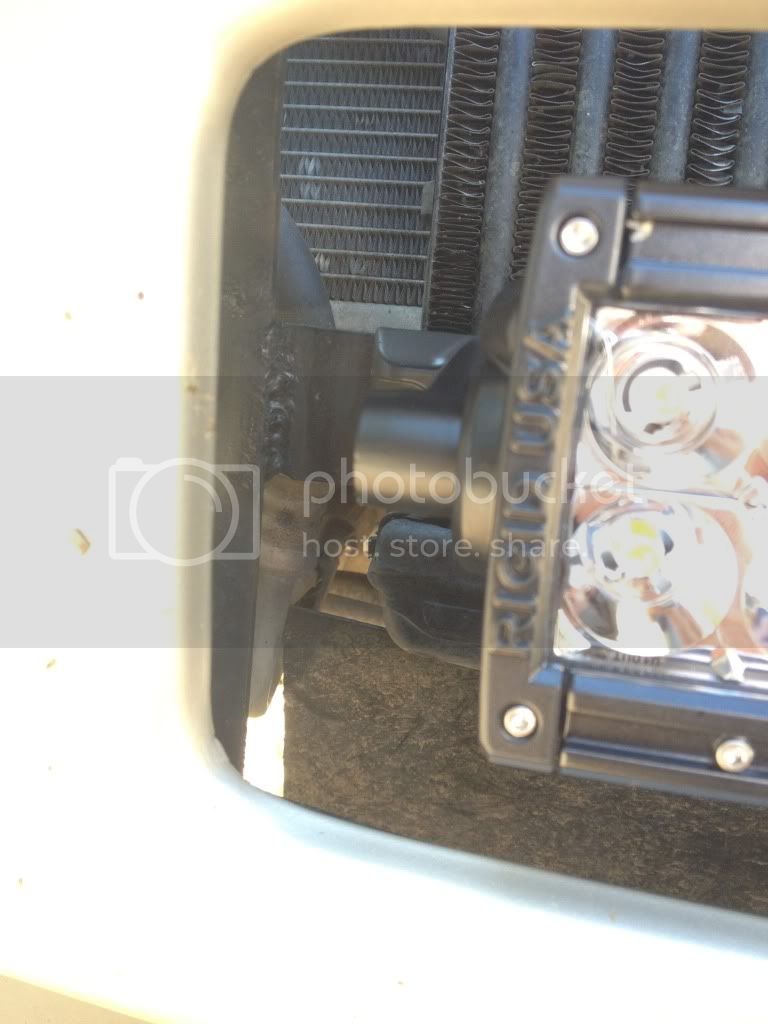

Here is how I did mine. Perfectly centering in the opening. Just used some metal I had laying around.

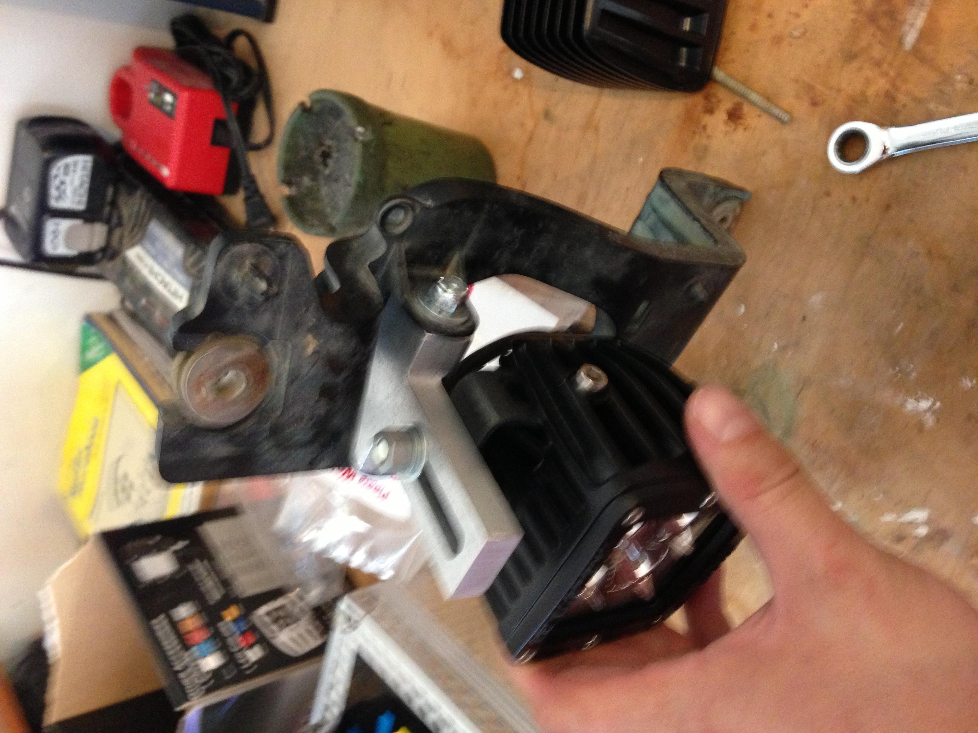

Yeah. Something has to be fabbed up to make it work.
A nice thing about the fog lights is that they can be wired directly into the existing wire harness. No need to use the supplied switch and leads. Just cut the factory connection off and splice it to the rigid connection. Dead simple.

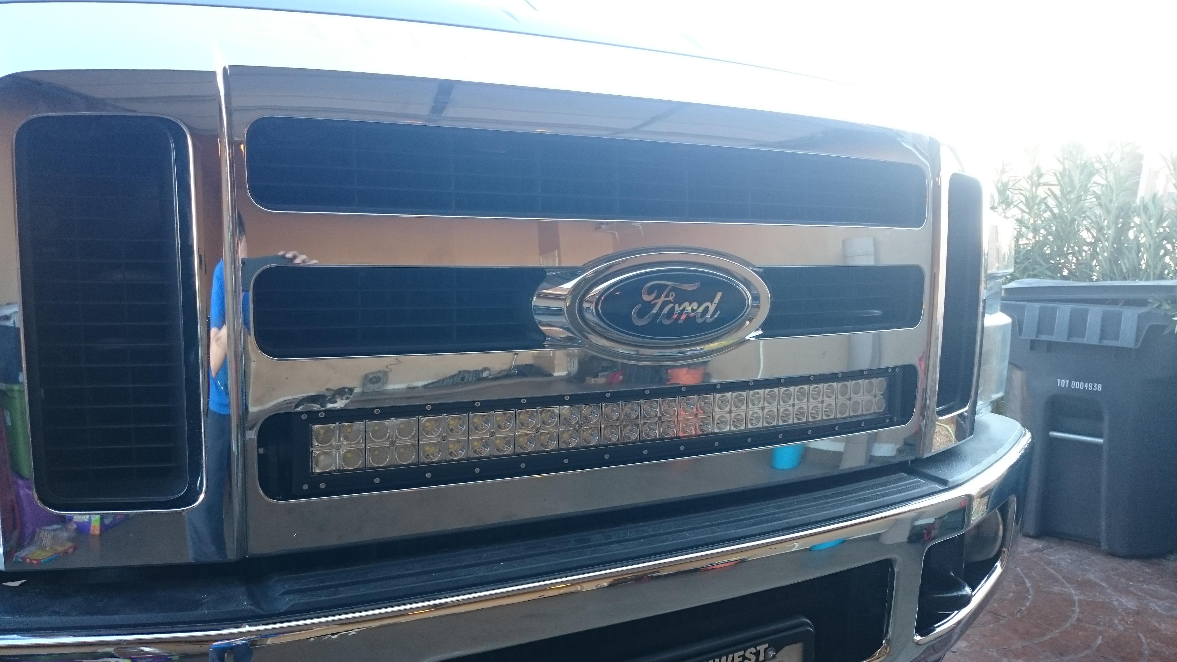

33" in grill (copied idea from another owner on this forum)
This was a project but end result was worth it..

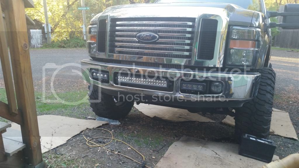

They have a pretty good focal point.
But they are way to bright for on coming traffic.
That's why I have the spots and the bar wired to a solenoid.
I give power to solenoid via #1 up lifter switch.....that solenoid is tied into the hi beam wire to the headlights that acts as the trigger for the solenoid.
All that means is when the up lifter switch is on the bar and spots turn on and off with the factory high beams
