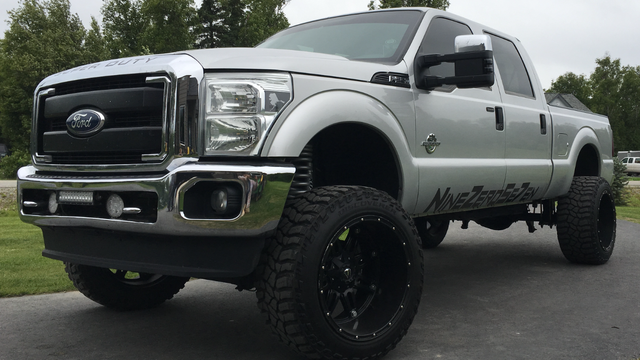

Couldn’t be happier with the cognito 4” fox shock lift kit.
For the $, I found it to be a bargain.
I just looked them up seems like a nice kit, can you post some pics of your truck with the lift? also what size wheel and tire combo did you run on your truck?
