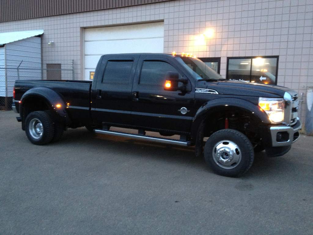

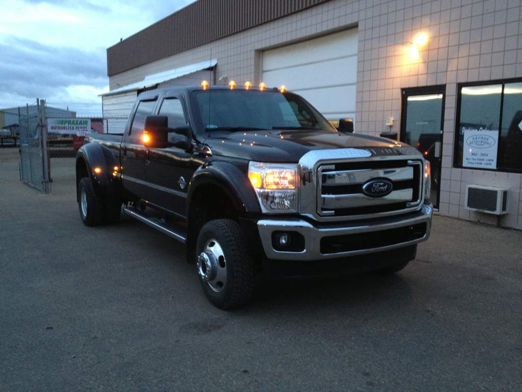

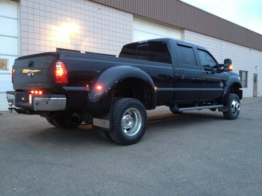

I installed my readylift sst kit today. 3 1/2" in front 3" in rear. Ended up using the 5" blocks in the rear, just had to buy 1 1/4" longer u-bolts than the ones in the kit. Everything else worked just fine. Rear shocks are barely long enough but they will top out before any abs or brake lines rip out. I like the way it sits now, I just need some AF 22.5's now. In the spring I think!

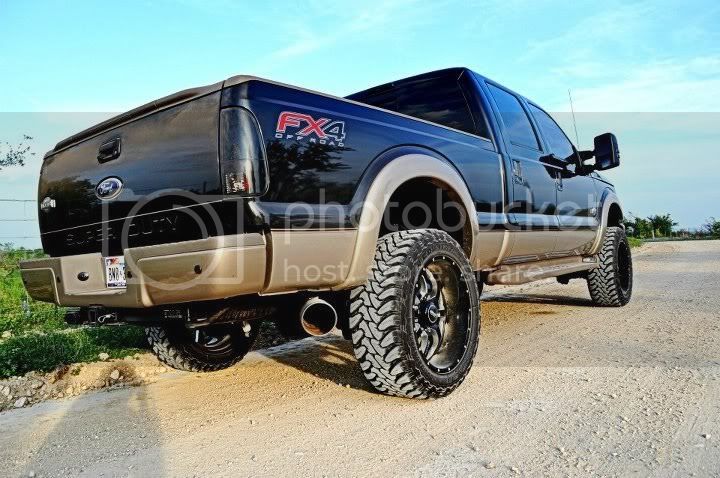

Here's a couple of mine. 3" spacer lift. Sooner or later I'm going to break down and buy a Carli and delete/tune it, but it keeps getting pushed back to buy stuff to pull around.:thumbsup:
And yes, I work 50+ hours a week to pay for this. :lookaround:
