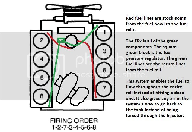

On a stock 7.3 fuel is introuduced into the head's on only one side, meaning that fuel flows in from one side of the head all the way till it hits the back of the head and stops which lets air get stuck in the back and fed to the last injector. What the FRx does is adds fuel lines to the sides of the heads that are not fed with fuel and allows the fuel and some times traped air to come back and be recirculated to the tank so the air has a chance to get out of the system.
And what exaclty does the FRx do?

The FRx is a regulated return style of fuel system without an adjustable regulator. I have the FRx on my truck and I have nothing but good things to say about it. Of course I only have stock injectors and HPO system, so I cannot say for sure how it will do with bigger components. I did it simply to make my injectors happy by not having to inject air.
The #8 cylinder fires right after the #6 cylinder on the 7.3L. This causes the #8 cylinder to be starved of fuel because the #6 cylinder used the majority of the directly available fuel.
Here is a picture I made to help you visualize the system...
