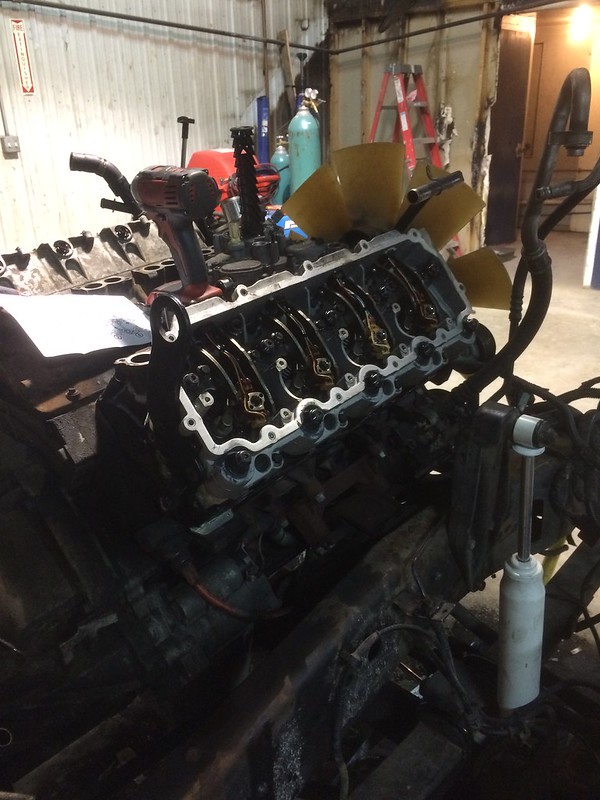

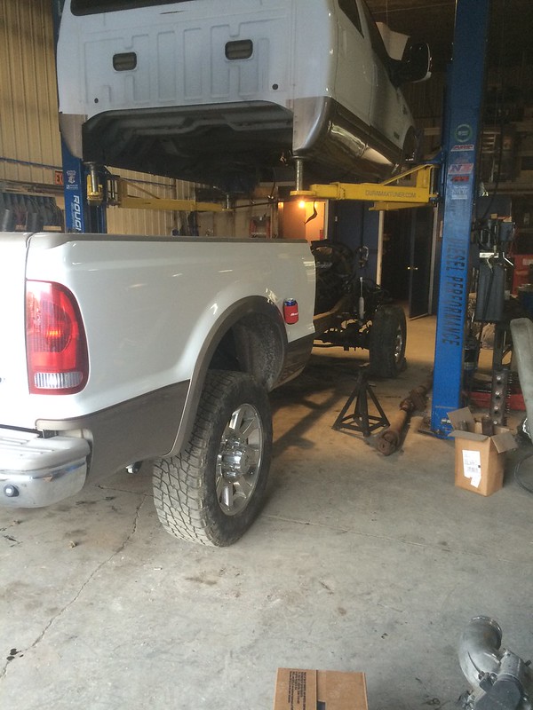

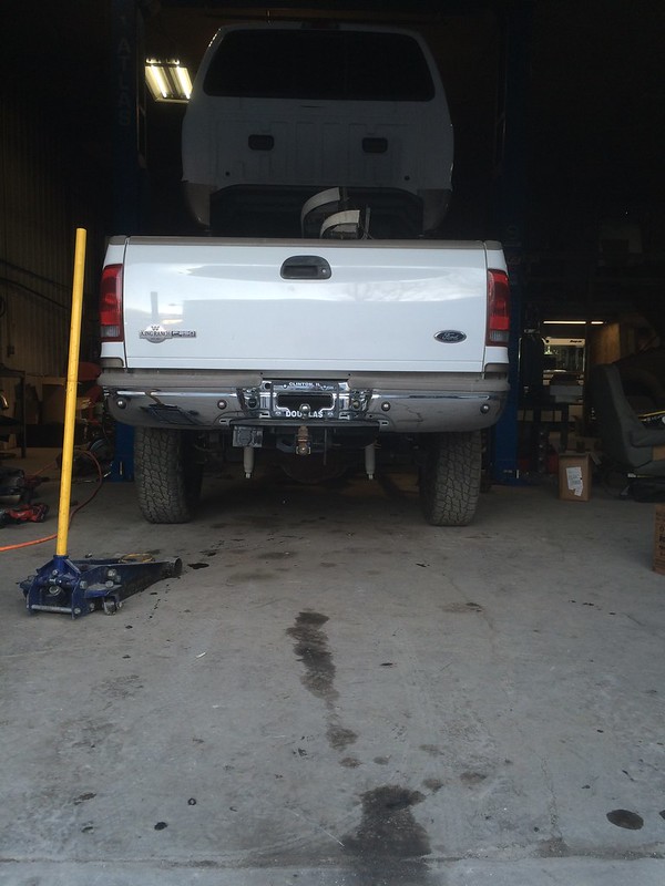

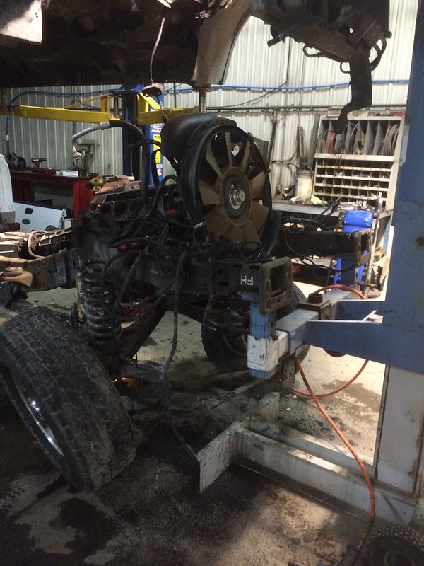

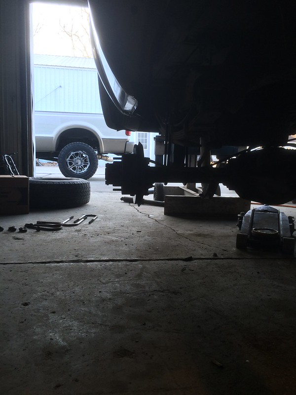

Finally got the truck pulled in the shop after work tonight and started on it around 530. Got the cab pulled first and the engine torn down. Overall the engine looked great! The EGR cooler was blown as expected, and whoever had the cab off before did a hell of a hackjob with missing turbo bolts, oil filter housing bolt, and other random bolts missing as well as a broken ICP pigtail help together by zip ties. Oh and cross the dummy plugs and stc off the list, Im an idiot and forgot this was an early 04 truck. Got the exhaust all ripped off too.

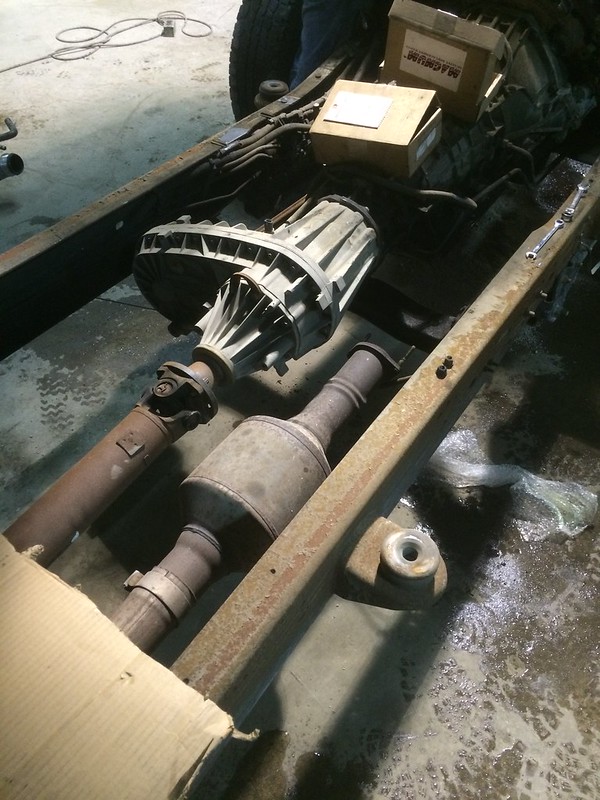

Then it was on to the 4wd swap. Got the transfercase and rear driveshaft bolted up. Im still waiting on the CV joint rebuild kit for the front driveshaft to show up so it hasnt been installed yet. Then after that it was on to ripping out all the 2wd crap.

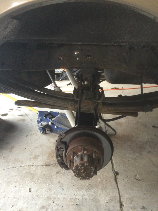

After all that was out and the coil towers popped off we wheeled the dana 60 in and the the leafs off and put the add a leafs in. Then went to work on getting the shock mounts and front and rear shackle mounts bolted on as well as the track bar mount. Then the leaf packs went on and then got the axle rolled up and set the leafs down on the axle. Got the u bolts tightened up, drag link bolted on and at 11:00 we called it done for the night with the four wheel drive swap done minus the trac bar which will go on once the cab is done.
I still need to go through the brakes and everything and replace one broken wheel stud but not a bad nights work for a couple of us. Heads go to the machine shop in the morning and hopefully the engine parts and exhaust and all that will be here in the next couple days. Here are some pics
Cab up
Untitled by mattpopiel, on Flickr
Transfercase and driveshaft on

Engine tore down

2wd coming out
Its gone

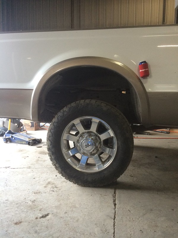

Well no huge update unfortunately since all the engine parts wont be in til monday now. I got the heads back, new sway bar links in the front and got the rear blocks installed and new shocks and put the new wheels on to see how they look until the 2" spacers show up

I can't believe how good those 08 20's look on these older trucks.

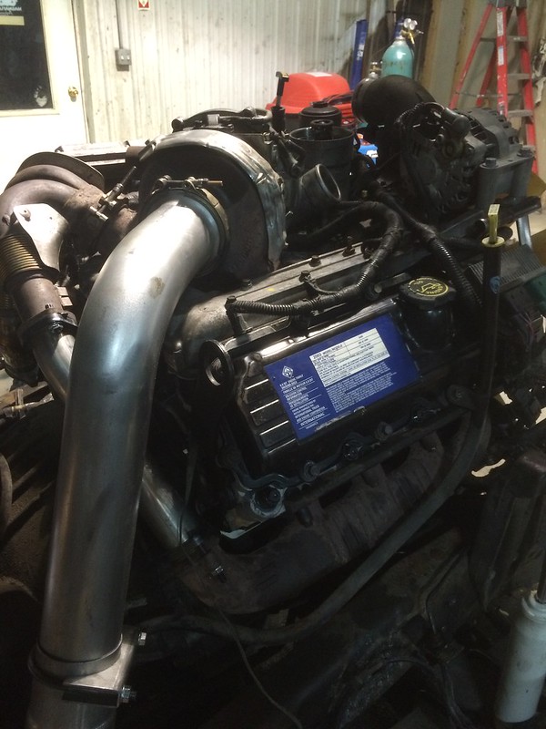

The IPR screen was about halfway off the IPR, that explains part of why it started so hard when cold besides the four bad glow plugs

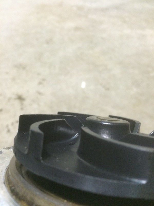

Decided to replace the water pump as well becuase I could see a little coolant on the front cover and when I pulled it out, it was worn out to the born where the fins were contacting the housing. Threw in a new thermostat as well

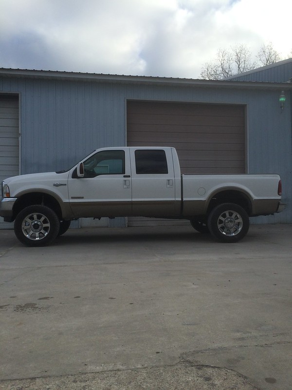

Thanks guys! I forgot to update the thread again, Ive been driving the truck for the past couple days and its running great! Everything for the 05 front end showed up so Ill be putting that on soon and then continuing to drive it while my truck is in the shop to make sure everything is good on it.

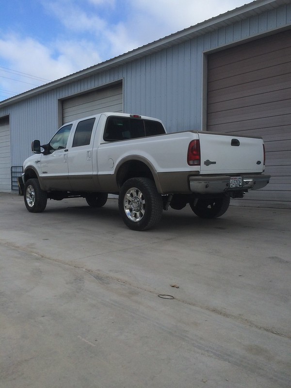

Here are some finished pictures with the old front end

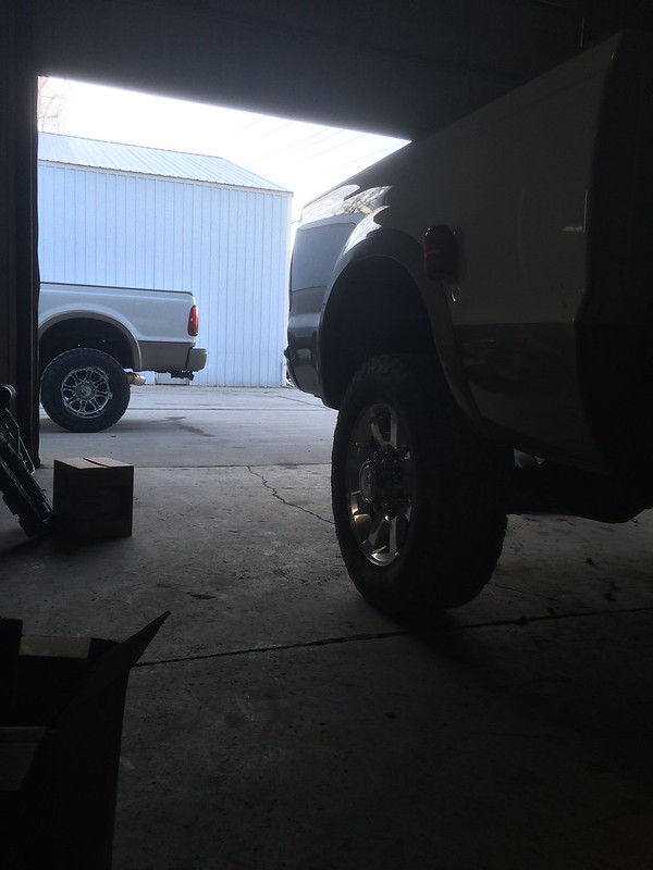

Sits just slightly lower than my truck
