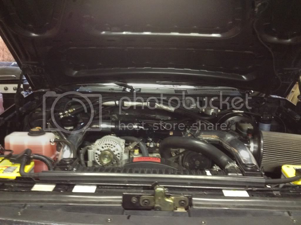

What loose material are you referring to? I cleaned the pipes before welding and after. Ran a write wheel on a flexible extension through them after also. I see people weld them all the time. But i see what you're saying. That would have been at least another 6 boots and 12 clamps. And the muffler exhaust machine would constrict it way too much.

Well i finished. I never realized how hard it was to weld thin metal. Burned through a couple times but got it done. Here they are unpainted and i haven't taken the grinder to them yet with.
And an intercooler makes a huge difference. With my hybrids and no intercooler i could peg my egt gauge in no time. Now floored it hits about 1450 after a little while and doesn't go higher. And I only stayed there for about 10 seconds then slowed down.
Thanks for all your help.

Pipes look good
