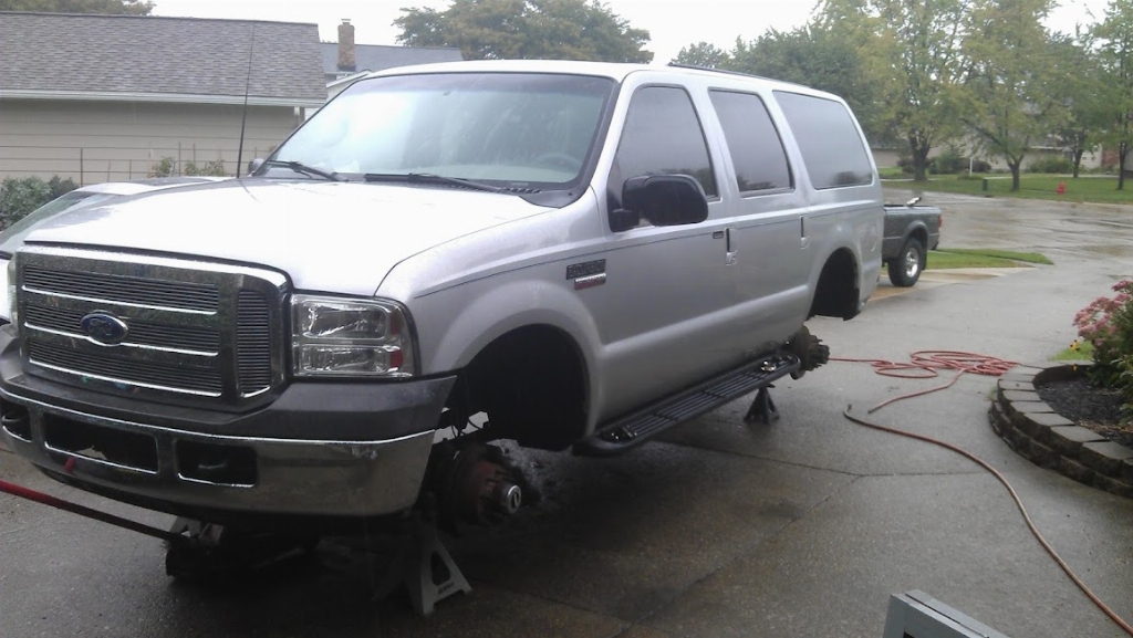

Cant test drive at the moment:
Should be an update on wednesday
