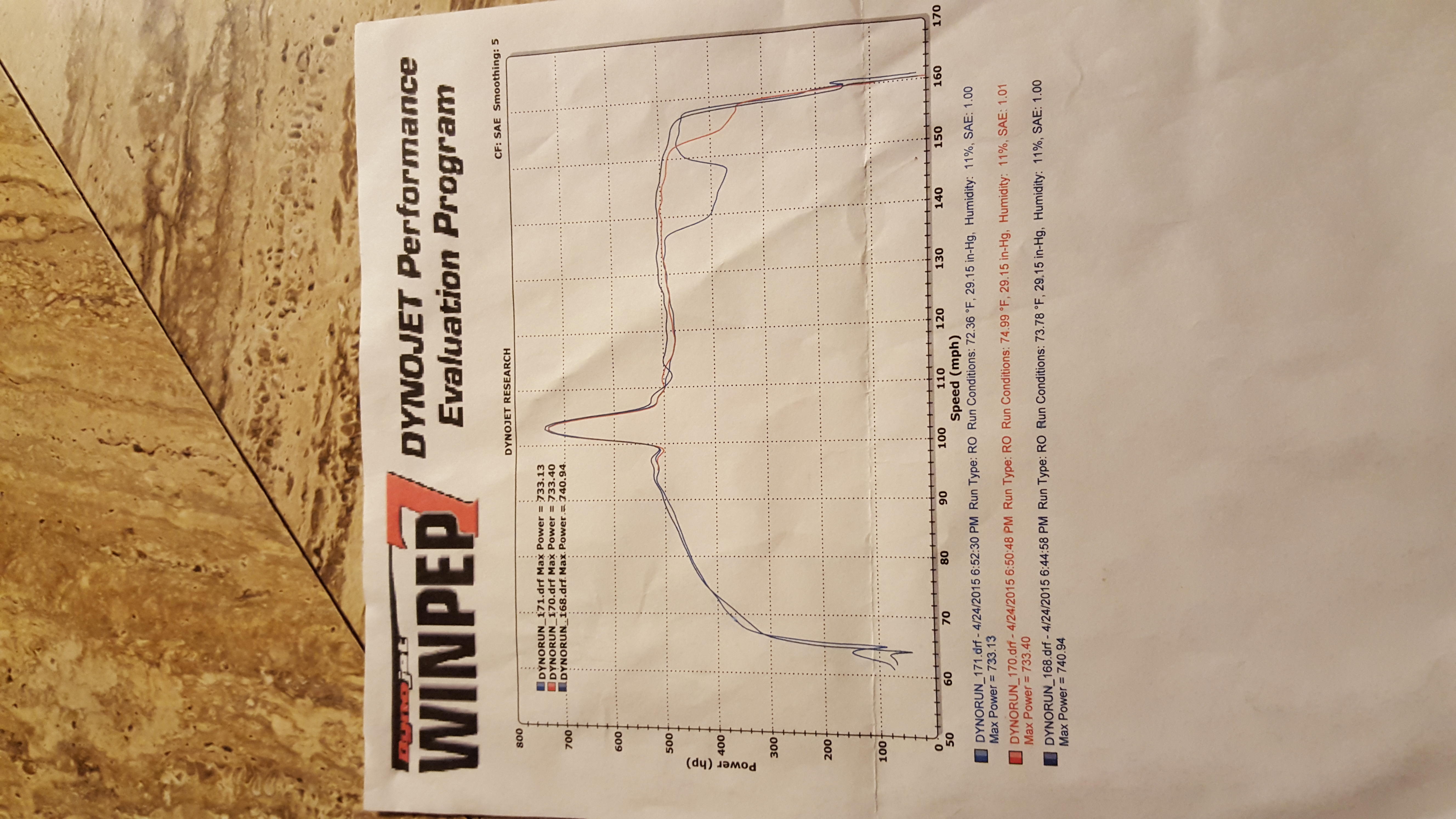

Doing good bud. It's not wanting to hold icp with a hot motor but i think it's because these old wore out injectors. I'm going to put these 275/100s in it and get matt to try and give me around 230ccs of fuel. Track times will come soon. If this pump can get me under 11.5 i will say you guys have a real winner.

Here is our dyno pull showing how much power you loose between 3.1v and 4.8v before we pulled it back this was what our entire graph looked like once you went wot.
I've got 2 dyno sheets that I pretty sure some serious ICP loss the 700hp sheet is an older vgt setup. You can see when I let off the nos by accident on one run and all three of those runs are nos .
The other one if from Rudy's again first run fuel only second was with a .032 jet and my hpids brust and caught fir .
