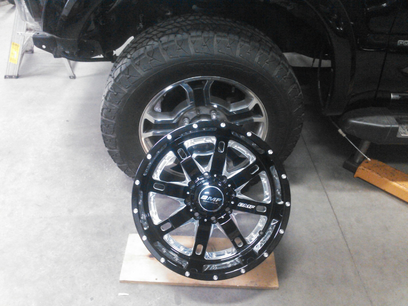

So the truck will be done tomorrow most likely. He used 1/4 think aluminum, 3" box, so it's one piece, like you mentioned Craig. Seems pretty stout. Ordered my tires today to be put on the BMF REPRS that I bought from GRacing back in the spring. Great guy to order from, the wheels came in within days of placing the order with him, and just this week he sent me out a set of lug nuts free of charge!! Couldn't ask for better service!!

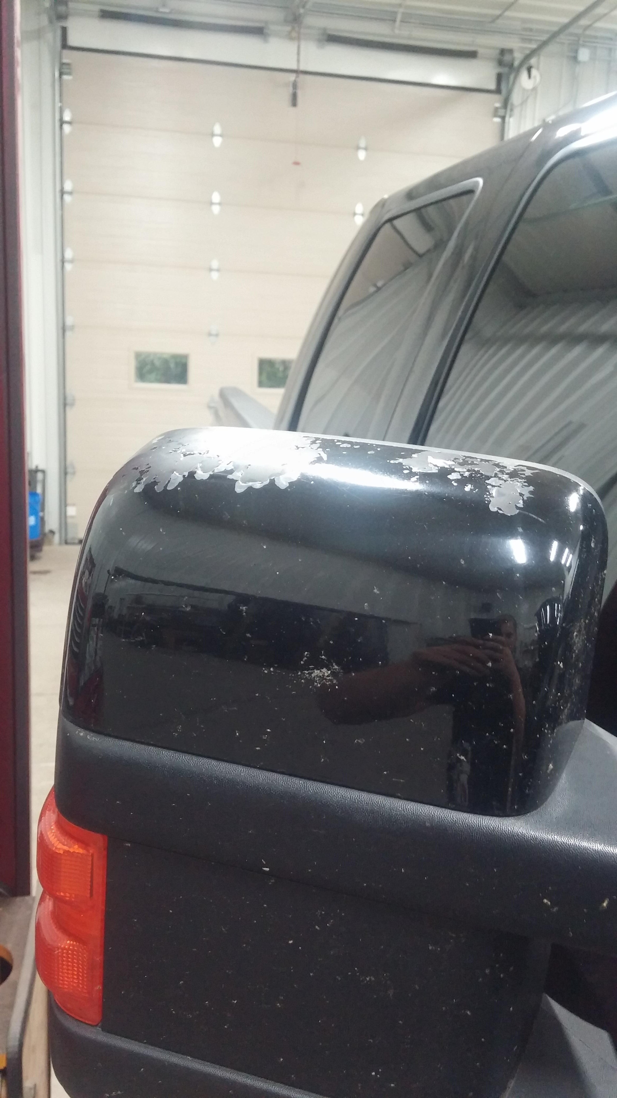

Also have a question, In the picture Im going to post below. Are these mirror caps? And if so, are they removable to be painted? The clear is pealing pretty bad and they will need to be sprayed this winter when the truck is put away.

Tilt the mirror glass all the way down and you will see two clips. I used to small flat head screw drivers so I wouldn't have to go back forth between the two clips. Pop the clips and pull the mirror cap.
