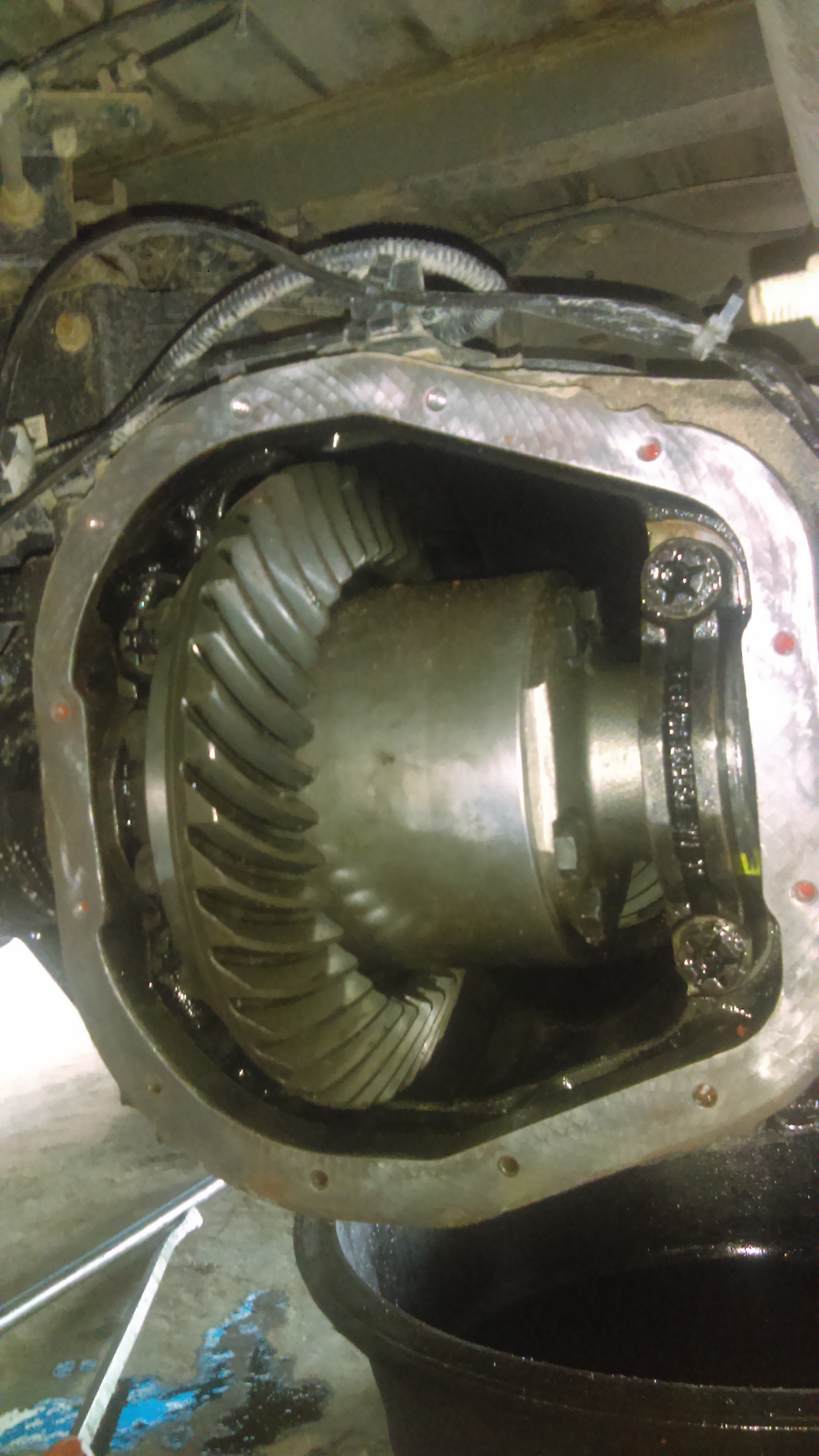

So I got my truetrac in today! So far very happy with it. Install went OK. I was told when I ordered it that my rear end would have adjusters to center the locker... But it had shims. Thankfully the factory ones worked. If I knew it had shims I would have got spares or ordered a master kit. But I also should have paid attention when I had the cover off the first time. But it works so no harm no foul. Just a heads up to anyone else that does this!
Did you at least check backlash, marking compound to check patern?
