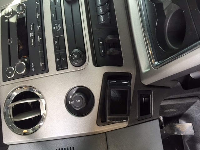

Took it out of the sunglasses holder and moved it, what do you guys think?

Looks good, hows the visual clearance, as in can you see it pretty well while driving?

Thanks! I just put it together this morning but haven't driven it yet. I'm not worried about seeing anything on it as I monitor the truck using a triple pod pillar.

Gotcha, well then I'd say it's a lot better than keeping it in the roof :p

Yeah right! It scared the ever living hell of out me. With the trans shifting on its own, I thought something was seriously wrong. I will report back on overall seeing ability though. I might add a little Velcro strips to keep it more in place.
