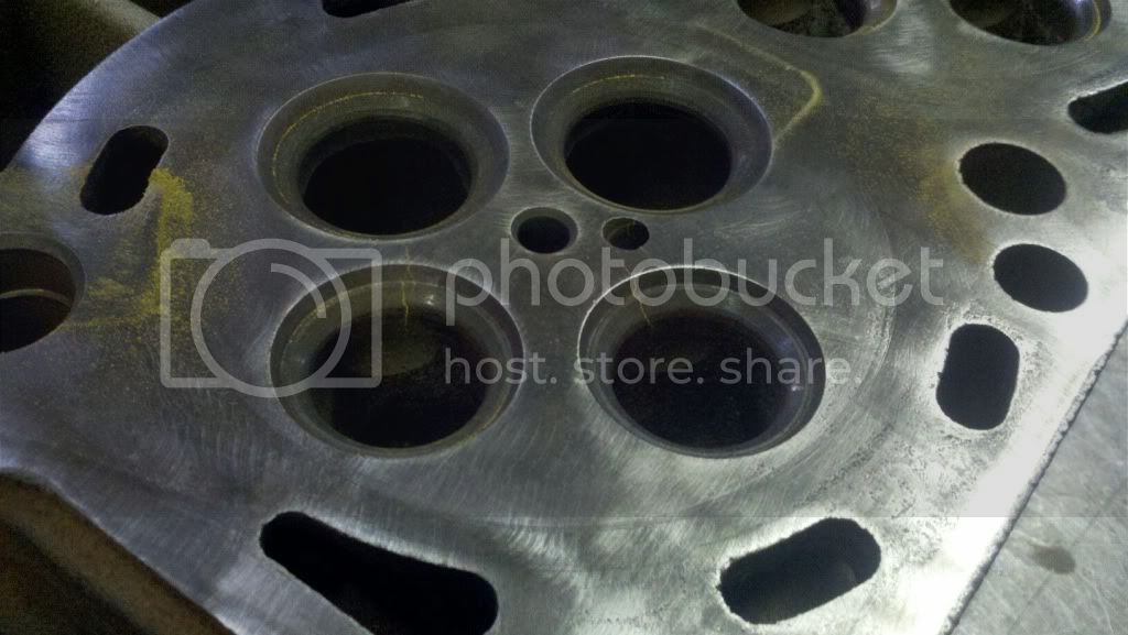

just a ? did you install cooling system guage to watch psi before tear down?
i got one that is blowing degas bottle cap and runs 17psi de cel right after wot run.
removed coolers found lower cooler very lil moisture at gskt between coolers
im not thinking its a blown cooler.
any ideas
im leanen towards hgs
this is my first time to test drive whith a concern like this whith a guage so its a learning experince
thanks
a gauge is a waste of time.... hg's go boom wth a big tune. not like a 6.0 though, we make 150 more hp before the boom happens.. LOL
