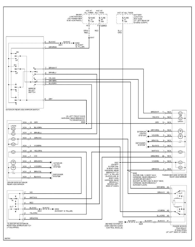

Hello all I'm doing an 08+ mirror conversion and need a wiring diagram and or a pin out of the connector from the mirror on an 08+ power everything defrost clearance lights and markers. Thanks for any help.
