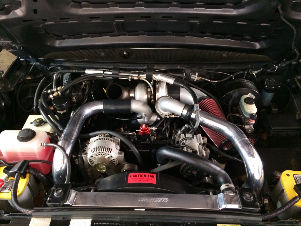

Mine is in, too. I replaced all of the radiator hoses at the same time.
I drove it a bit to check for leaks and make sure air wasn't trapped. Water temps look good and no leaks.
The interesting thing on my truck is that the trans temps are 20-30 degrees lower than with the stock radiator. I have a Trucool 4739 in my bumper and plumbed the radiator in ahead of it. I have always seen ambient + 90-100 degrees. Not too concerned about it, but so far, temps are ambient + 70-80 degrees. I will keep an eye on it.
No pics yet, it looks just like the post above, just not as clean and fast!

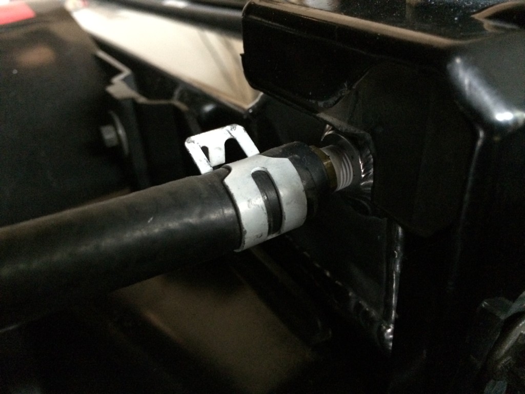

I was surprised to find the brass barb fitting for the return at the local hardware store today.
I forgot completely it did not come with it.

The only one I needed was this,
For the overflow.
My stocker was molded plastic.
