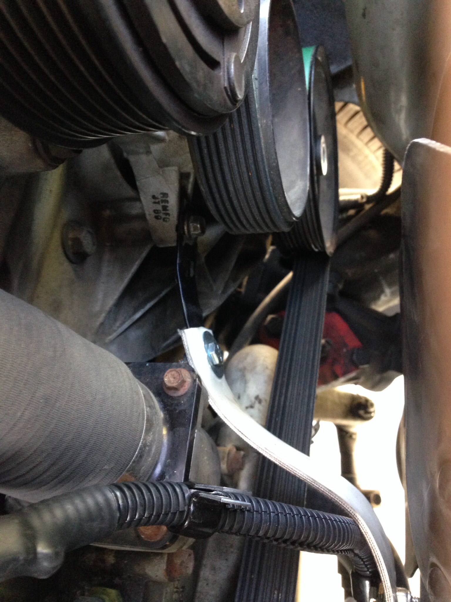

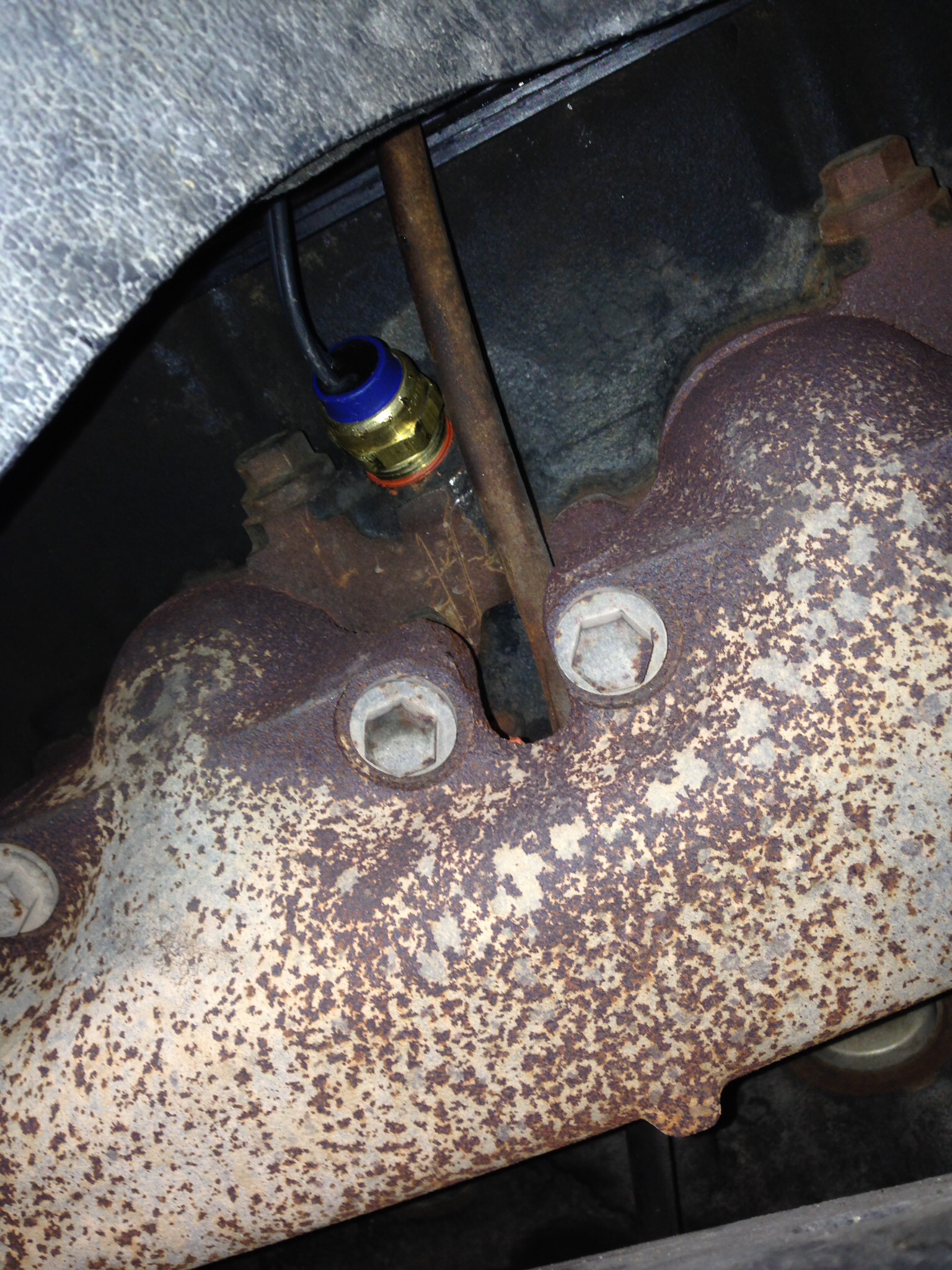

Well, I installed my fan clutch today.
The temperature switch was installed a couple of days ago in the passenger side head, right next to the dipstick tube. That only took 20 minute or so and I lost maybe half a quart of coolant when I did it, I just swapped the plug and sensor really quick.
The fan clutch install only took me 2 hours or so, and that included modifying the bracket for the anti-rotation strap, just like that thread from the ORG. I just flattened mine and drilled a new hole, and used a vacuum pump bolt to secure it. This creates two issues to look out for and I will be looking for a new mounting point when I do my water pump in the near future. I needed to get this thing roadworthy ASAP since it's my daily driver. First, this required pulling the vacuum pump pulley to use the bolt. Not a big deal in my driveway. Second, this location puts the strap inside of the serpentine belt and will require the fan clutch or anti-rotation strap to be removed to change the belt. That is an issue on the side of the road.
I hooked up the harness and broke in the fan clutch per the instructions. I don't have the A/C switch or manual override installed yet, just waiting on some parts, but I should be okay for a few days. I will say, when that thing engages, even at idle, you know it. I used my original metal fan, good thing I didn't scrap it. I have a 6.0 fan for sale if anyone in Socal is looking for one.
Thanks for all of the tips! I will keep this updated as time goes by.
Rusty
You can stud the bolt on the vacuum pump. Use one nut to fasten the vacuum pump, put the strap on :doh: and use another nut for the strap.
I don't think the strap is inside the belt. Can't the belt go over the fan blade for removal?

I'll have to try that with the belt. It sure looked like it wouldn't work, but I was in a rush to get it done.
The stud idea is good, too. And that one bolt, holding the white pleather to the flattened bracket is pretty simple to remove. There are some options.
Rusty

There is a 1/2 coolant plug at the rear of the driver's side head. I want to keep the wires on the driver side as I don't want wires running all over the place. I didn't check how the coolant flows on the 7.3.
I'll swinging by my shop later today. If I remember, I'll get the info/pics for the connector and AC switch. I haven't looked into the terminal arrangement on the switch.
Billy T.
[email protected]
Your plan with the harness is a good one. I still need to work on routing the included harness a bit cleaner.
