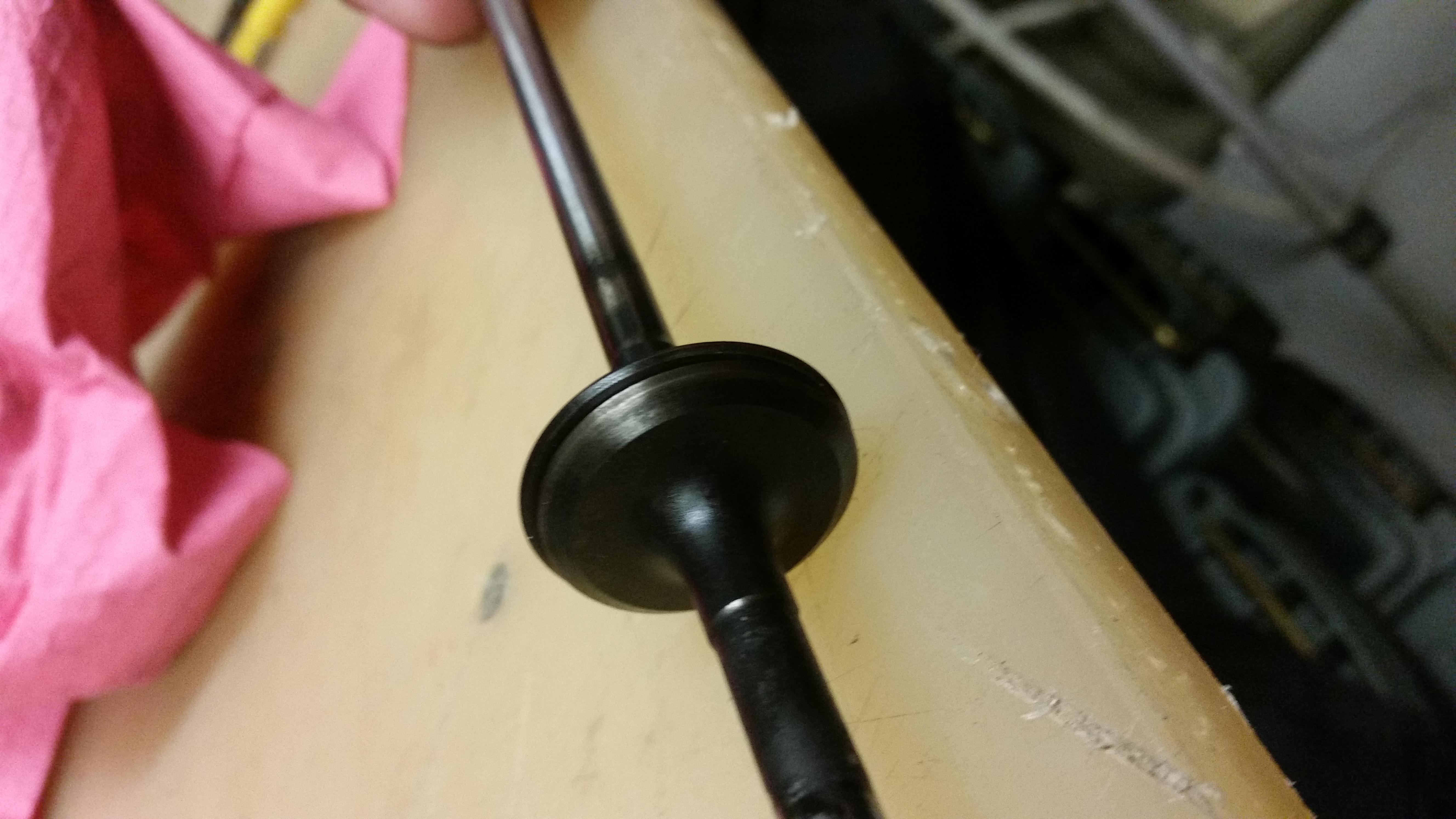

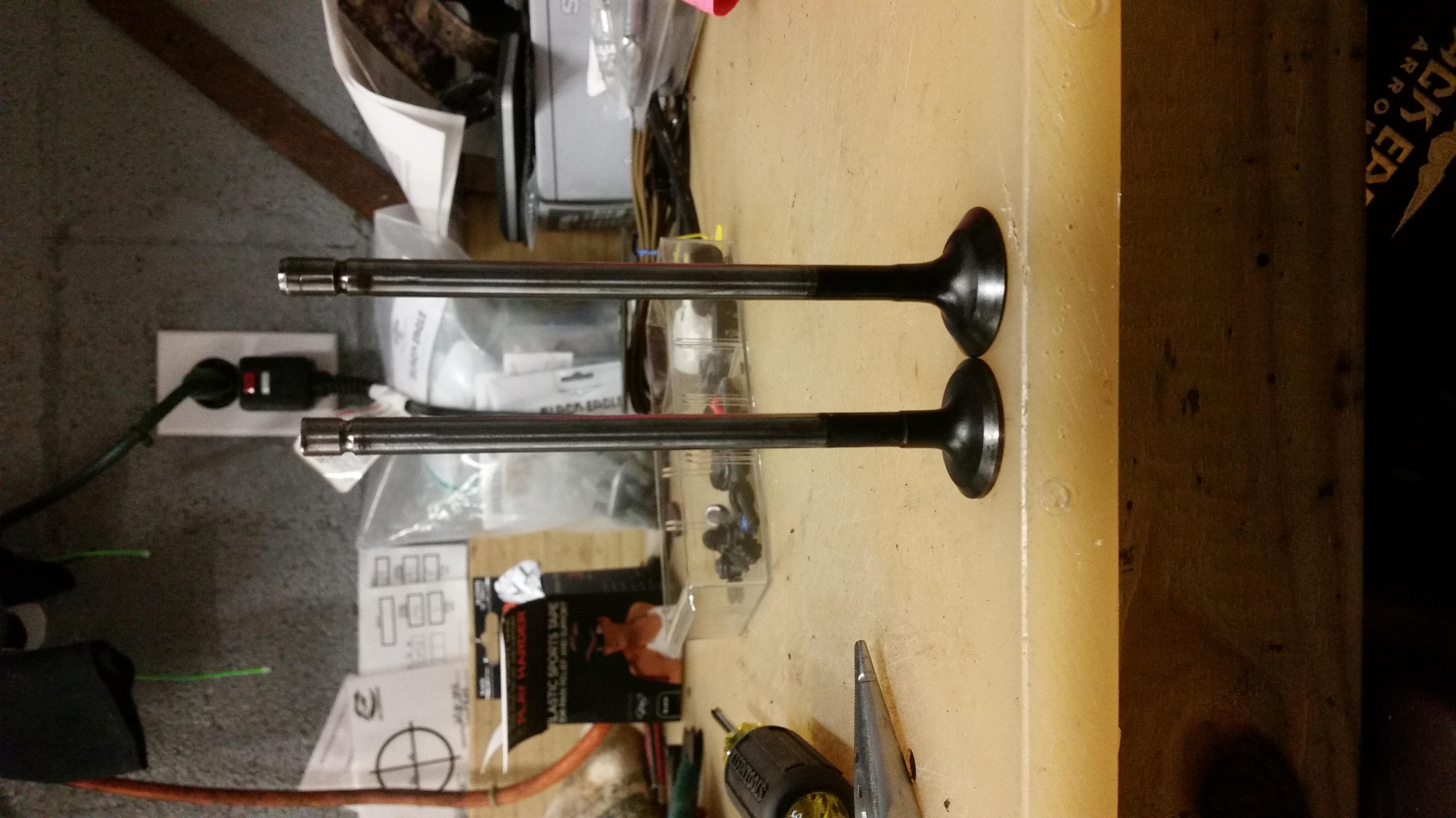

Pulled head piston has valve marks, i dont see a crack in the piston. Removed the #4 exhaust valves, one valve was mushroomed on top had to file down to get out. Rolled valves neither look bent. Lookina at the valves one is longer than the other by .110" also they dont have the grind on on the seat end. That dosnt make sense to me why would one valve be almost a 1/8th inch longer? The seats dont look bad. Im going to change seals while im there
