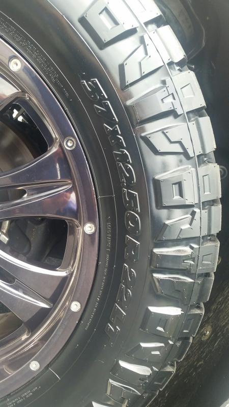

Well, not sure how my mileage can get any worse. Discount tire fitted one on the front and it fits and looks fantastic. They r doing the rest now...

I ll get a better pic later

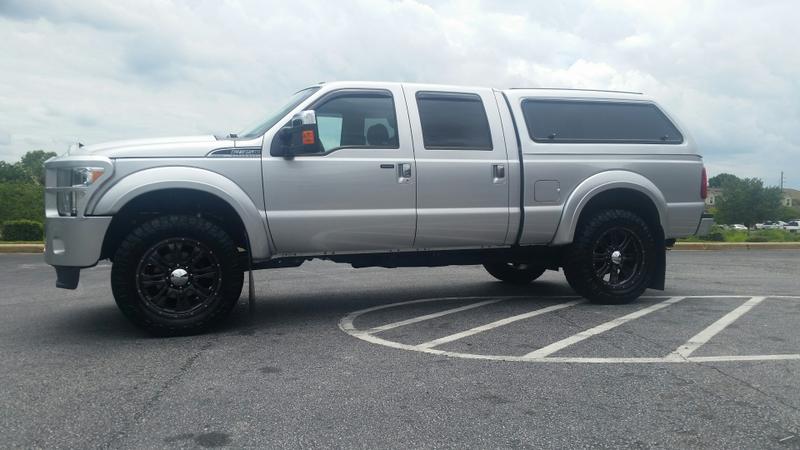

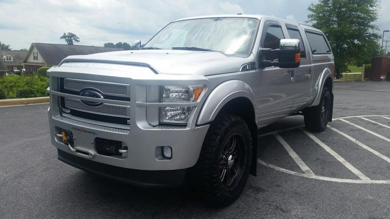

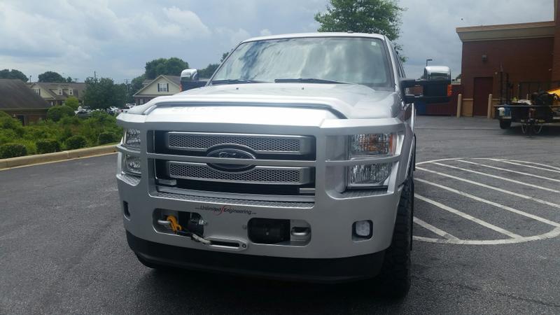

Here's some better pictures
Driven them about 40mi. So far, I like them!
Now sitting at Discount Tire waiting for Fedup to deliver the last tire that they lost. Supposedly on the truck today. Then I have to drive 10 hours. :(
Yea, I know the bug deflector is fugly, but after catching a rock across my hood and into the windshield I thought I'd try it. Doubt it'll grow on me.

I'm so envious of those 37's and that ride.
