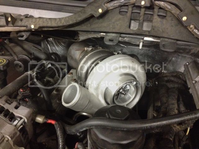

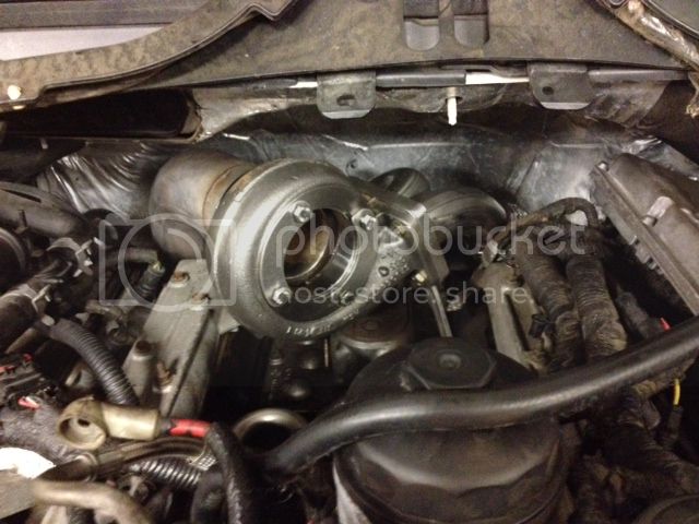

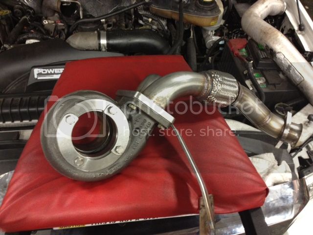

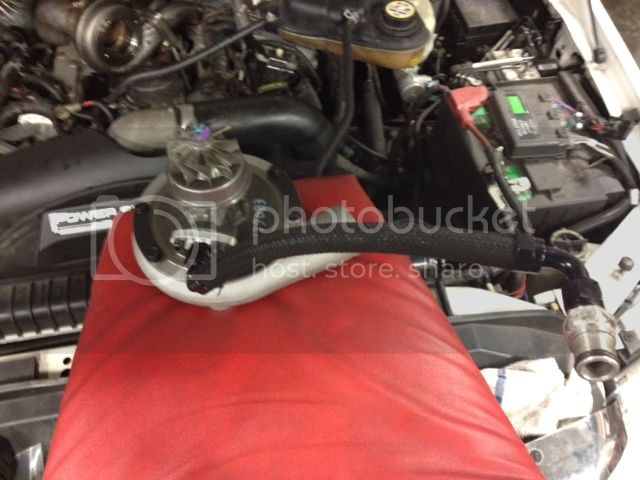

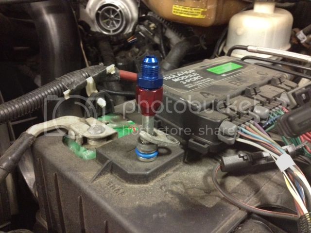

I know there has been alot of question about how to install our kits so i fiqured why not put one on my dually that i tow with well here they are i used a new borg warner 62fmw which is a 62/68/83t4...still running xtreme x for stock turbo havent got a chance to get it tuned yet

I'm not sure from what I have found in messing with turbos is the exhaust size determines spool up compressor side doesn't change spooling
got ya yea im not very educated on turbos. why did you go with a 62 and not a 66 with a tighter housing?
Tighter exhaust housing don't help spool up they actually choke it out and .83 is the smallest t4 they make
