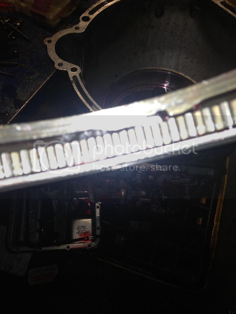

either way, this is what I broke in the trans.
Got the call from Hassler and he said the ring and pinion and the spider gears look fine in the front diff but there is lots of play so we think I cracked the diff itself. Will know a little later today. Going to throw a billet low/reverse hub in the trans too while it's apart (again) Leaving the stock intermediate for now, not my first choice but I just can't afford a billet one right now

So I've been told that this "reverse clock spring" that I broke in the trans is a super expensive part... anyone know anything about these things?

I know nothing other than I am 99% sure that is what I destroyed in mine as well a couple years ago...looks very similar to that part and mine came out in pieces!
09stroker
1,300
Texas
Looks like the low/reverse diode. It's expensive now because ford doesn't sell it by itself. They sell a non-serviceable low/reverse clutch pack. That all includes the diode, clutches, steels, carrier, and planetary all as one unit. You can still find the diode from older transmissions.

low mechanical diode it is a one way mechanical clutch. 03-04 are different than 05up i have one for 05up.
exactly. They sell the whole low/reverse setup as one which is $1600 bucks.
Looks like I have a core trans to steal the part out of. But anyways how much do you want for the one you have. Mine is an 05 so should work
