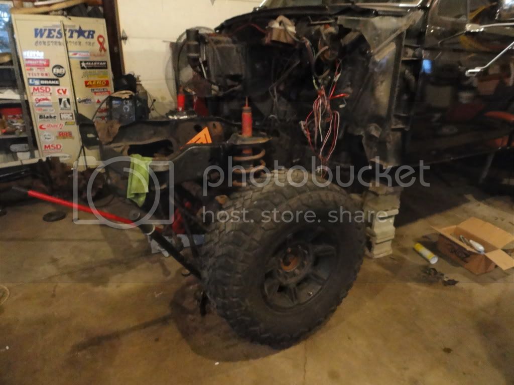

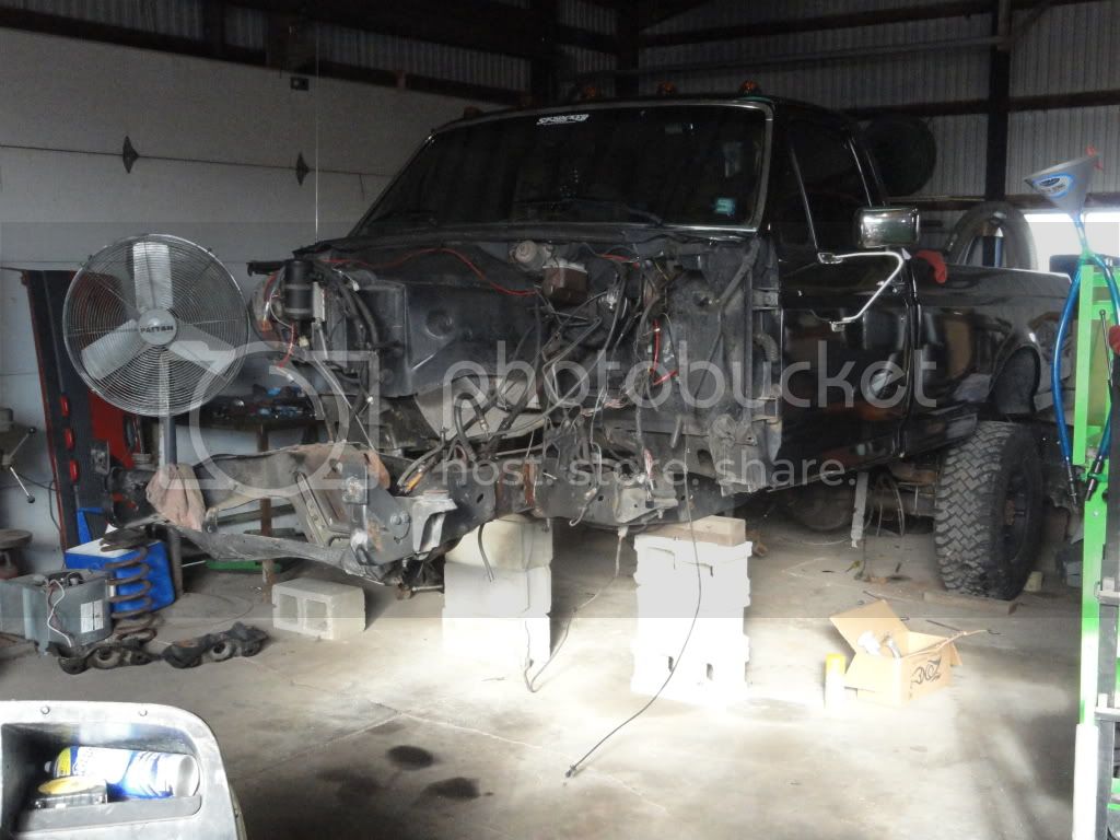

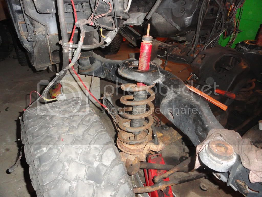

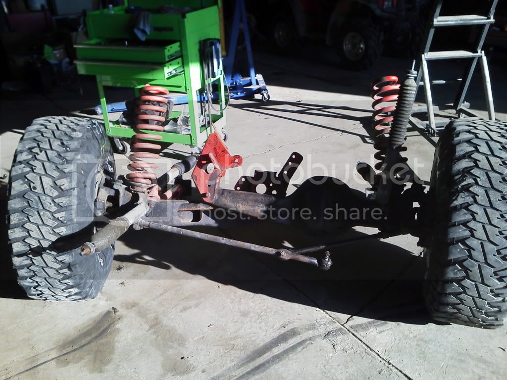

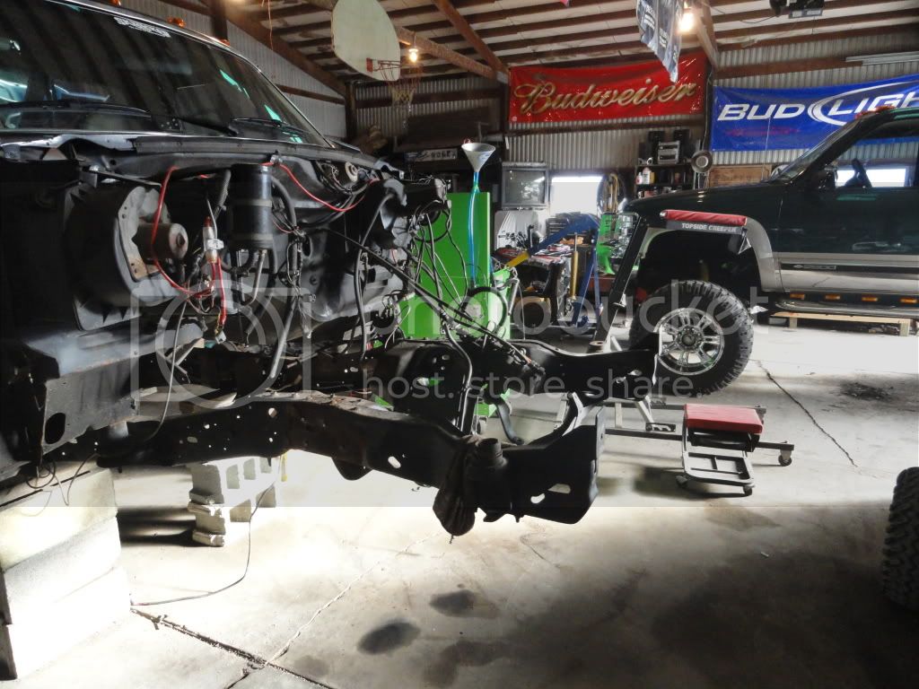

Well havent got a whole lot done lately cause I was out of town last weekend, but did get the old TTB out of the front end and got the Old coil buckets off. I also pulled out some more unnecessary wiring then once I can get a hold of a wiring diagram that actually shows everything for chassis electrical I can go further with that or just buy an 18 circuit painless harness and start from scratch.

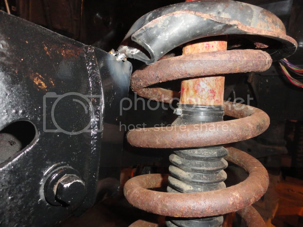

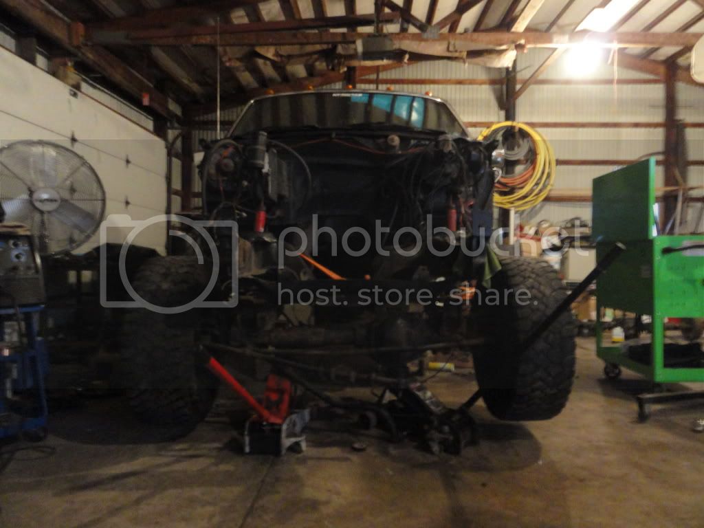

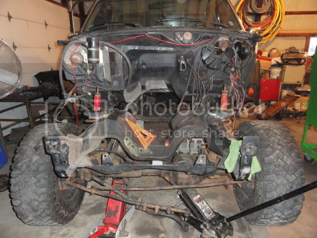

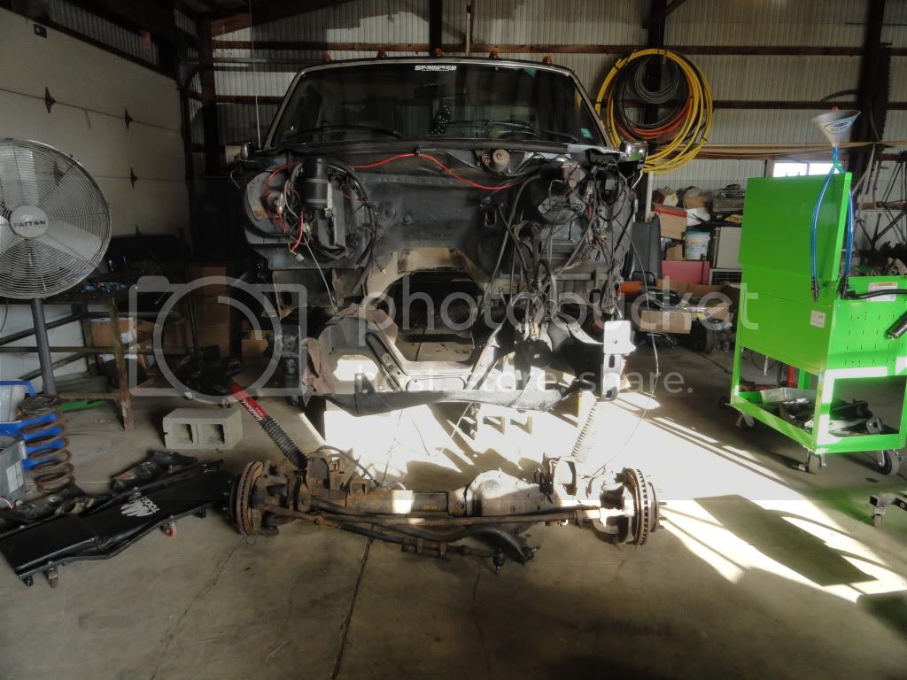

Well me and Bryan have been working some more the past two days and finally have the dana 60 under the front of the truck! Its not all done but we got the frame all notched out and welded and the dodge coil buckets cut off the donor truck and cut down and welded on the truck.
Dont worry the buckets are not done yet, we are gonna do plenty more bracing on them, then its on to the 3 link and getting the trac bar and steering mounted up and the frame boxed.
