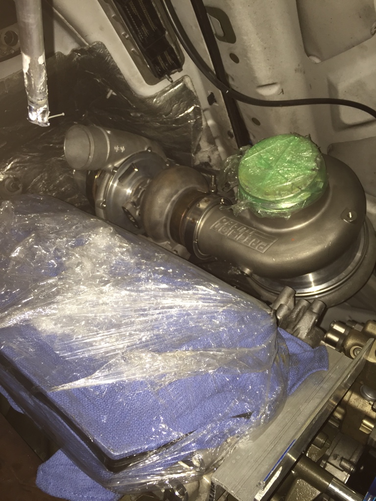

Perfect position for a hood stack... just sayin lol
Why does it look like the compressor of the big one is feeding the exhaust of the small one?
Thats just how the Precision Turbos look. Looks to me like the small turbo is mounted backwards on the pedestal with the exhaust facing forward feeding the exhaust on the big turbo. The blue is where the passenger side intake manifold with be.
Six_Sloww
Dec 5, 2013
2,574
Southeast MI
I think it's just odd to see anything stamped on the turbine housing, and it's so huge it makes it look like a compressor housing.
Jonnydime
Jun 26, 2012
2,319
8
Seems like a good idea except it doesn't leave much room for a gate between stages. The downpipe is now in the front?
Swsignal5
Dec 9, 2014
503
I don't plan on running gates right now. I'm want to see the pressures first open. Then If needed I will put one on the t4 mount

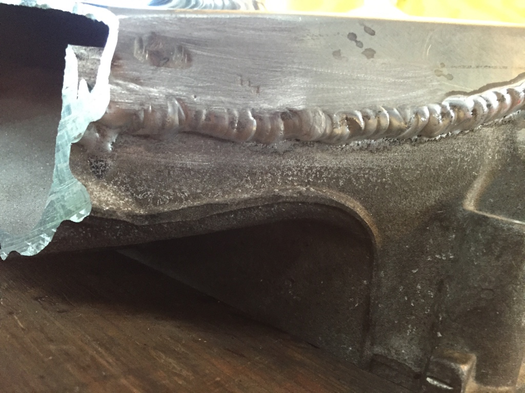

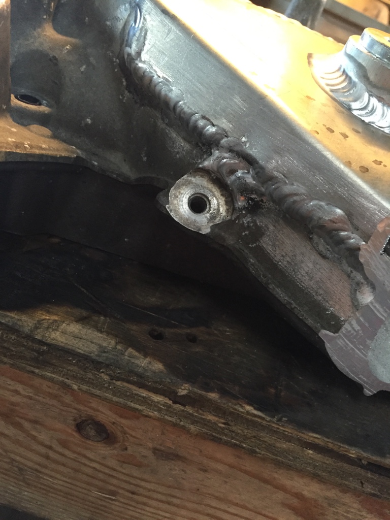

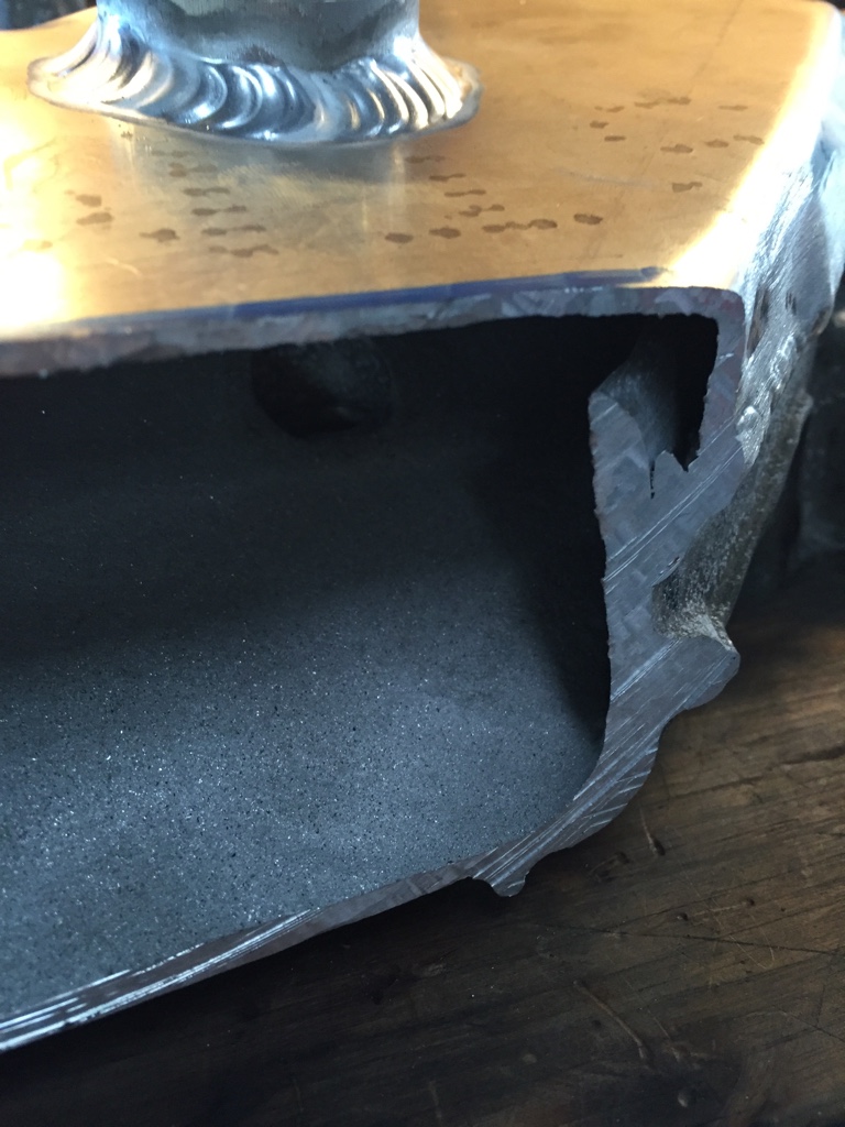

Kinda upset how these were ported. Especially for the money
