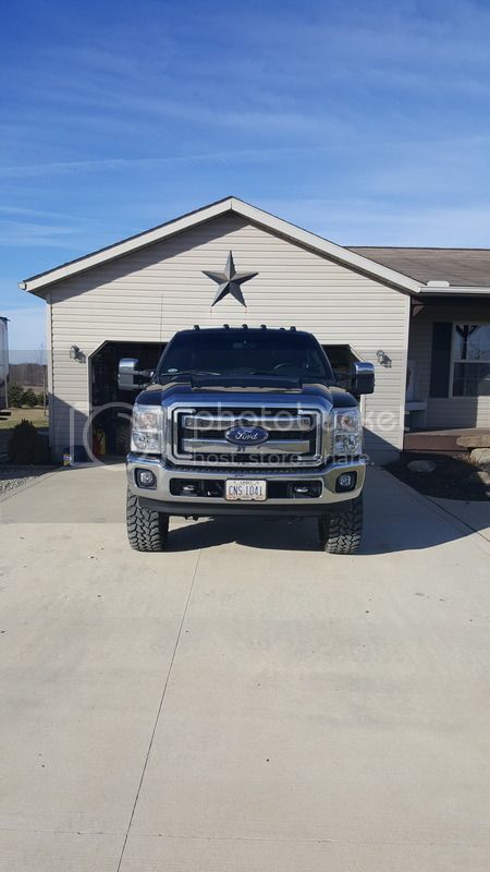

Before...
After...
Looks good I think. Now just need to paint black and see if I can get smoke lens for the marker lights and get them tied in.
