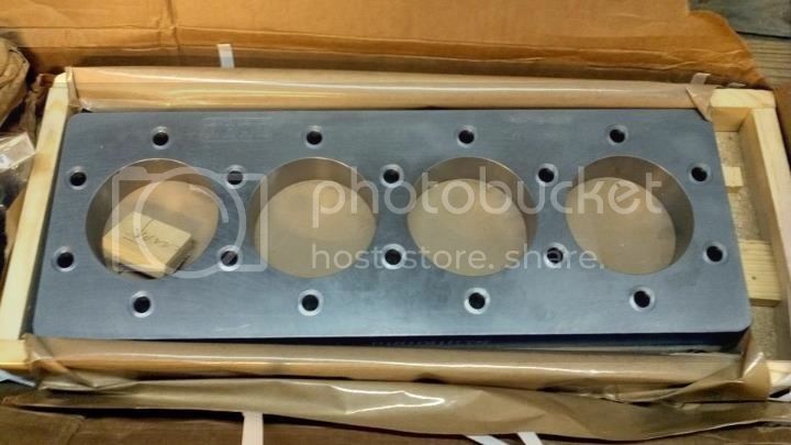

Waiting on parts. The torque plate ahould be here Thursday then it's gonna get bored out and start installing internals.
jwlandry
2,533
S.W. Louisiana
This showed up today....
