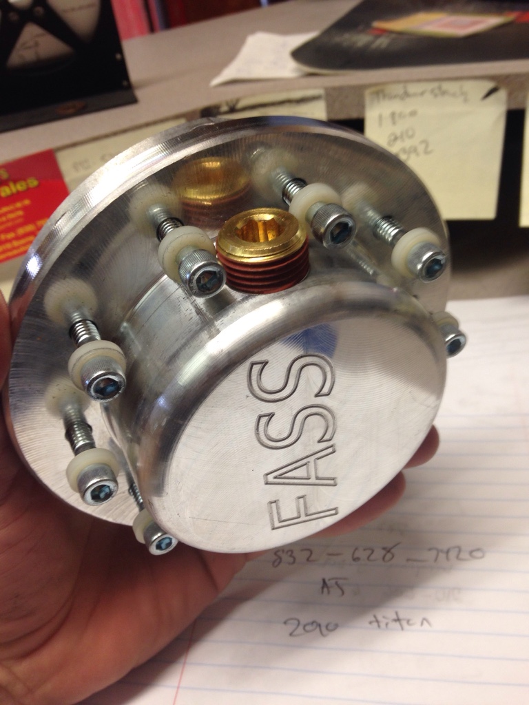

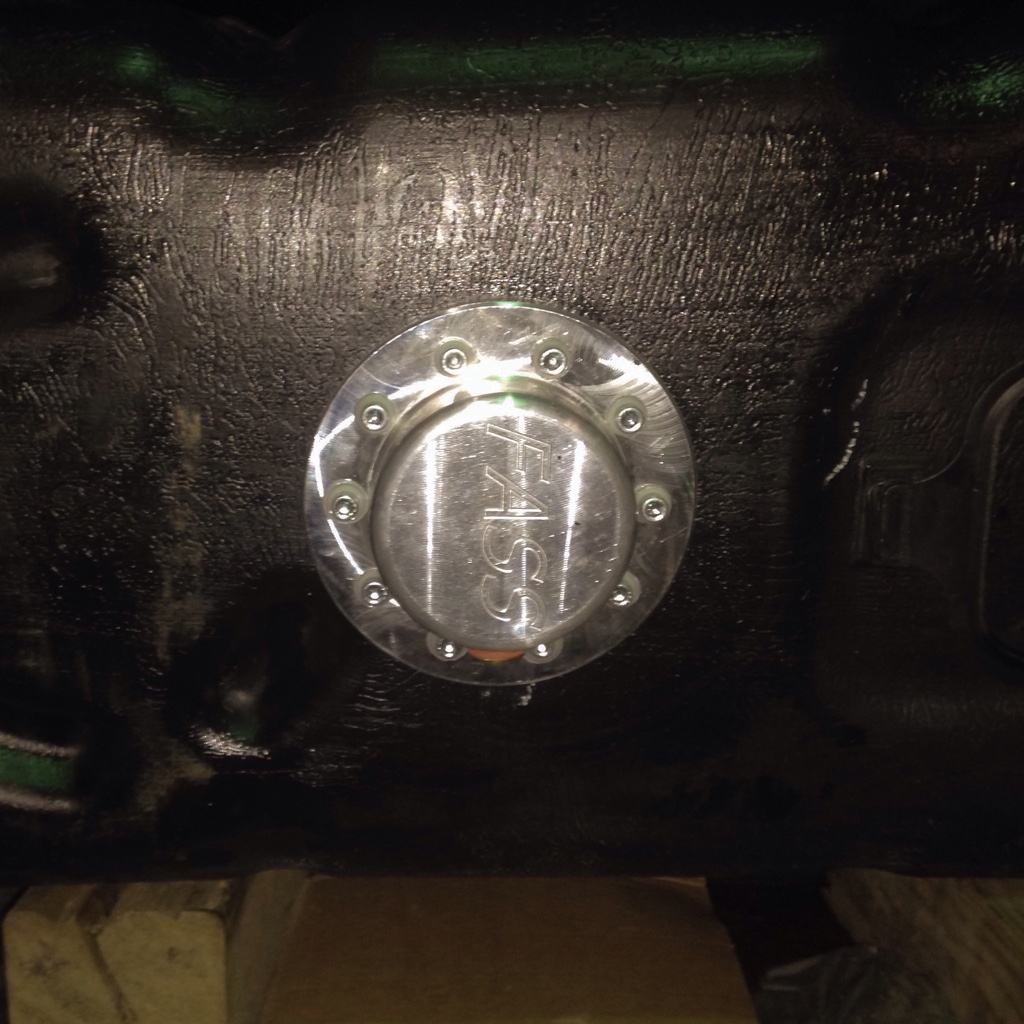

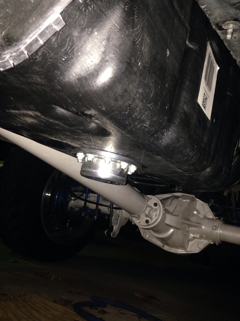

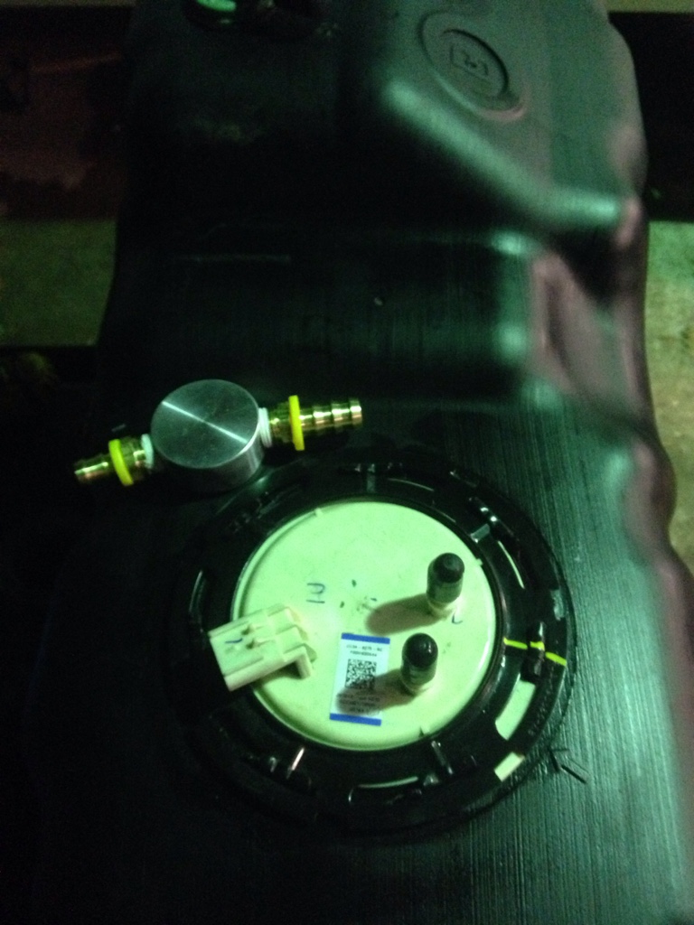

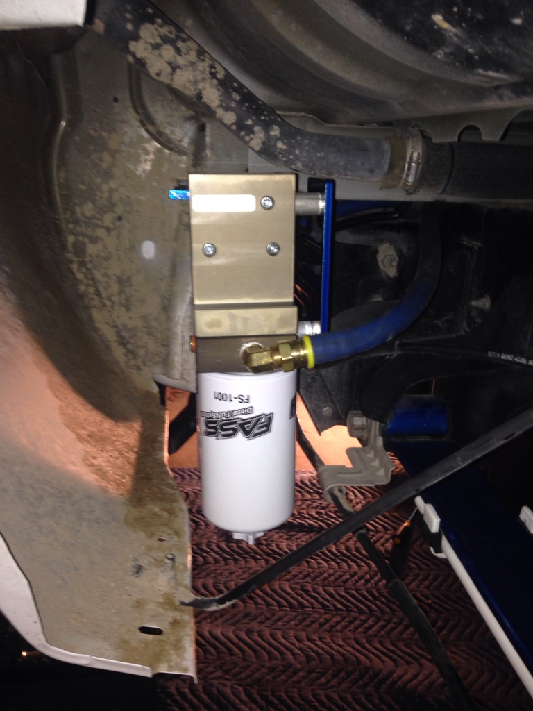

Well I decided that I better feed my cp3 in my dual fueler set up with a seperate lpfp so I can keep it happy with lower fuel pressure. I went with a fass 200 and a fass sump kit. Drilling a 2" hole in the bottom of the tank of a truck with less than 18k on the clock will deffinatly get you to check your measurements multiple times.

Set my truck up the same way works well, I would recommend putting a fuel pressure gauge in the fass port so you know when its getting ready to **** the bed.
Hendrys2009
Oct 1, 2013
211
Baytown, Tx

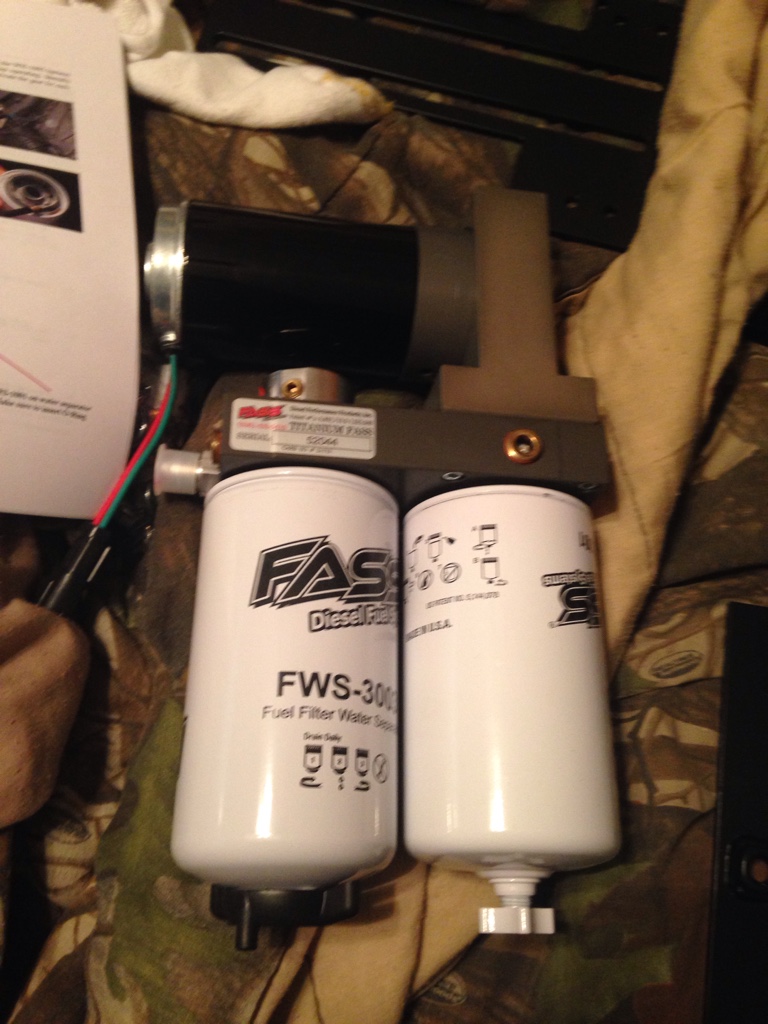

Any reason you didn't go with the new H&S LPFS kit?
I needed something quick, Im trying to get my truck going before the 20th for tsd's dyno event.
I know that's right. already in the works. Not many gauge pods available for these trucks.

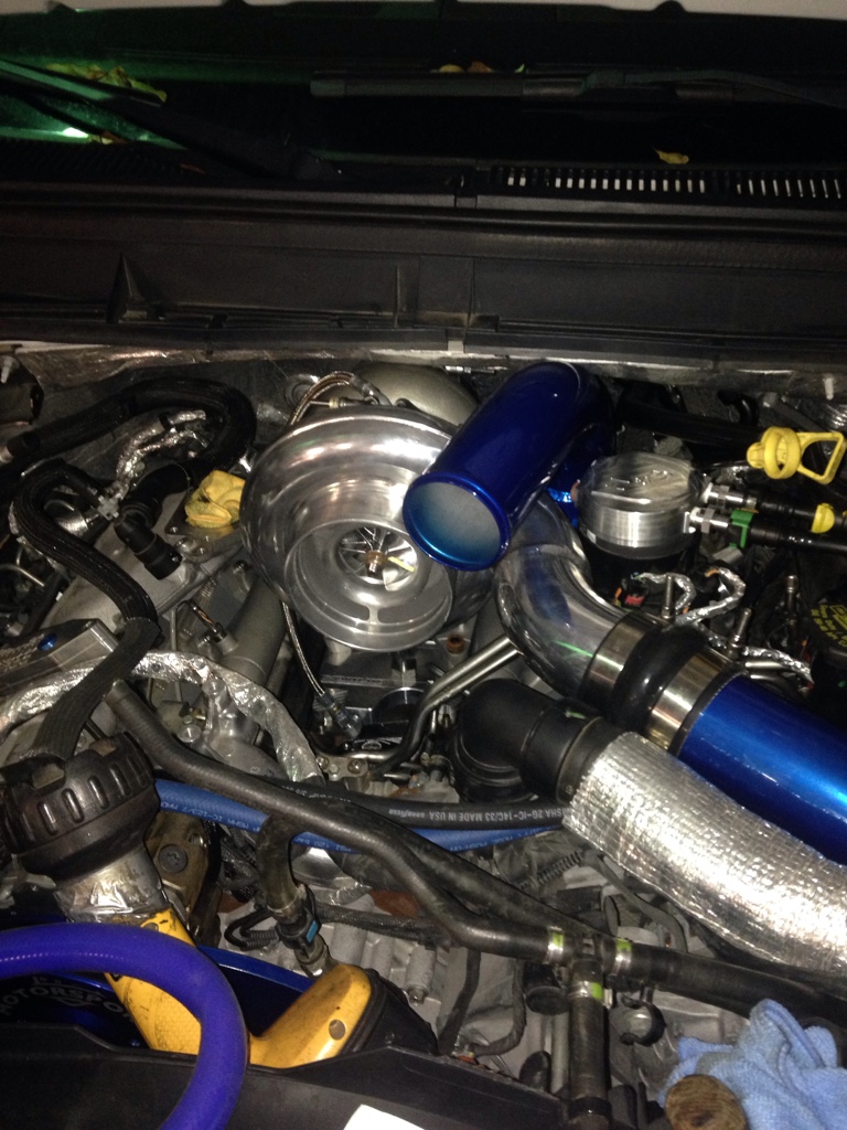

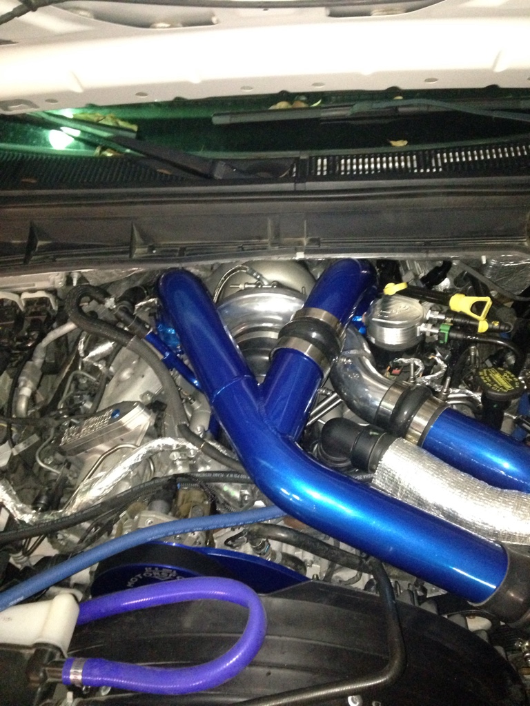

As per mr. Joey's request I will update this. Been working my butt off everyday after work trying to have it ready for tsd this weekend.

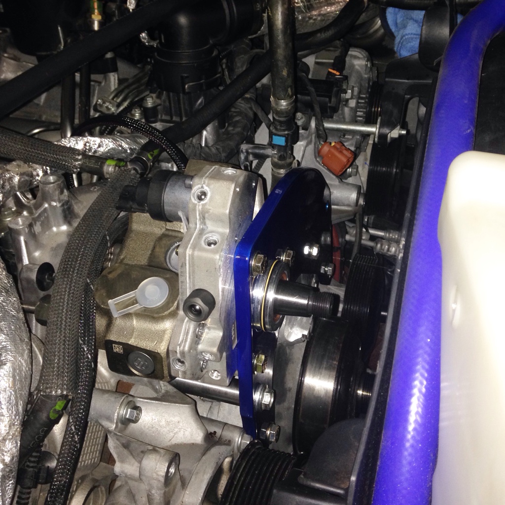

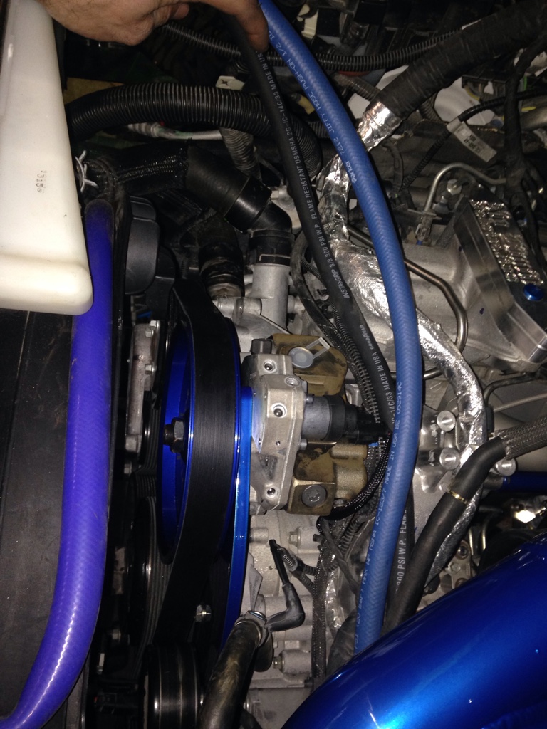

I still have to plumb the cp3 and change/ fill all my fluids and download my tunes I got from tsd and it should be ready to fire!
