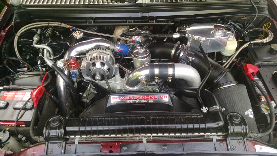

My small build
strokin6L
2,979
Springville NY
Here's what it looks like

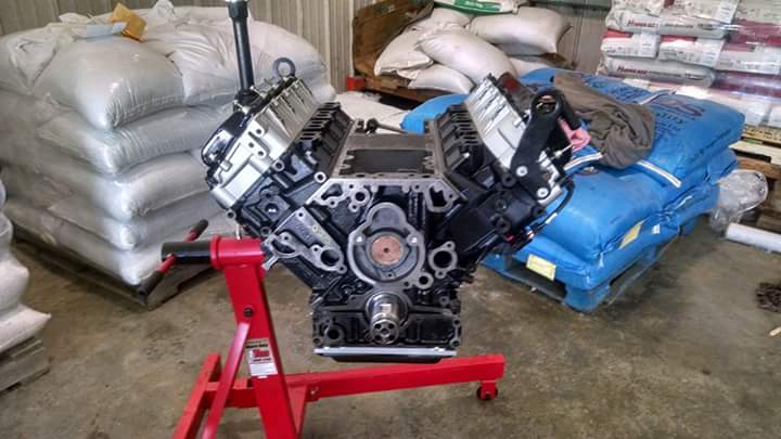

Well, been a very long time since I updated this thread. The truck has been up and running or a few weeks now with about 375 miles on the new motor. I went with an Asheville Engine .020 over short block with RCD billet stage 2 cam.

Here's some pics with the UCF O-ringed heads, with RCD 120# springs and chromoly pushrods, and rocker boxes

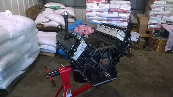

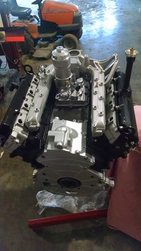

A few more parts added to the motor.

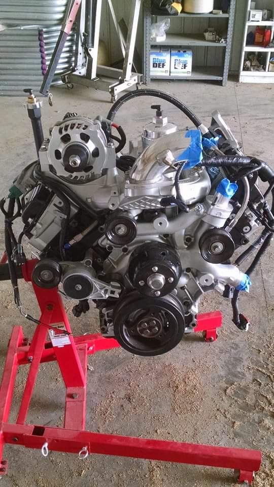

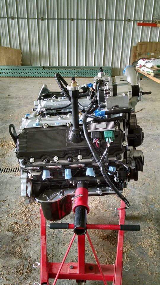

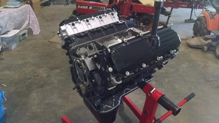

And here is the engine complete with everything bolted on except the turbo, BD manifolds and y-pipe. It got all new sensors and drain plugs, new oil pan, new engine harness and injector harness.

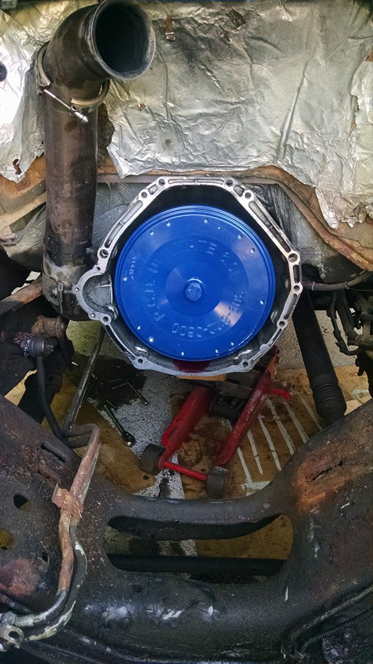

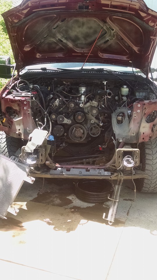

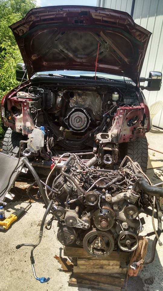

pulled the front clip to yank the old motor. Installed RCD billet converter

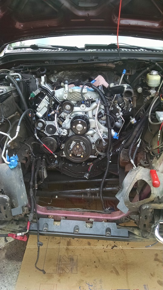

pics of the new motor going in and installed
