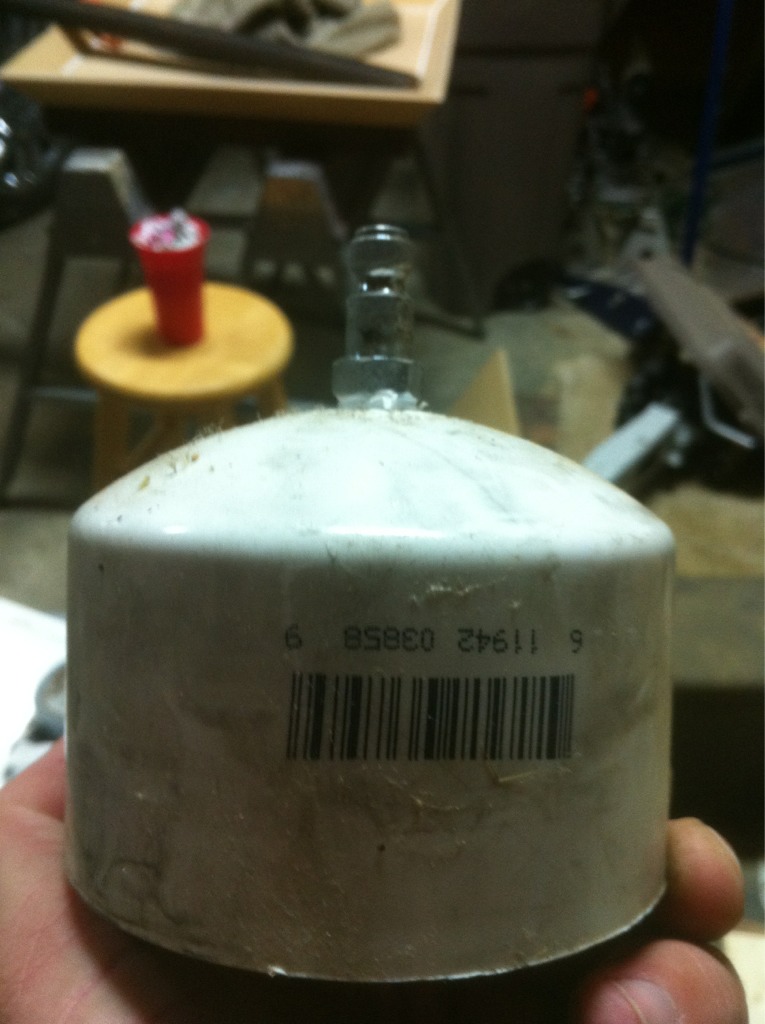

You can make a boost leak tester. Take a PVC end cap that will fit in the intake boot and drill hole in the end and thread in air compressor fitting. You can add sealant to the threads to help get a air tight seal when you thread it on. You want the connector to cut the threads into the pvc as it threads in so have the hole just large enough to get it to thread. Clamp it good and tight into the intake boot. Turn your regulator all the way down or air control valve. Then hook up your air hose. Slowly bring up the pressure up to to say 10 psi. Listen for leaks around all the boots and connections. I then keep taking pressure up checking for leaks till I hit say 20-30psi or intake boots blow off :evil.
Here is a pic I pulled for ya of a detector. They are stupid easy to make:

Be sure to do this directly at the turbo or disconnect and cap you CCV. Bad things happen when you pressurize your crankcase.

My brain must not be working. Where else would/could you connect up a 4"-5" PVC cap to?

If you still have your CCV installed and put the leak test cap into the intake hose that connect to the turbo inlet..you might have issues.

HA you know I did not even think of that. I was sitting here trying as hard as I could to figure out where you connect that damn pressure tester that was some how gonna end up in the crank case. One of the very first things I do with any 7.3 is vent it to atmosphere the way IH intended it to be and also delete the almost always broken ford air boxes. So I never even thought of that. Glad you mentioned it. You are right that could be a real bad day if you pumped 20 psi from a big air compressor in there.:morons:

Keep your head out of the engine bay. Klhanson from back in the old TDS days had a boot blow off at 20 lbs with his head under the hood. It actually broke his eardrum.

Actually pull the filter off the hose going to the turbo. Clamp the tester into that hose and pressurize. You will get some leakage from open valves.
This method will also not test leaks on the hot side of the turbo (up pipes). Look on the firewall for soot, that is the best way to locate up pipe leaks.
