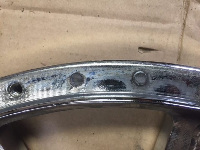

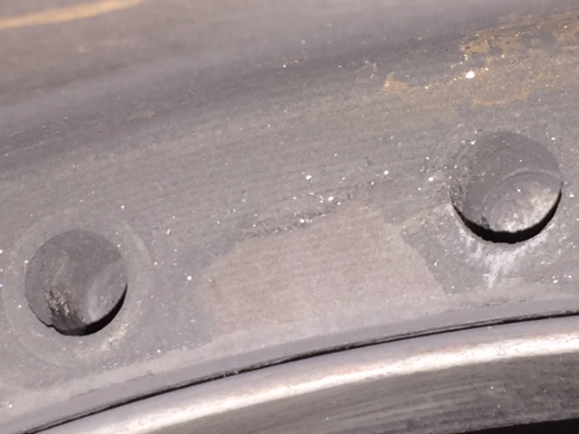

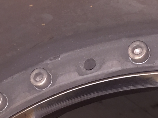

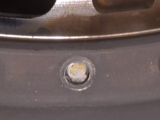

Well since there wasn't any available the factory said their only option was to send it back to them for repair. Being my truck was on the lift at Ford and shipping back and forth to the factory would be 2 weeks I decided to take it apart and repair it. The lips inside looked good, had to remove all the broken bolts and repair the threads. I installed all new hardened bolts and used Loctite on them. The factory bolts were not hardened. This wheel was only 6months old and had been running on the front for 6K miles and just rotated to the rear, so I know overload was not a problem. Now I'm worried about the other 3.
