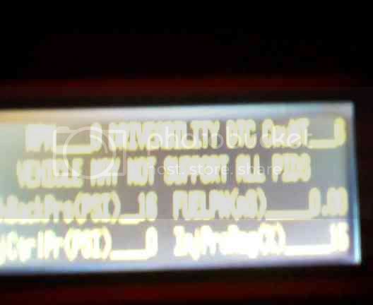

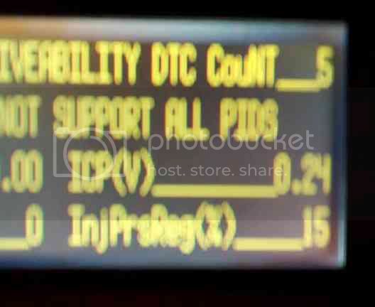

Ok I know its been a while but we got a SnapOn scanner and took some bids. First is with engine cooled off after about 5hrs.
Second video shows icon and ips on a full throttle run. As y'all can see it ain't right. I peak out just over 1856 and 86 percent. Not good at all.
Finally trying to hot start. You can see it barely gets to 400psi.

Got the stock 17 degree on and its acting like a normal pickup again. It starts just fine considering its 106 here right now. Im interested to see what was wrong with the pump. I'll update when I know something.

The srp1 was the problem. I had no starting issues before install so we tried lots of trouble shooting and finally replaced the pump so we could send it in for diagnosis and rebuild. It starts fine now and the pressure is much better.
