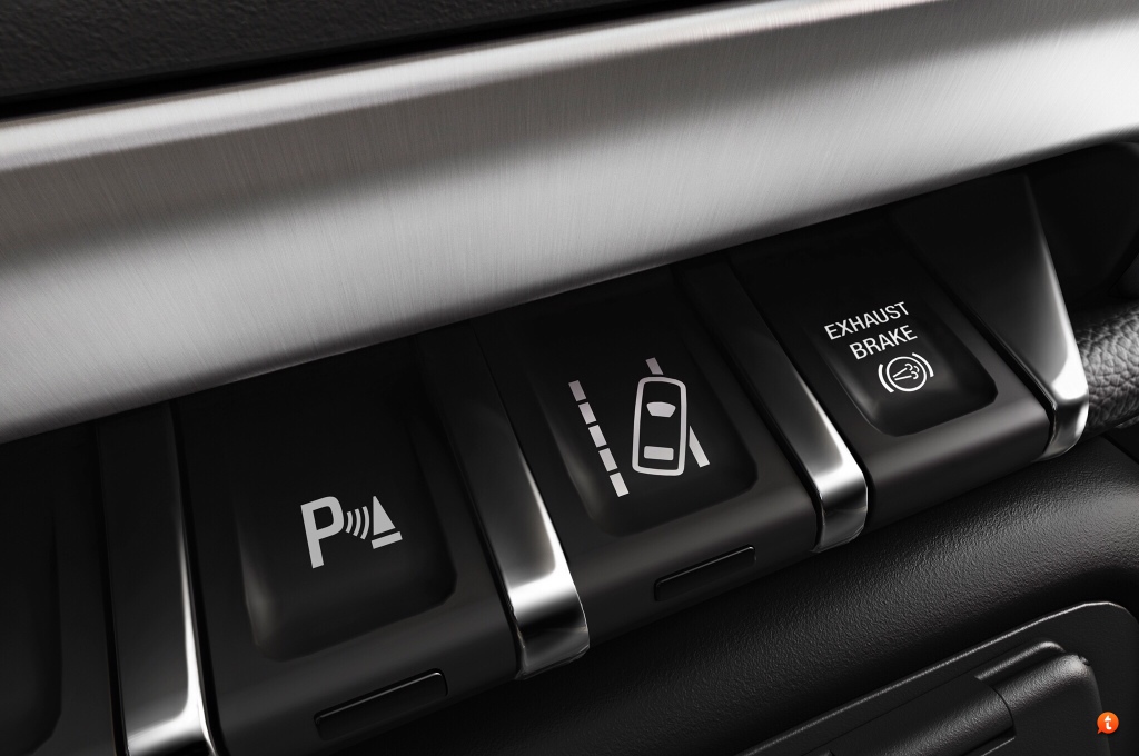

It's for an exhaust brake..the 2015 duramax's at my work have them too.
TyCorr
Jun 23, 2011
15,461
The dmax has had it since 11. Dodge way before that. I'm not sure when Ford started. It works really great on my duramax. Exhaust brake and tow/haul it stops a load quick.
