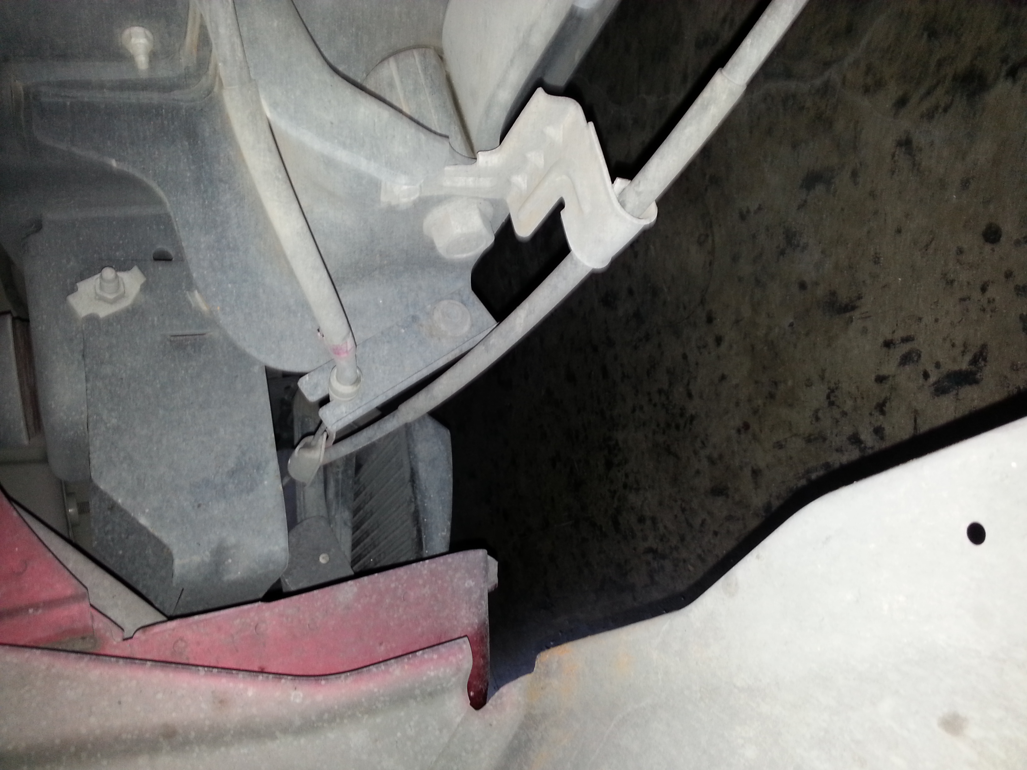

Boys I am about half way done with the install. Everything is going good except for the damn parking brake bracket I knew I was going to have trouble with. I have the cable pulled back and clamped so it has slack but I cannot figure out where this bracket mounts? I dont even see an old bracket? Maybe the 2016s are dif I doubt it but I would reallllllly appreciate it someone took the time to snap and post a pic of their parking brake mount. You would be doing me a big favor! Thanks!

My truck is a 2013, but I would imagine they are the same.
