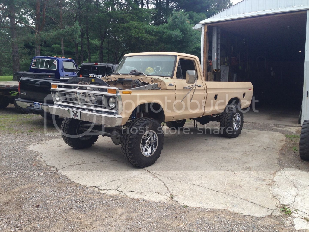

Well ive been ignoring the superduty lately and have been spending time on this.

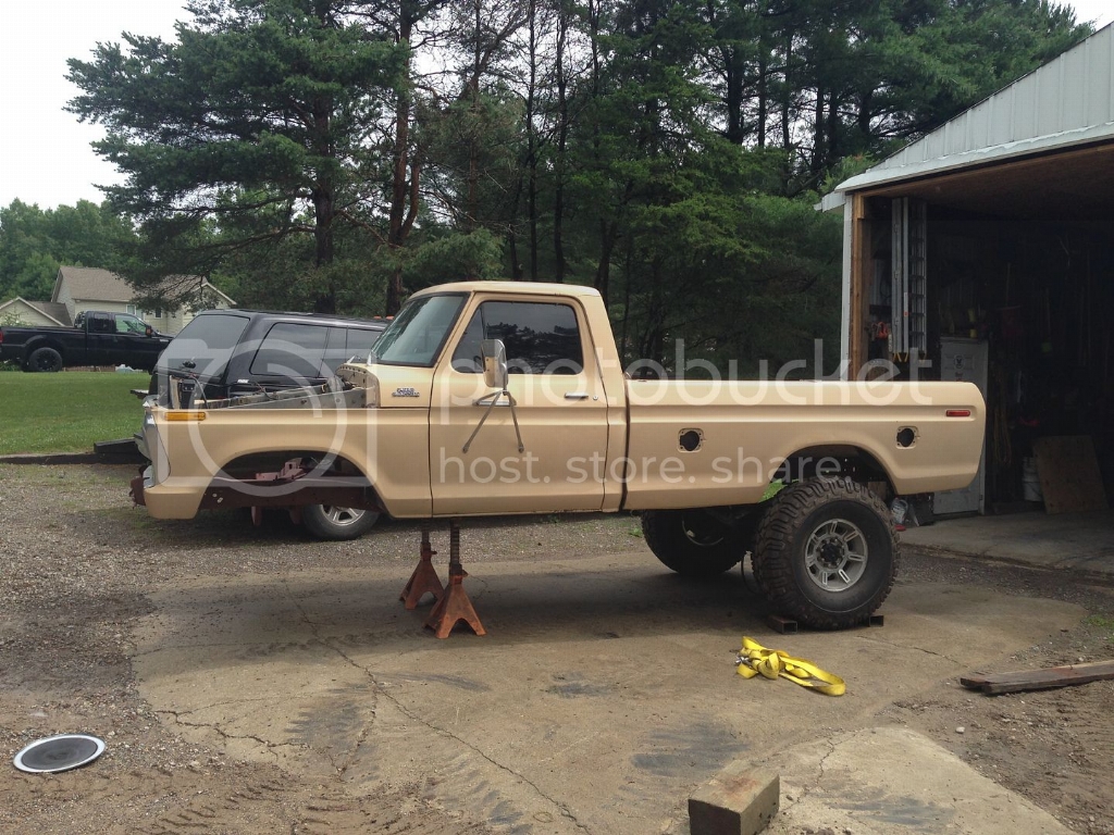

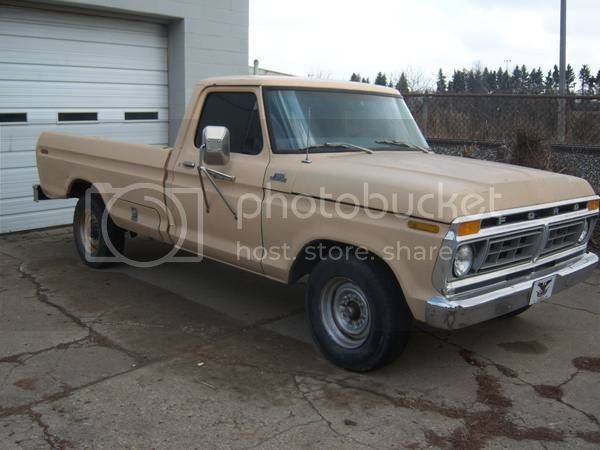

Well I picked up a 77 F250 last weekend. It's 2wd 400/c6, the 400 locked up while unloading so that'll be scrapped.

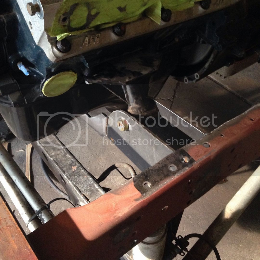

The plan is to pull the drivetrain out of my ranger, 351 4r70w 203/205 60/14b and swap it into this. The front will be 3 linked with 14x2.0 Kings. Rear will be 5.5" chevy 63's.
Here's some pics of the truck.

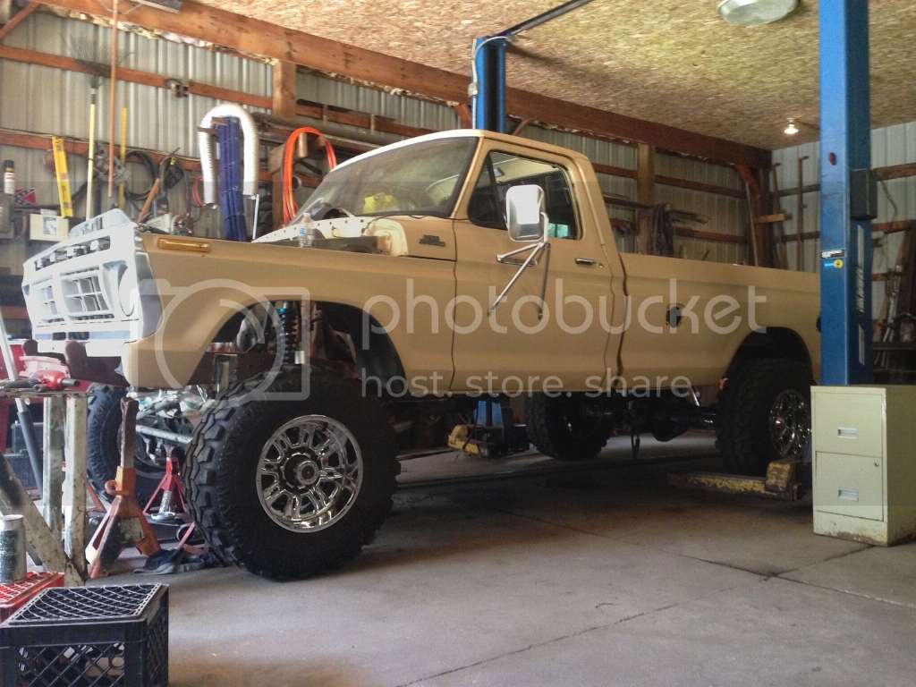

Got the truck stripped down to the frame, wow this thing is clean!!!!

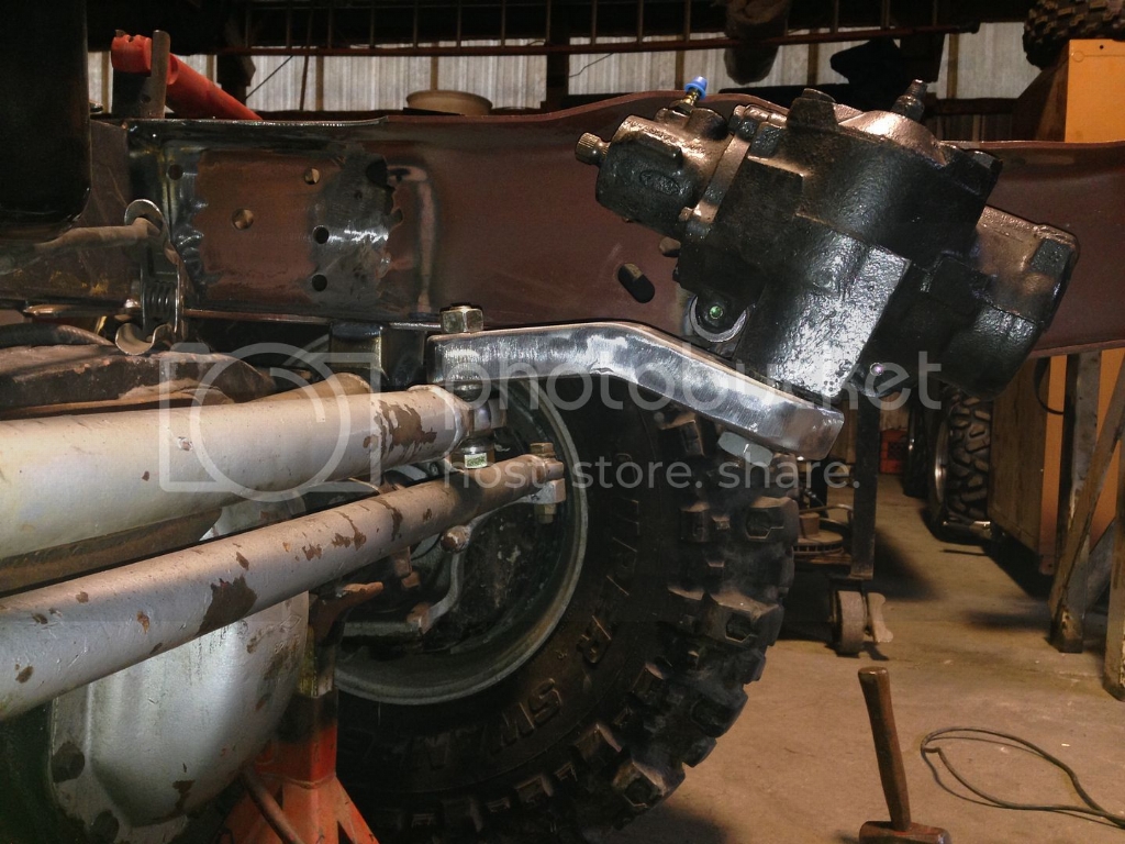

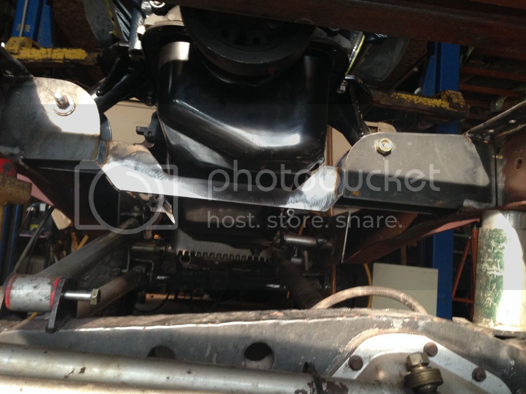

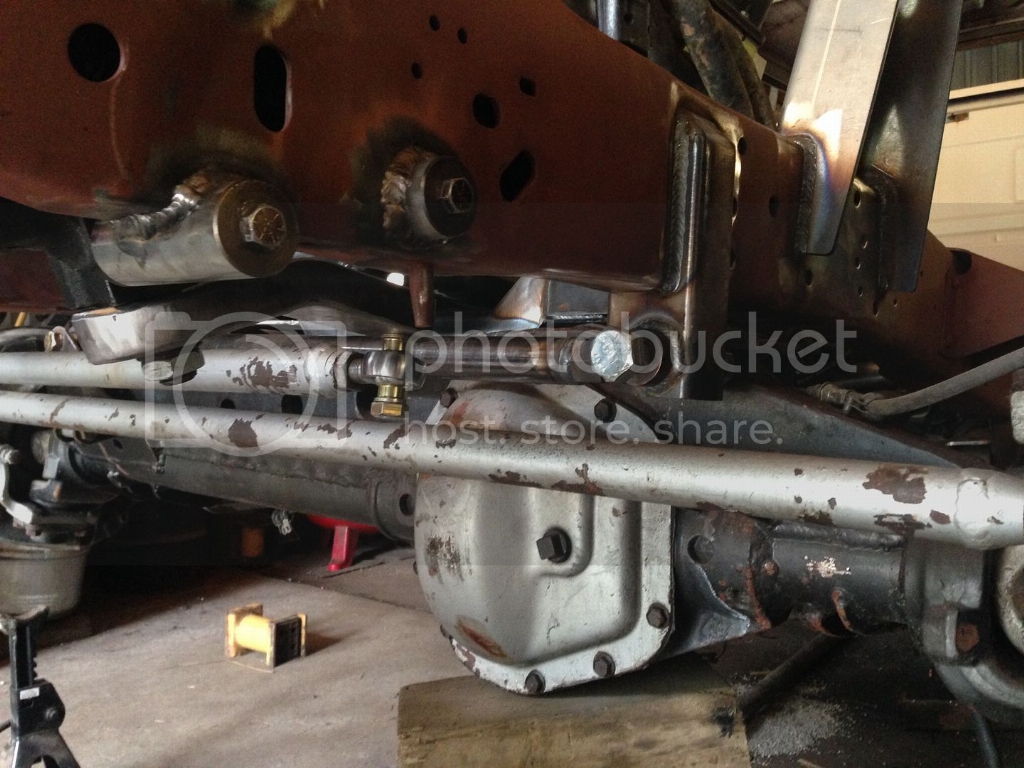

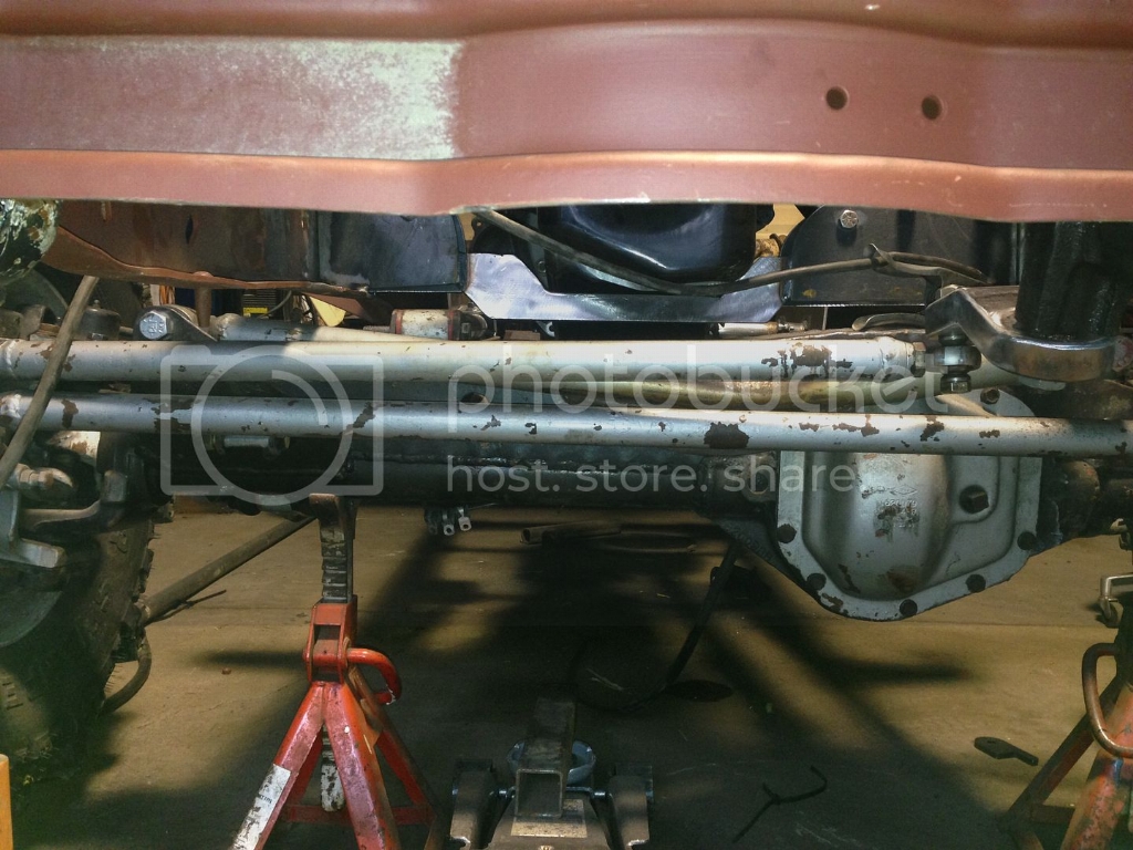

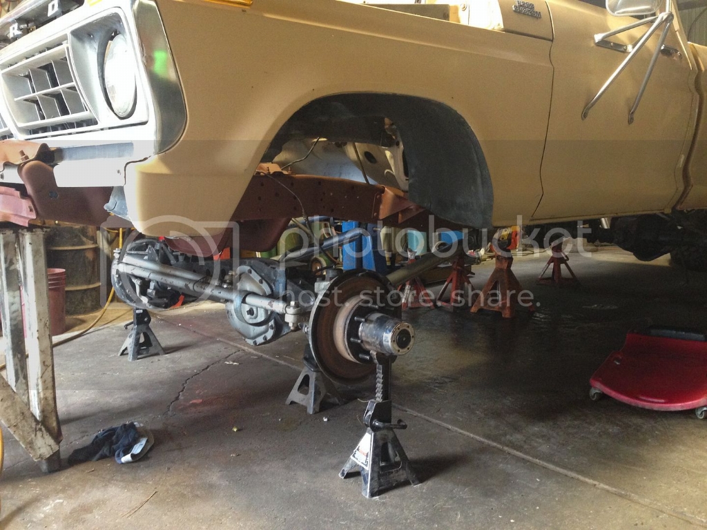

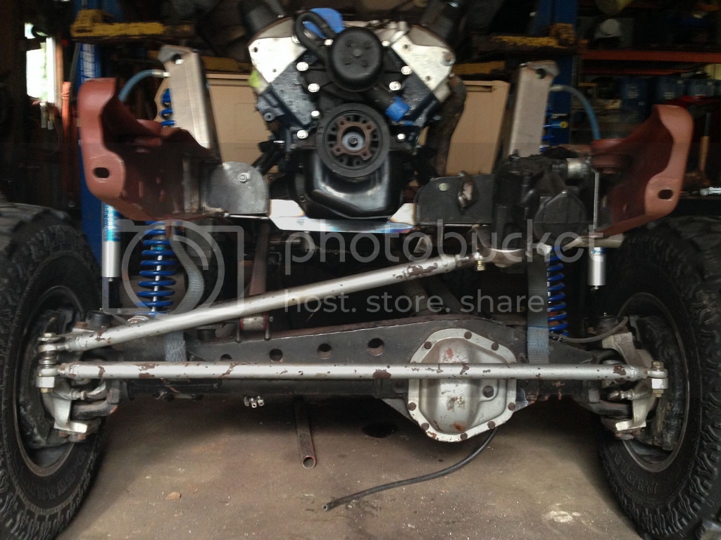

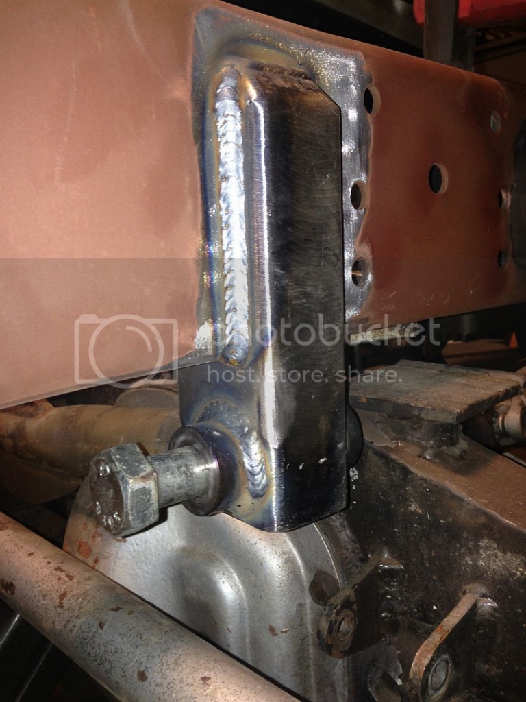

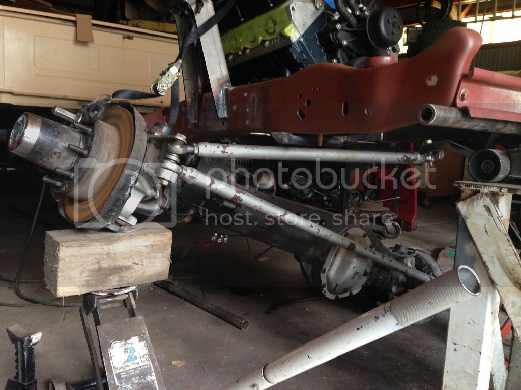

Got the rear end under the truck this weekend and started the front.
What do you guys think of the numbers?
