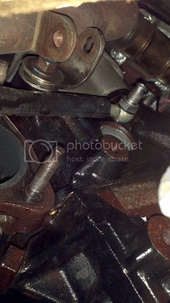

I rigged this up.
We have a fuel cart. I plumbed in the line and flush 5 gallons through the return system. I removed the rear plugs and put in fitting to drain.
