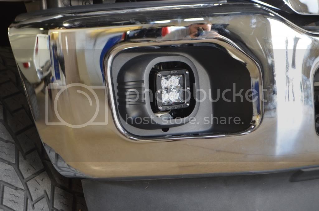

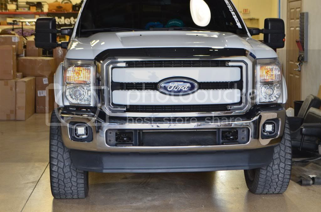

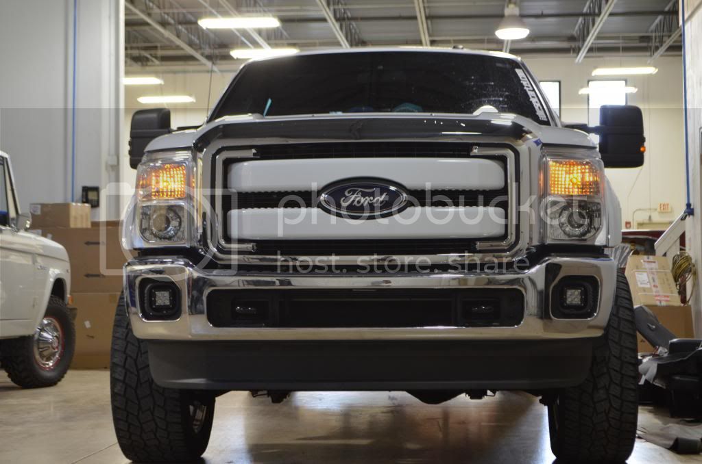

Here are a couple more photos of our latest install.
Who did the HID retrofit in this truck and what shroud was used?

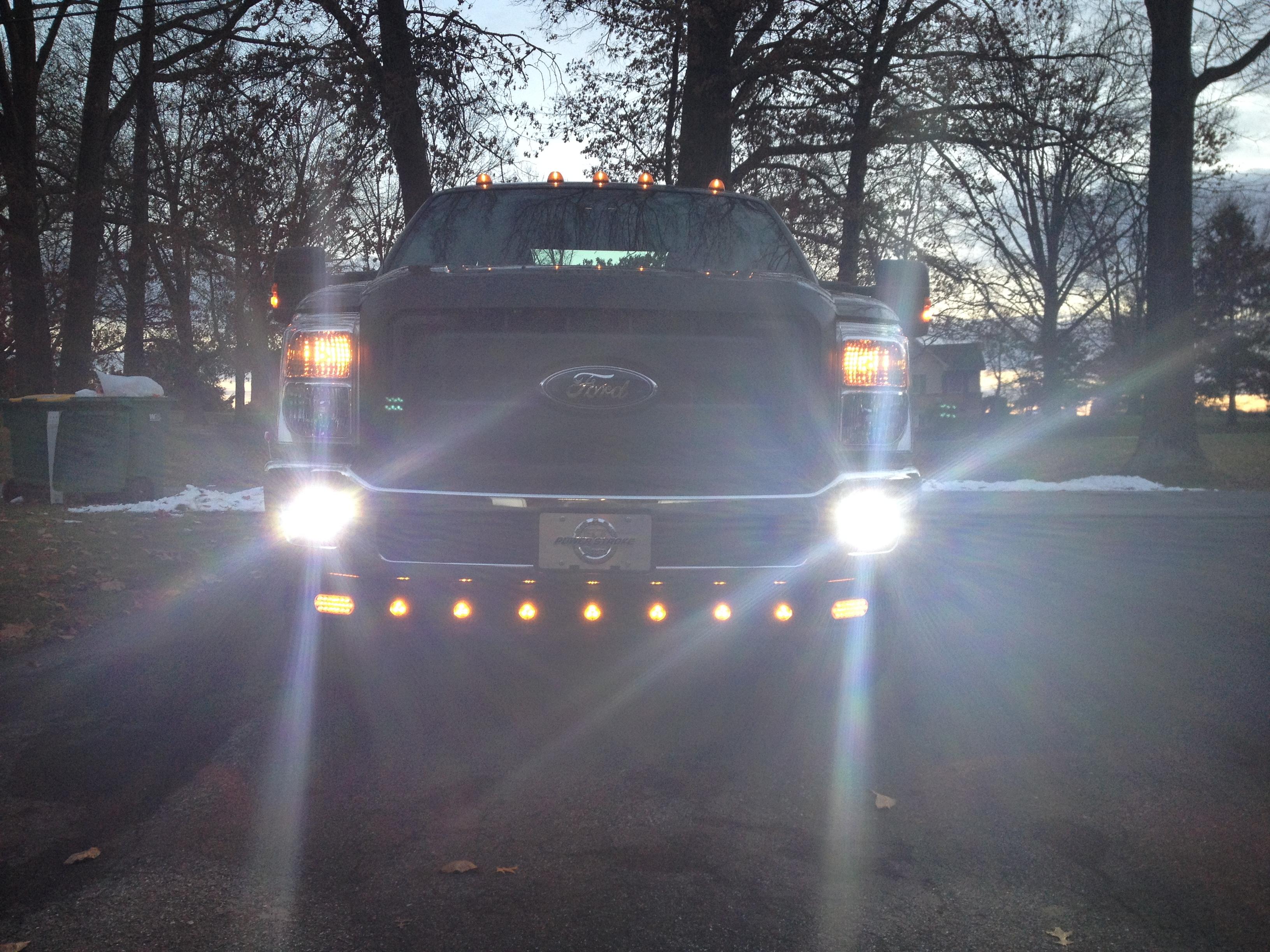

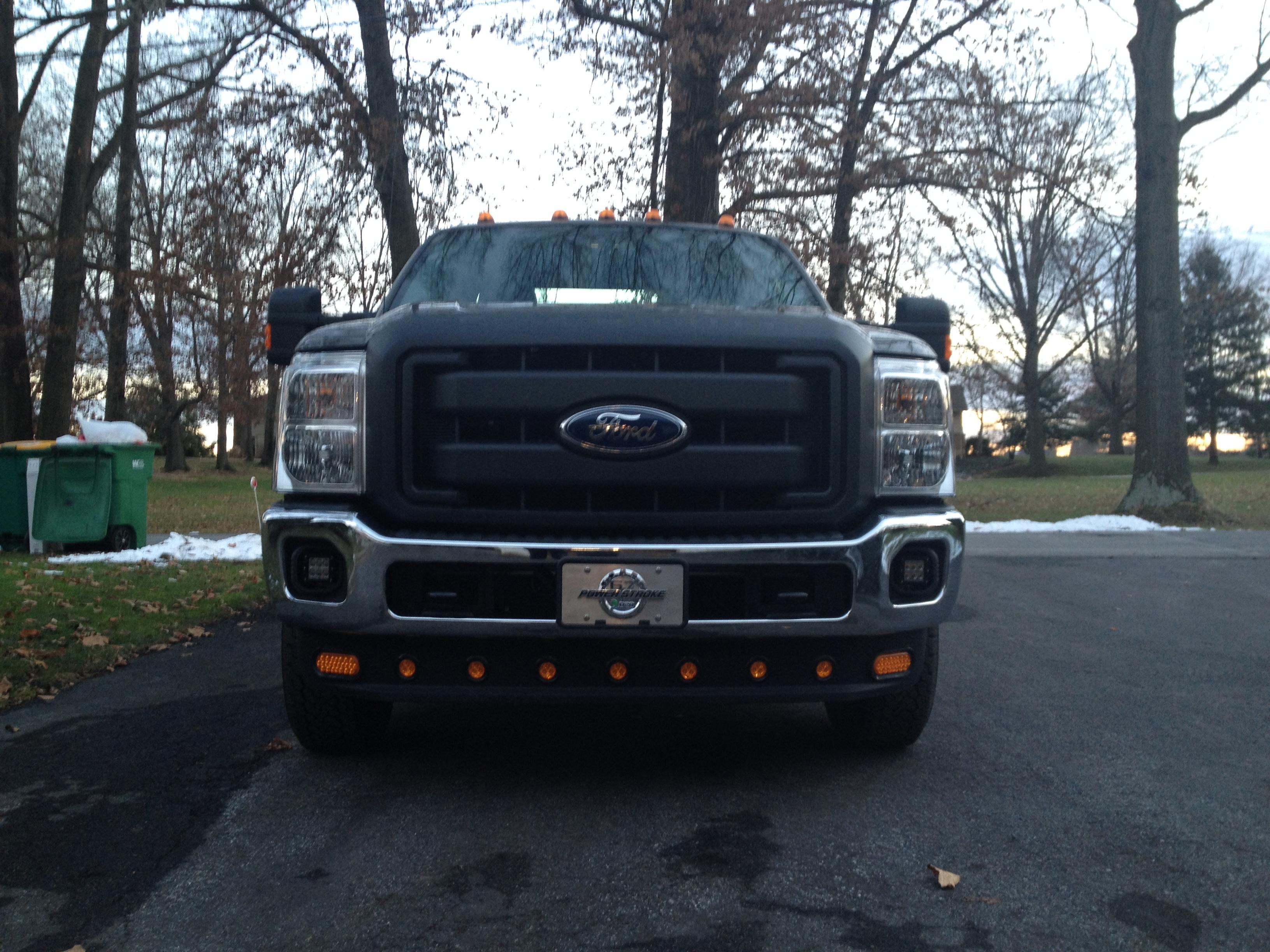

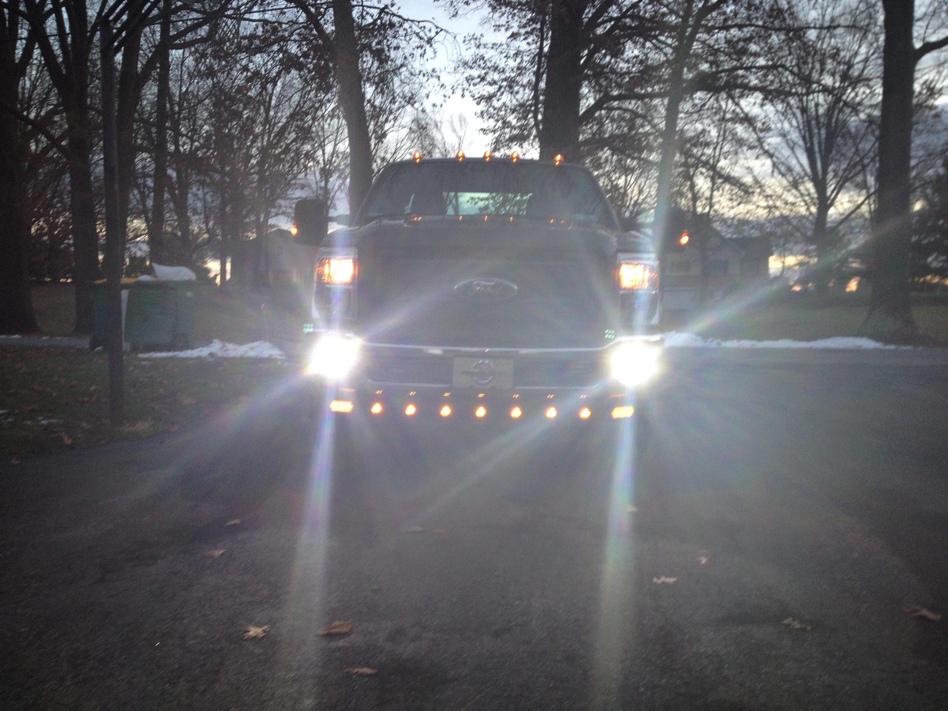

Here's my D2's. It was getting dark and kind of hard to take a picture but, they are so stinking bright :D. It took me about an hour as well. I got some help when it came to putting the bumper back on because it was hard to get the bolts started by myself.
It was done by Retro Shop. I believe they are Gatling shrouds.

Looks great! D2 are ridiculous bright.

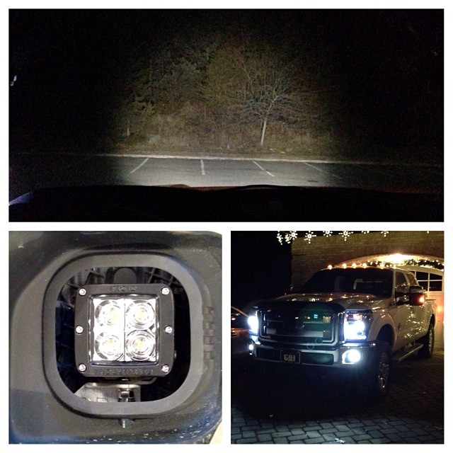

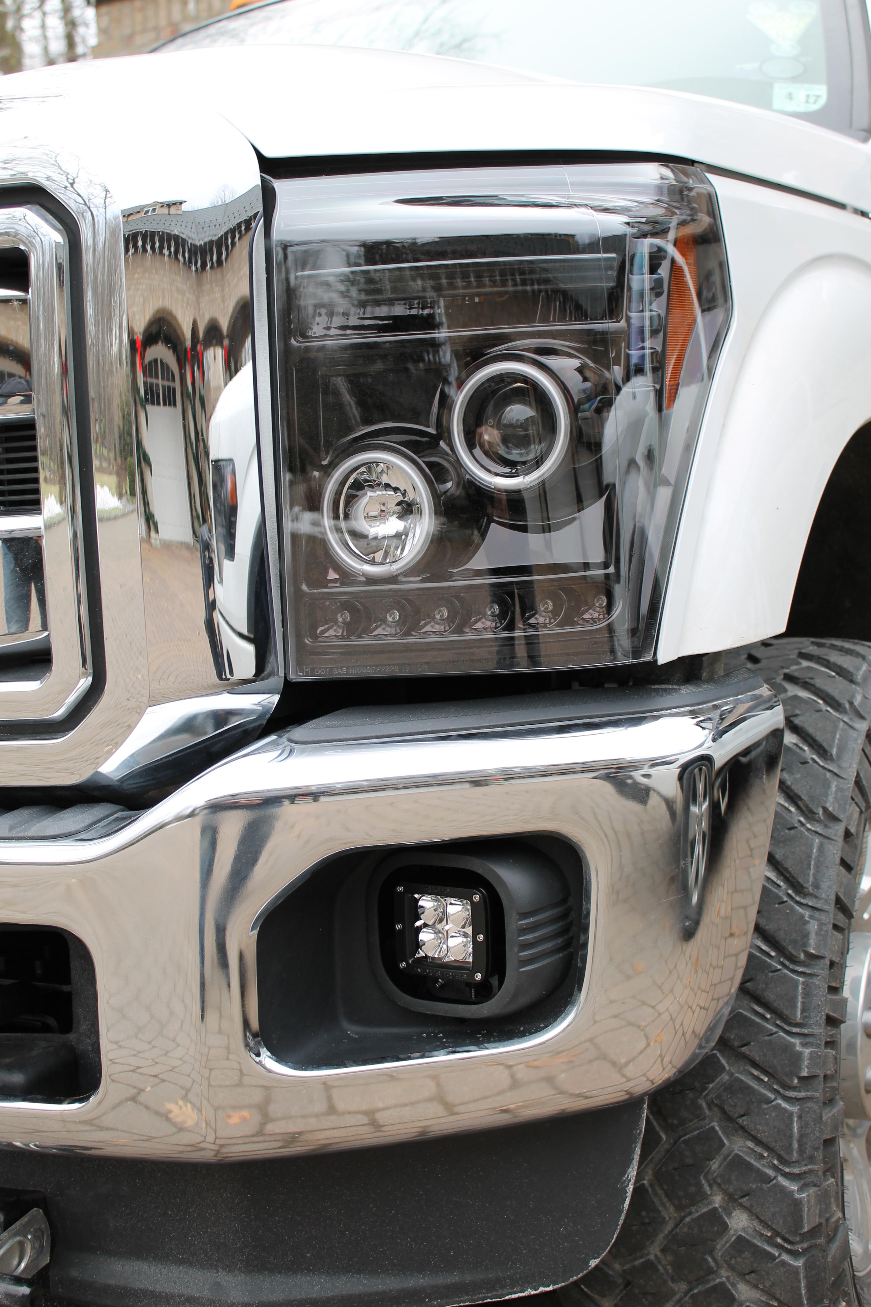

Got mine today and installed them a little while ago. Wasn't hard... Only thing is there's no way to adjust them once they're in the housings so make sure they are where you want them!! If you want to do this without removing the bumper, it is very easy. Just remove the 2 bumper side brackets. Remove the one bolt on the bottom of the fog light plate, and just loosen the top 2 fog light plate bolts, the plate is slotted and will slide right out of the bolts. Quick, simple, and you don't need to remove the bumper. Love this kit and the lights.

What HID's are those?

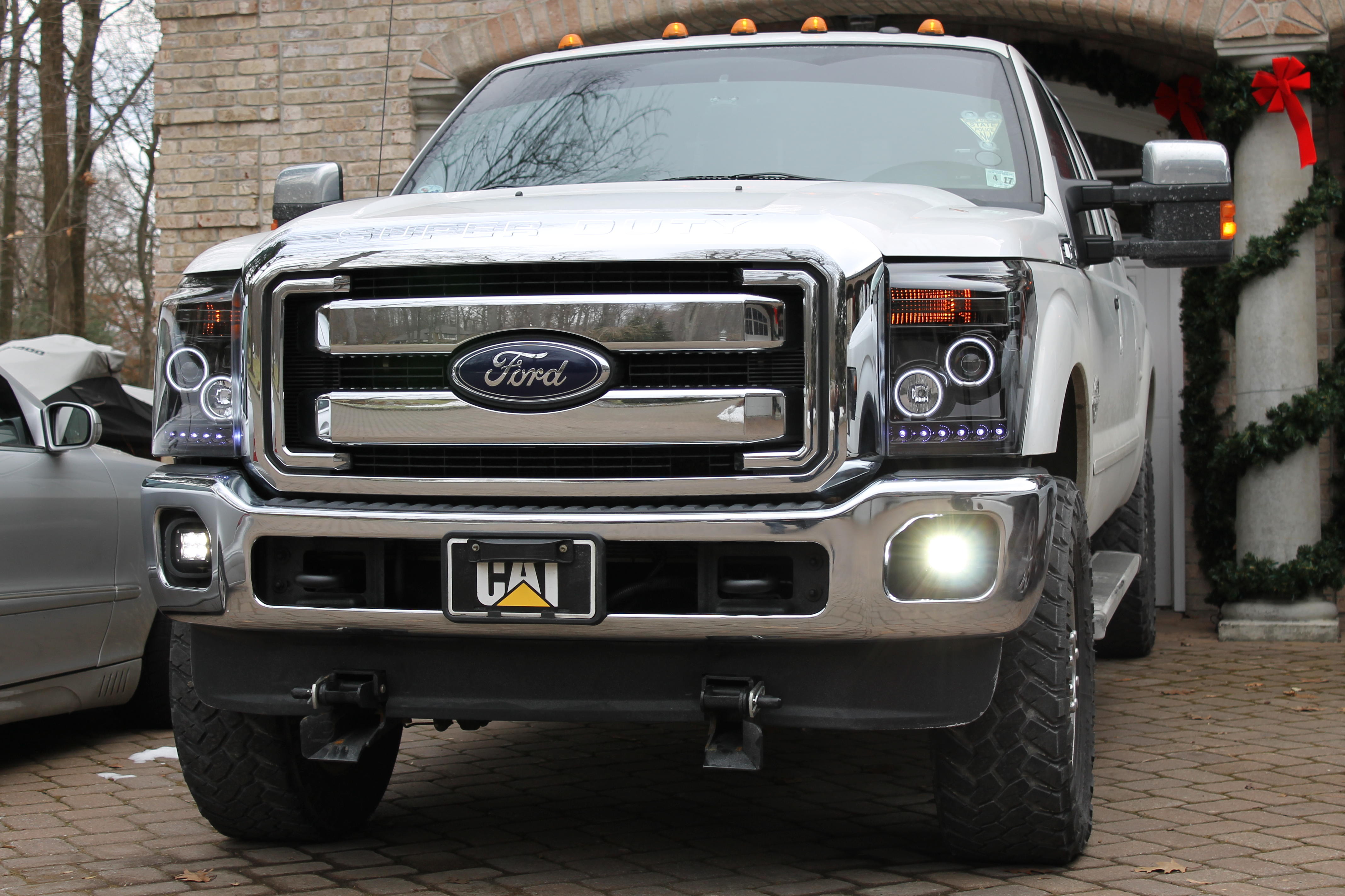

Couple more pics
