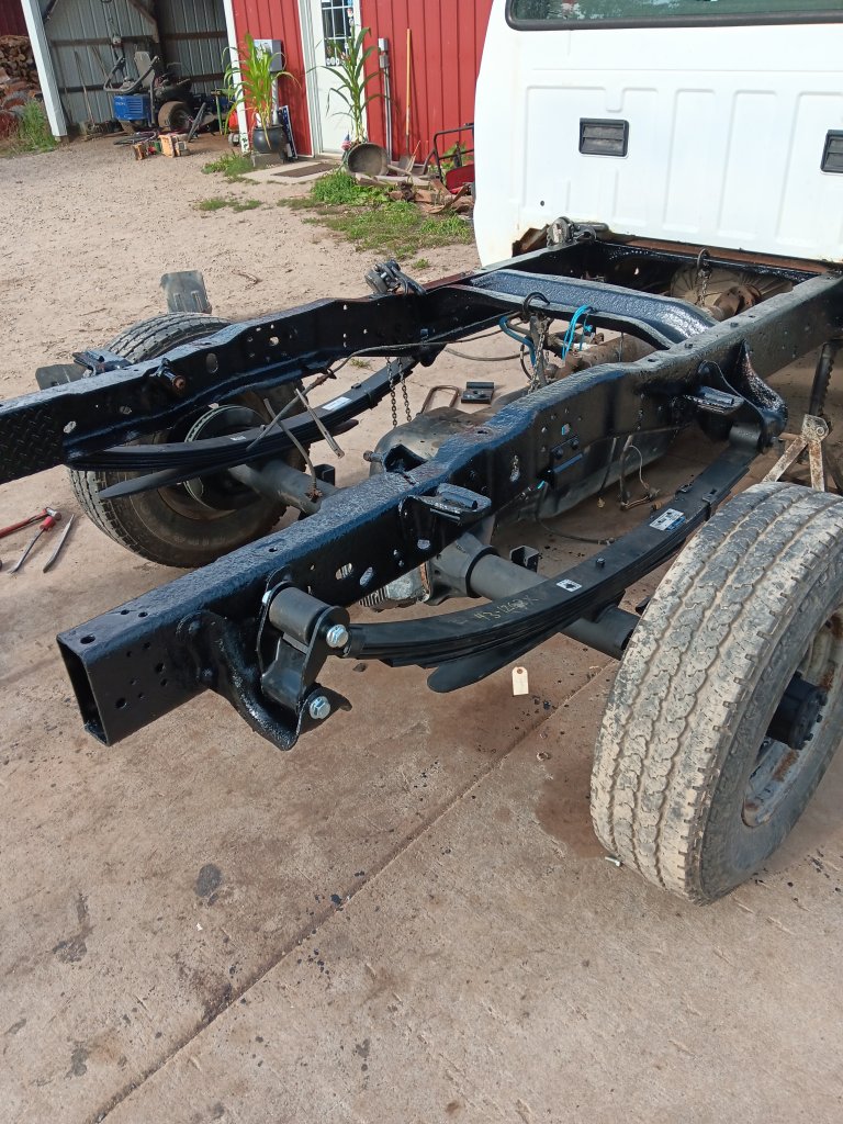

01 f350, manual 4x4. 410s, just over 220 on the clock. I've put a few thousand miles on it as a srw truck, and I hate towing with it! Dual wheels are so much nicer.
Since I've got two trucks that worked great set at 450 hp, with all the appropriate parts, and falling apart, why not, right?
So my son and I started that project this weekend. He wants to build his own truck, and dad has the parts, so I've got some labor to help me do this, lol. Anyway, we stripped the back half, cleaned a buttload of michigan specialty, and painted the frame. New springs, rebuild dana 80 set in place, and a small list for order tomorrow.
The old girl is getting a set of 350 springs, with an extra leaf and overloads. New brake lines while the tank is down, and a dual pump fuel system. The axle is 410s with an eaton trutrac.
Gonna get a "custom" back end for the bumper hitch, also, since that was a weak point on the 99-03s.
