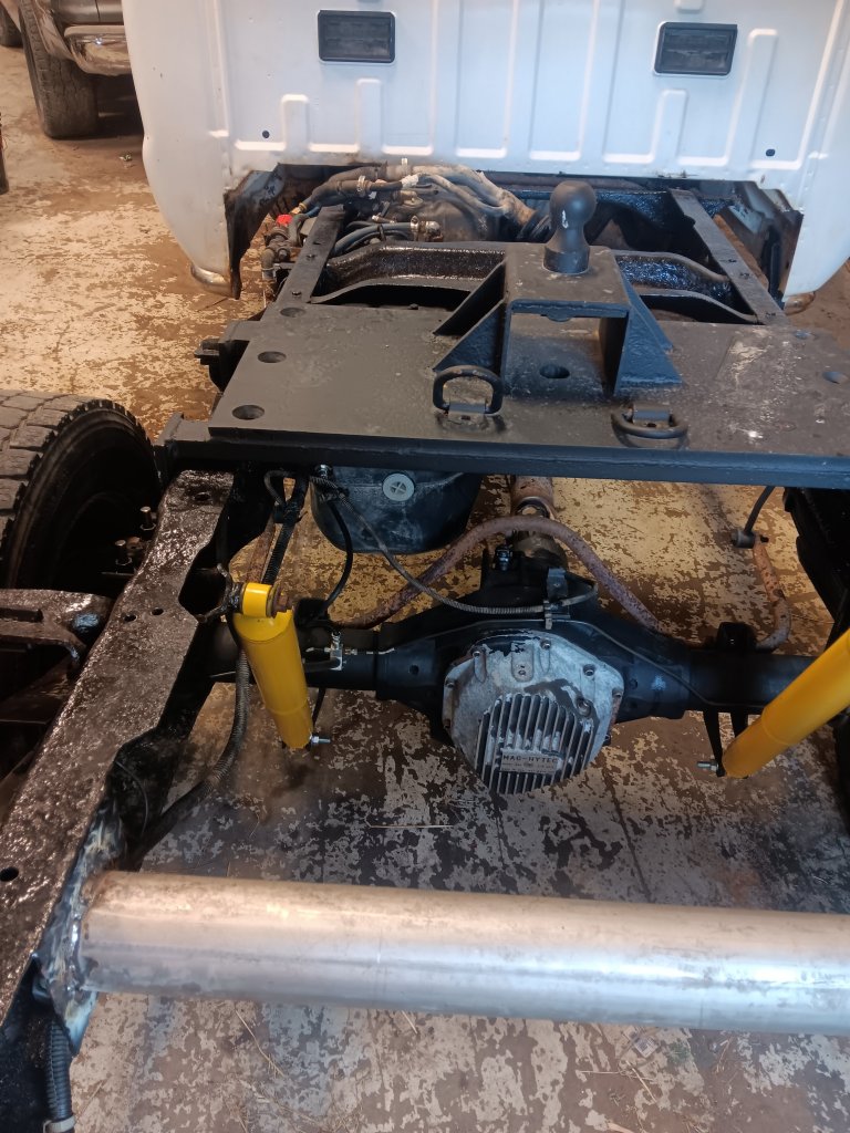

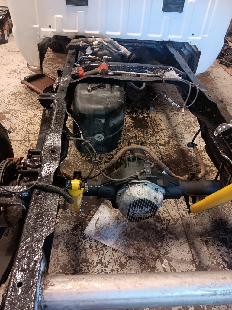

Couple of progress pics

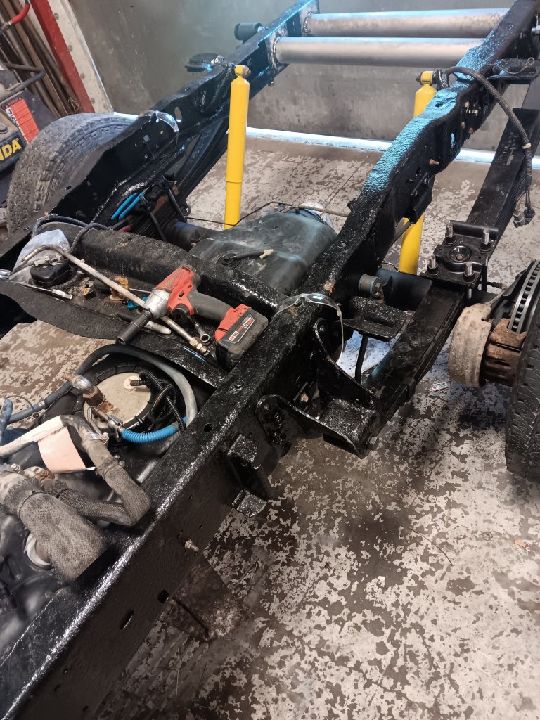

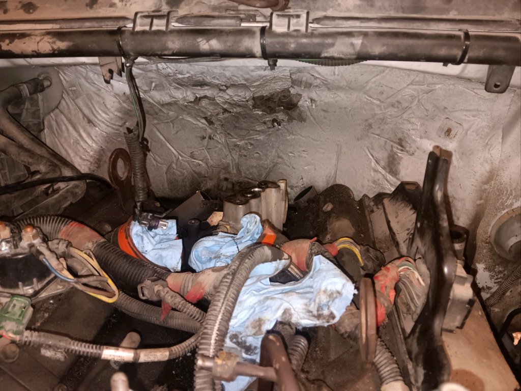

Slow progress, in between work. Got the tank mods done, and a stock pump and filters on the rail, sorry no pics of that.

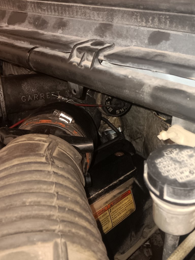

Working on the rr and turbo r and r. Pretty sure nothing on top has ever been touched.

I didn't take any pics, but the uppipes and 38r are both back in their happy place. No pics, but I did run it down the road tonight. Sorting out little fuel line leaks, and that kind of dumbsh!t, but it ran well enough. Got it hot enough to cook the paint on the pipes, lol.
I did have a brake line split, it was one of the stock originals, so glad we caught that before I headed out with a trailer!
I think I'll get a few miles on this setup , at least till I can get the fun stuff together. Try and get a couple pics up tomorrow.

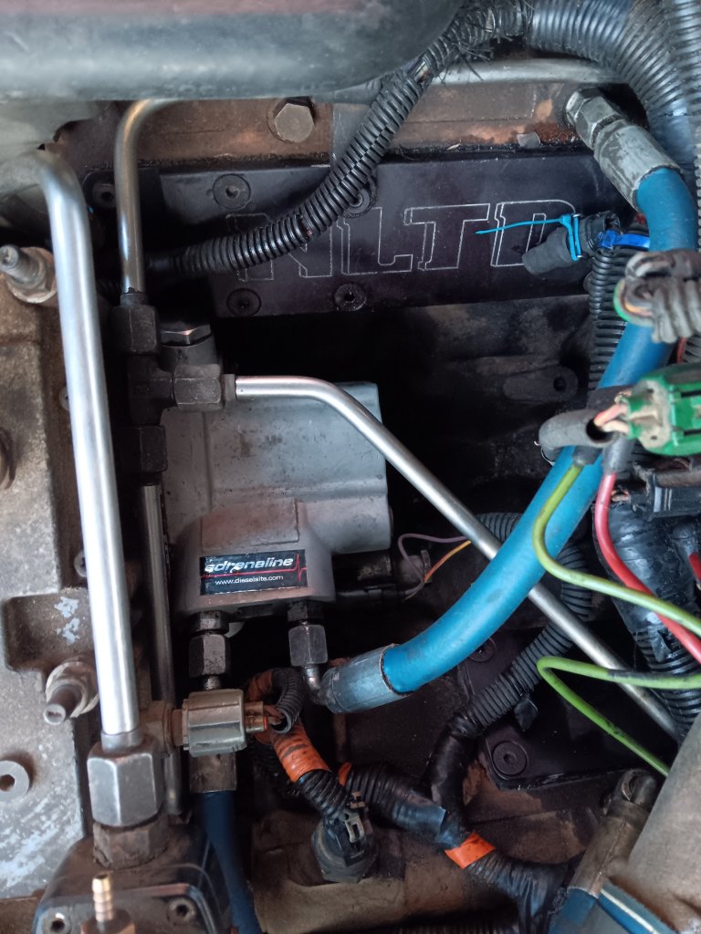

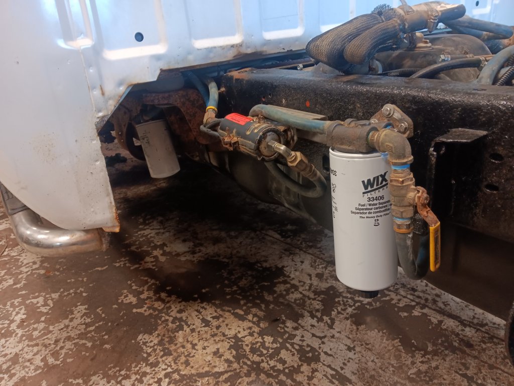

Couple pics, the fuel is pretty basic, but it's been working for several hundred thousand miles across 4 trucks. I'm not sure the hitch will be there when I get done, but I've gotta haul a trailer this week, lol.

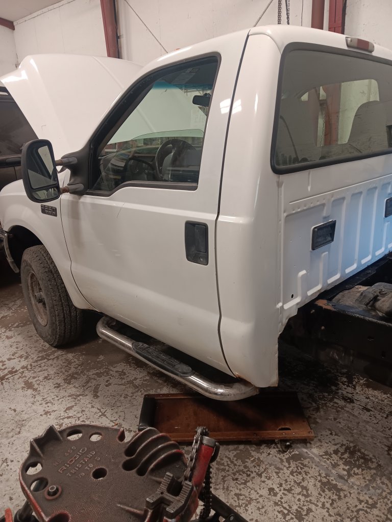

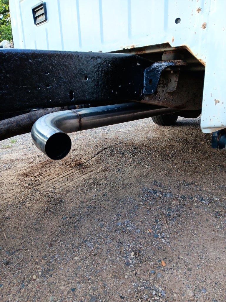

Got it on the road with a half assed twilight setup, good enough till I get time to build an actual bed. No I didn't take any pics of that!
I've put 20-30 miles on the truck, just to shake out any bugs. Gotta change the o rings on the hpop lines at the heads, I guess 2 or 3 times in and out is enough, and they are seeping now. Exhaust is touching the cross member somewhere, makes a rattle occasionally, and I've gotta change the breaking oil in the rear axle. Other than that, it's there. Time to hook up a trailer. Yes it's loud.
