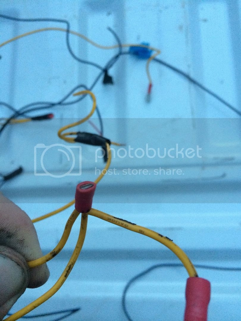

Welp since it's 60 degrees in New England in December!!??...figured I would enjoy the day outside and clean up some wiring in the new rig. There were a bunch of dead switches and a bird nest of wiring hanging below the dash. Half assed wiring is a pet peeve of mine. Anyway by the time I was done tracing out and removing all wiring that was serving no purpose - I ended up with quite the pile of crap! Some people should just not wire themselves what a mess!!:doh:

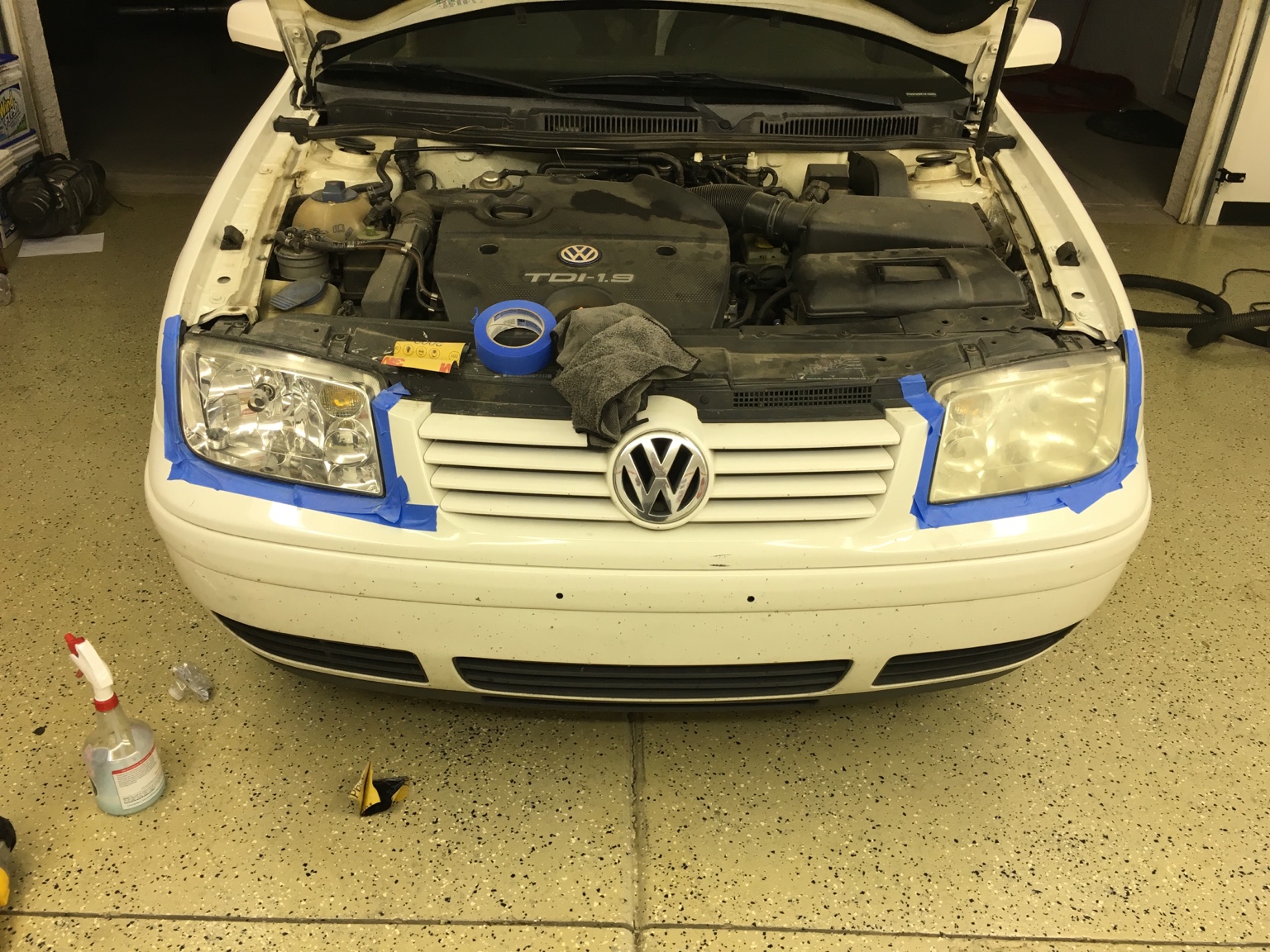

I've been using a cheap solution with great success.
Outdoor clear UV resistant urethane( for wood)
And mineral spirits
50/50 mix. Use a blue paper towel folded in a small square, wipe it on and let dry.
I use compound with a buffer if there little haze.
It's they're bad I use 1000grit then 2000. Then compound and polish. Then finish it up with the 50/50 mix posted above
This car is going on 3 months still like new

Jomax - is that first picture a pic of stock clouded headlight vs the eagle eyes - or is that what happens to the eagle eyes if you don't treat them?
For the VW? The first pic is one head light polished and sealed. And the other was still clouded, didn't start on it yet. I use it as a before and after.
