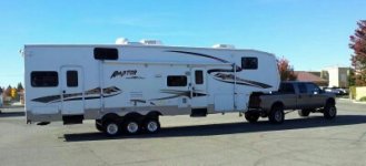

I've got a 38r, T500, DP Tuner, Alradco intercooler and aluminum radiator, exhaust and few other things but still on stock injectors. Truck tows great. I may do injectors down the road . I tow a little heavier than you're planning and the intercooler made a night and day differnece when pulling grades but my truck sees more than 19psi.
