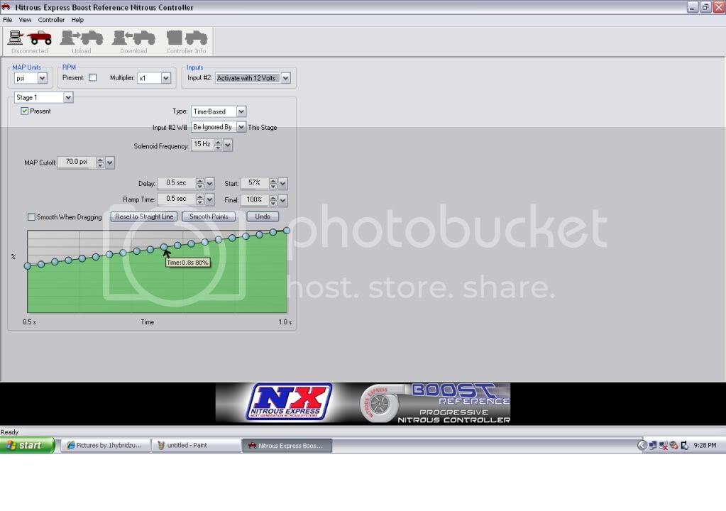

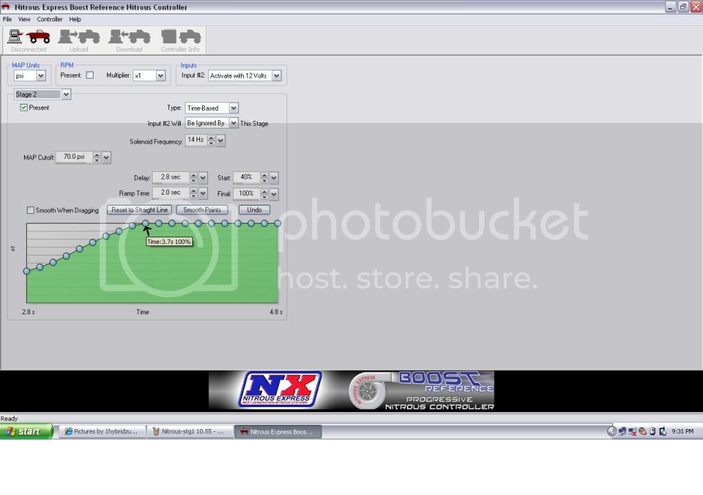

I have the Nitrous Express controller and love it, I use the "time based" for the drag strip and "boost based" on the dyno. Just mash the throttle and let the controller do all the work....no buttons to push.

Why use two stages that look like there characteristics are very similar?? Two different sized nozzles?

That's what I do. Nice and simple. I've been using TS's system. I just set the first jet as high as I can with still getting traction and the second jet to clean up the rest of the fuel.
